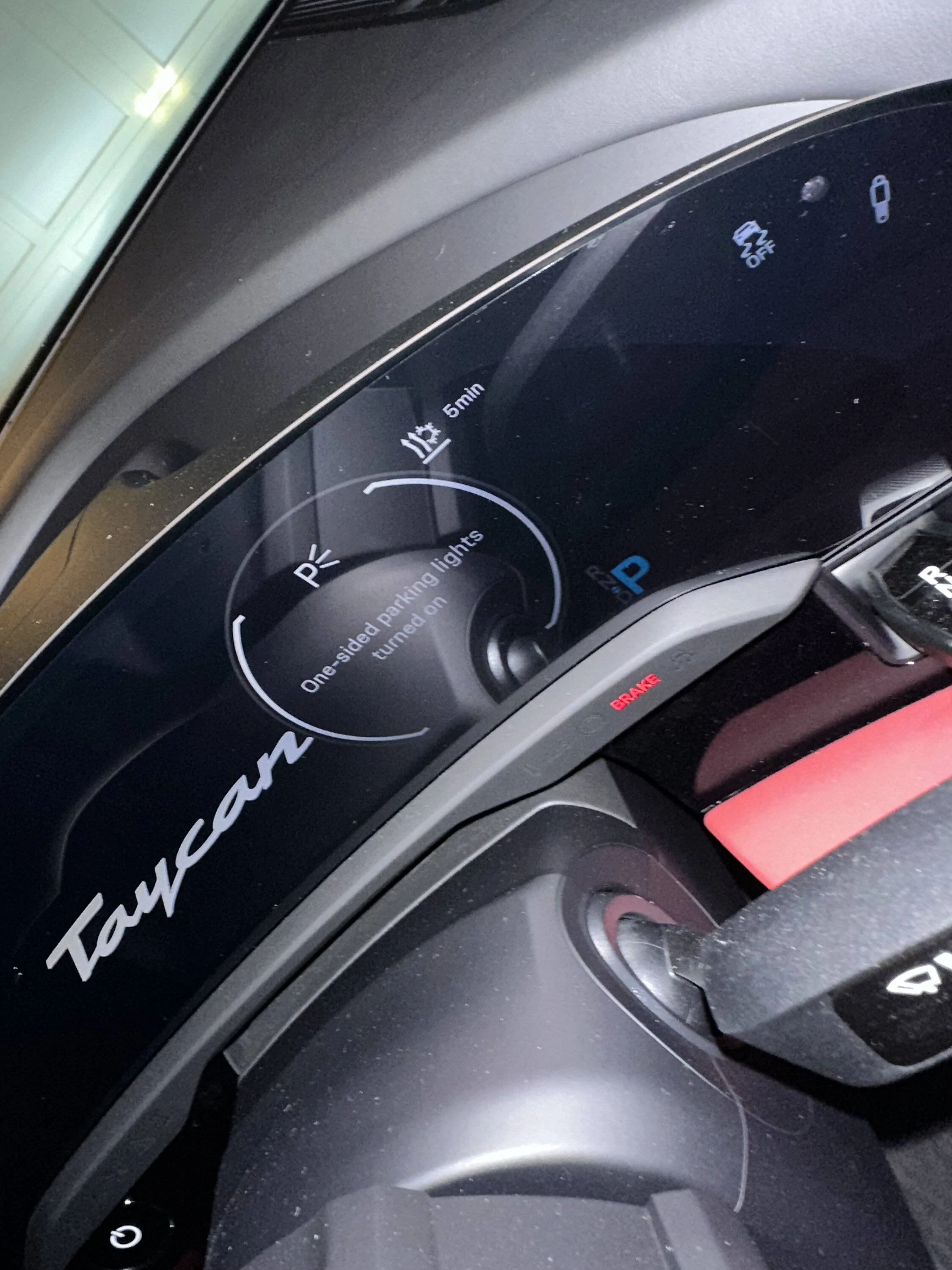

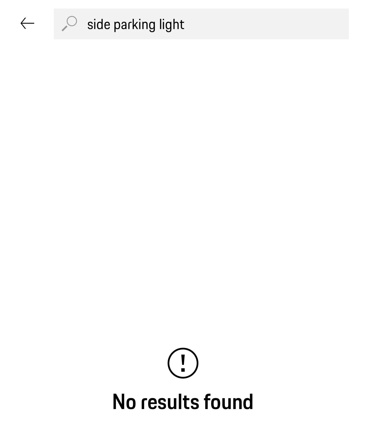

Yeah I don’t find it in the manual either.
But the way to activate it. When you turn off your car. Just turn your signal left and the “one sided parking light” message will activate. Walk away from your car and eventually the left side front led lights and left side rear light will light up.

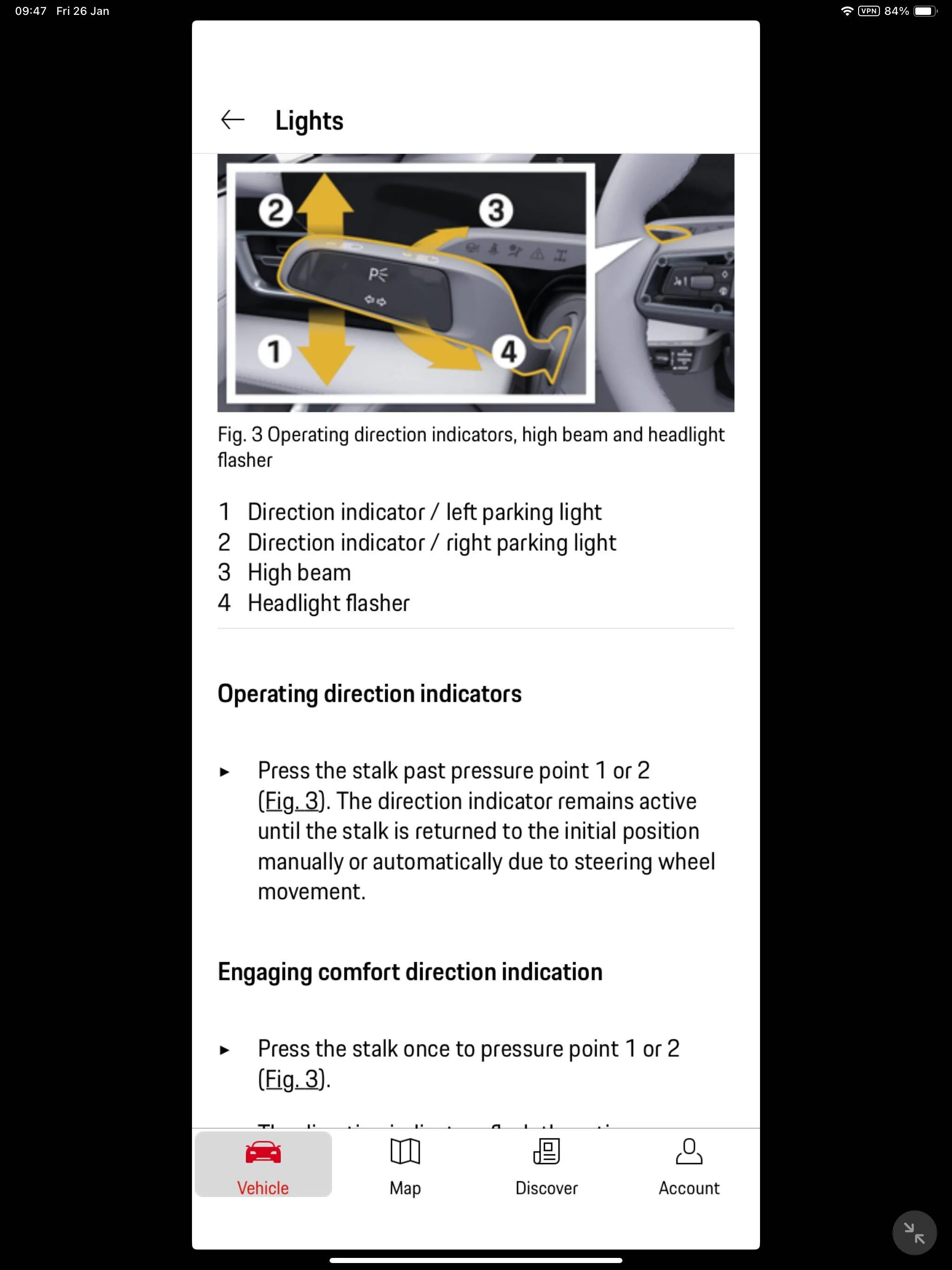

UK cars have had this feature for literally decades - common to all / lots of manufacturers.
Also documented in the manual.
In some cases leaving the LHS or RHS indicator stalk in the on position will activate.

OP referred to the switching on of just one side of the parking lights via the indicator stalk. And as you say that has been a feature in Europe for decades anyway. Not the normal all around parking lights etc.

It is in the manual ,but not clearly marked.
Thx all for validating. And great find on the manual. At first thought, I was starting to believe it was some remnant feature no longer recognized/needed. Like a human tailbone.
