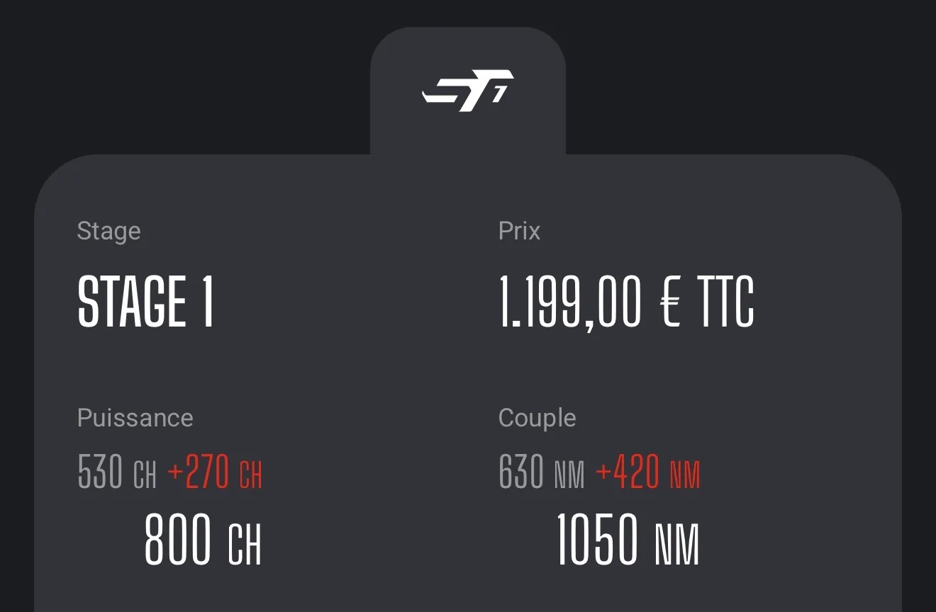

Knowing that it’s impossible to exceed the stock 640 Nm without the Prj fix who add only 20Nm, I don’t understand how Shiftech can claim to produce that much torque…
This is really in the wrong thread, as it's not J1.2, and they can't flash J1.2
For J1.1 there was a protocol released for cars up to 06.2023 today from a public flashtool (the protocol was private before), so you should see a lot of offers now online.
Of course none of them have done any R&D. The launch patch is not possible and cloning ASG is not possible (because this tool allows to only write the calibration area, not the code), so the cars will be flagged at the dealer and there will not be any more torque on most cars.
However, the approach from most of these companies is to claim they can do everything immediately, and market fake numbers, even though they have never done anything before, and then experiment on the customer car.
The smarter ones will copy our numbers from the website, the more silly ones will just claim random numbers, as you see here :)
TL;DR:
It's a scam.
