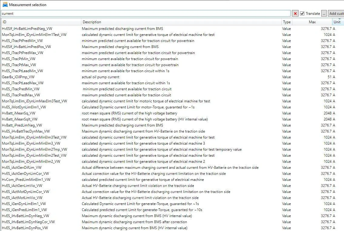

@prj curious now what they call amps/current in their naming convention.
Do you have an enthusiasts version/license of your logging tool avail to read those RAM values? I am not a professional or competitor, only highly interested in that stuff for many years for my own cars
The license for the logger is not a problem, it's only 100 EUR for a lifetime license for a car. 50 EUR one time subscription for a month, then 50 EUR for the VIN license, which never expires, even if the subscription becomes inactive. So I think it is very accessible on a hobbyist level.
However, to read RAM you need to patch the ASW.
So pretty much - unless you buy a tune from me, and I ship it to you with RAM reading open, you can't do anything. There's a basic logger there, but it's like Odis/VCDS.
The naming convention for electrical current in VW world is "i":
Porsche Taycan Part 2: The J1 Powertrain 1746255903602-sn
"Cur" always refers to "Current value".

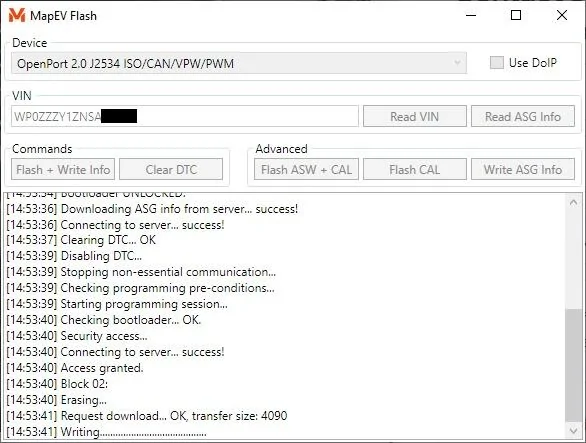

The calibration is comically simple, the whole difficulty is around flashing:
Porsche Taycan Part 2: The J1 Powertrain 1746257716307-c9
If the unlock method gets public (a.k.a. implemented publicly in a flash tool), then I will just implement unlock in the destination flasher. Right now it requires a pre-unlocked ASG, and of course that pre-unlocked ASG has keys and security changed.
Not sure when that will happen, because then the Conti exploit is out in the public (the keys for the Taycan are public). Same reason why Simos 19.2 is not flashable, while 19.3 and 19.6 are. Because the keys for that are public as well, and none of the larger tool makers want the exploit out. Because if everyone and their mother can flash it, we will have the same situation like with Bosch MG1 - when the SBOOT exploit was released too soon and closed in 2020.
Except unlike MG1 in case of the new Vitesco controllers it is possible to easily close the exploit with the software update at a dealer...
You see, I am full stack. I have made and control everything - the flasher, logger, ASW patches and the calibration.
Very soon this is also coming to the J1.2, the e-tron SUV, and all the MEB cars. It is bigger than just the J1. Hence - MapEV.
With destination flashing there will be dealers in many countries, who will have pre-unlocked controllers on the shelf, and can perform the full service for the customer, if the customer does not wish to perform a direct purchase. This is already in process.
Finally the destination flashing also means that the software can be updated at the client via ENET cable for any reason.

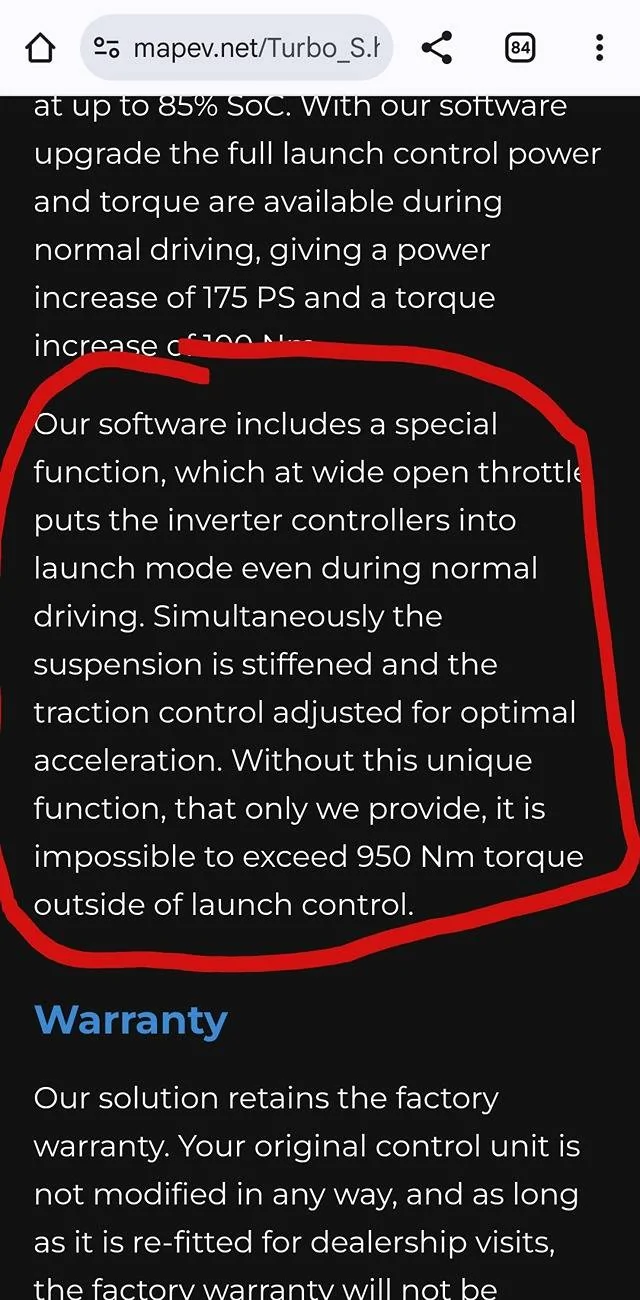

@prj
On your website I read the following, see below highlighted with the red circle.
Could you help me in understanding what happens to the suspension, as not always I want the stiffening of the suspension. Or do you mean the full torque is only available in the sport/sport plus setting of the chassis?
It would be nice to still have comfort setting while having more power.
i try to understand this matter. Furthermore, it takes time to adjust suspension, this is not instant, this while the boost is for 2.5s.....by the time the suspension is adjusted the boost is gone.....
Thank you for clarifying this matter.
It hardens the dampers at the moment of full acceleration. You don't feel it being stiffer at that moment, you just get a lot more traction that way. It's completely natural.
If I didn't tell you, you'd never know. I wouldn't either. The reason I found that out is because I set the bit all the time and then I realised it does that. Otherwise it's completely seamless.
You have comfort setting. Pedal must be >99% (completely to the floor). And in that case you want the maximum traction available.
No, it is for all intents and purposes instant. The level does not change. Only the dampers get set into the correct rebound setting (stiff) for maximum acceleration. If you do not do this, then you get a lot more wheel hop.

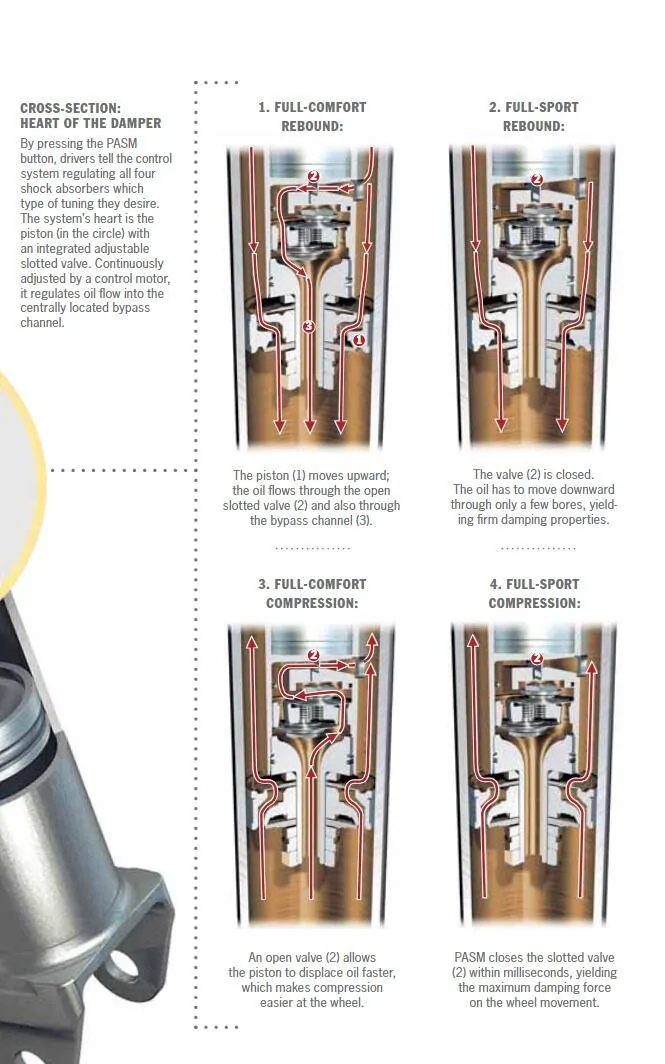

The adjustment of the dampers takes a few milliseconds:
Porsche Taycan Part 2: The J1 Powertrain 1746302529299-6
The adaptive air suspension sits on top of the dampers, and allows for automatic leveling to keep the car even more neutral when e.g. cornering. This is not affected.
