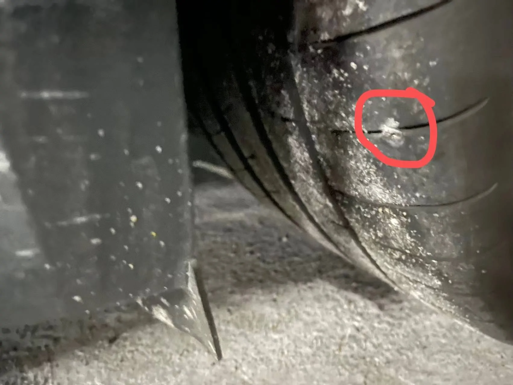

Need some advice on this.
Not the best picture but it's close to the shoulder.
The mushroom plug has been ruled out, but then there is the patch from the interior of the tire.
What does everyone think? Repair or new tire?

Definitely replace. 100%.
No tyre shop would repair any tyre for any car that close to the edge. Or at least they shouldn't.
Porsche would tell you to always buy new ones when you get a puncture. Personally I think that's cobblers though!

that tire cannot be plugged, you need a new tire
