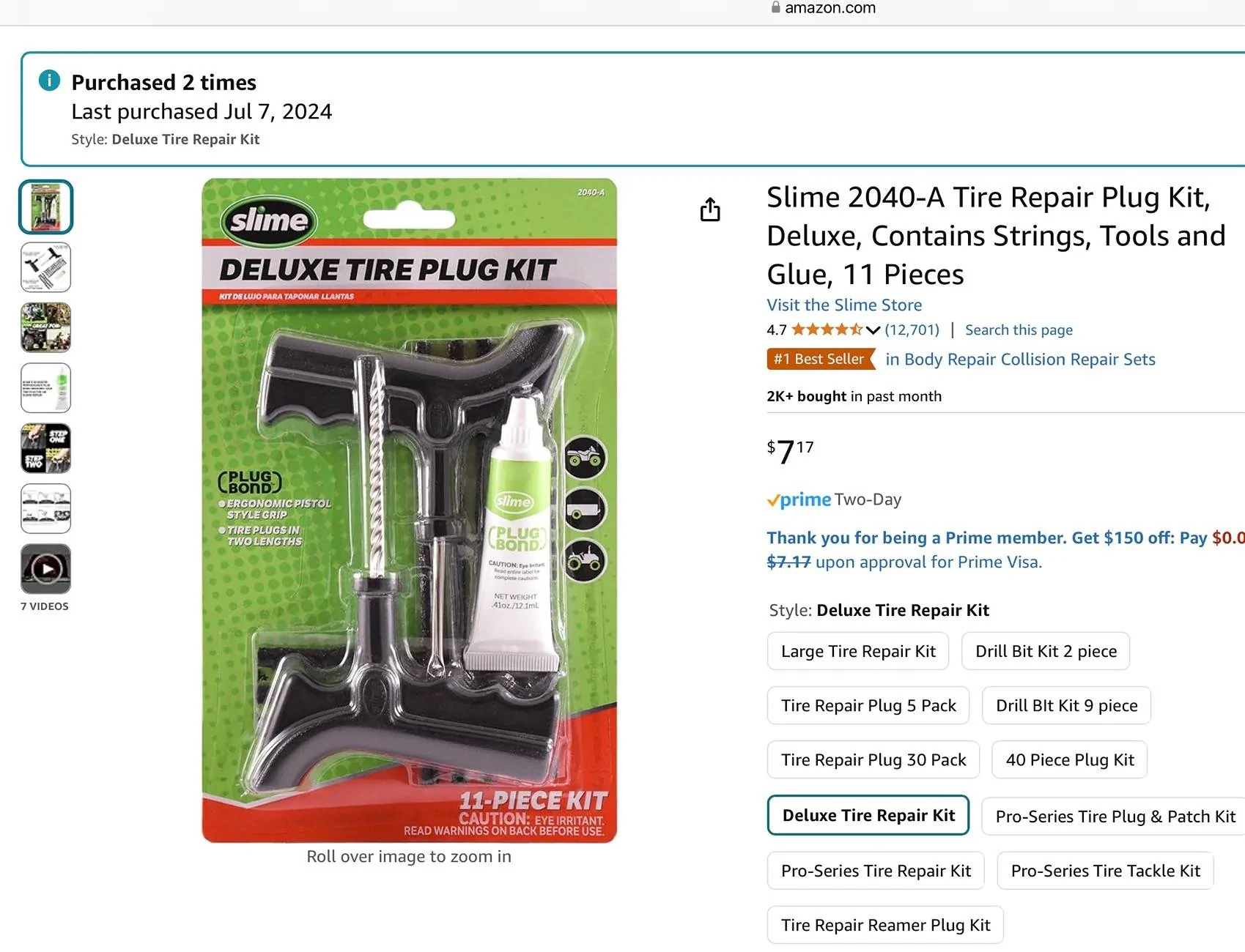

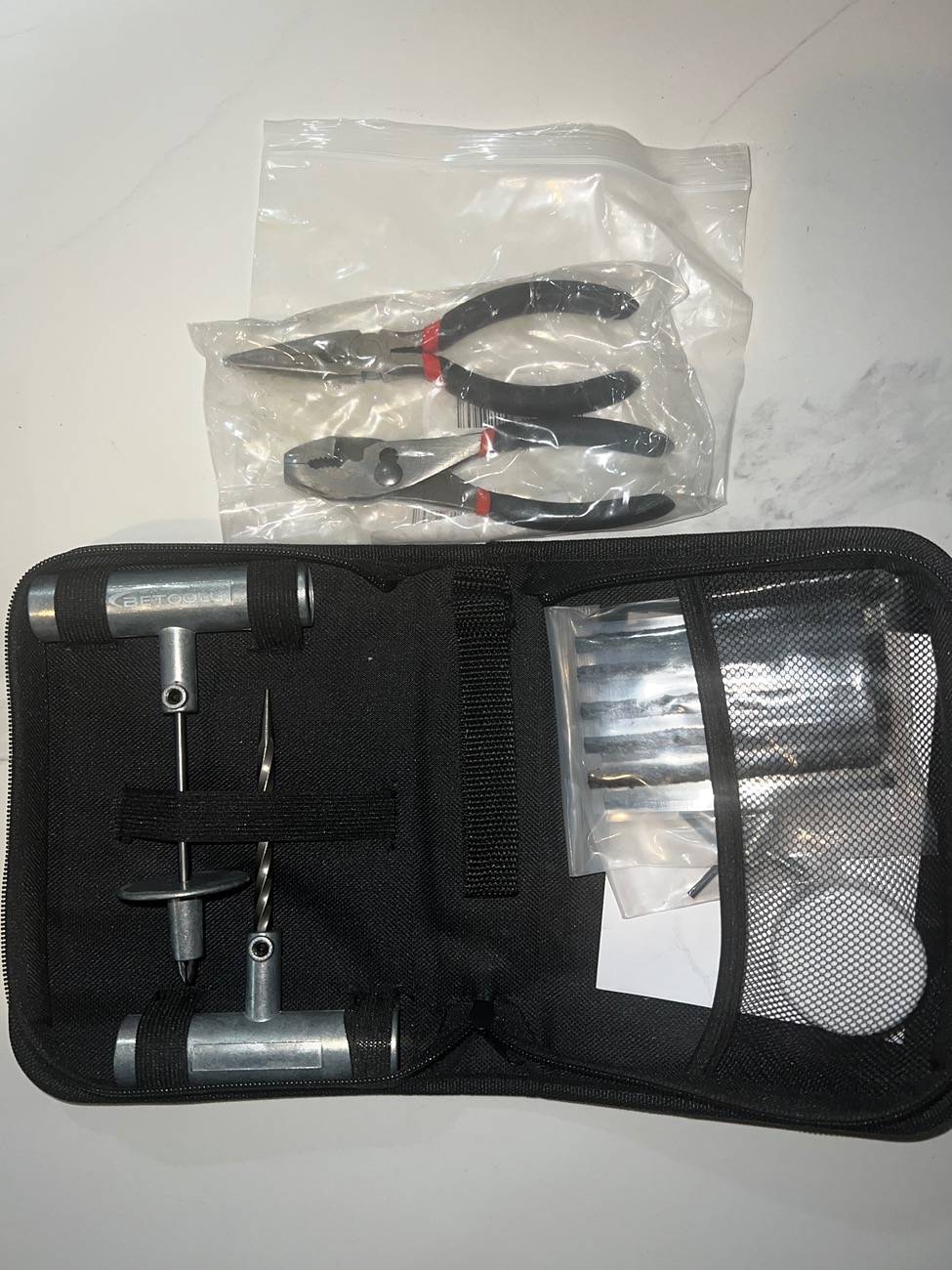

I picked up a screw in my right rear tire a few years ago and wound up on the side of I-580 in Carson City with a flat. It was 20 degrees F and snowing. I followed the directions with the liquid sealant and all it did was help me find the hole - which is where the liquid came out.
I carry a plug kit, so I plugged the tire. I had to move the car to get the hole in an accessible location and then plugging was easy. Two years and 10,000 miles later the plus is still in there. I haven't bothered to get it patched.
