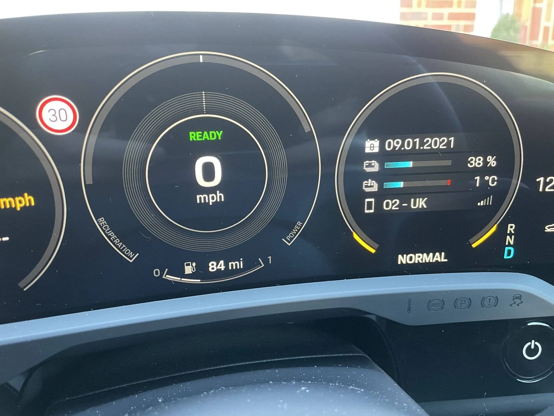

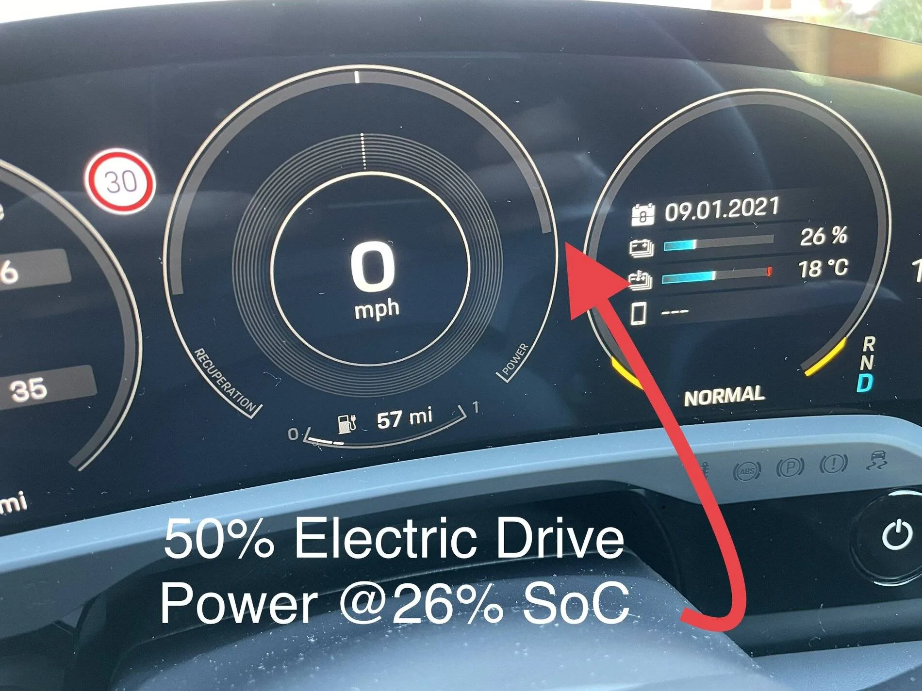

Yes!
I can confirm that the battery temperature as an influence on power and regeneration.
For the sake of testing I've made a test before and after preheating ;)
here is a picture taken today @18:55
Porsche Taycan Performance drop with low SOC? 20210109_200632
and another one taken @20:00 after preheating the car
Porsche Taycan Performance drop with low SOC? 20210109_200726

Thanks for confirming and I really like the way you illustrated the power and regen capacity. I found the temp does impact available power but nowhere near to the same affect as SoC.
