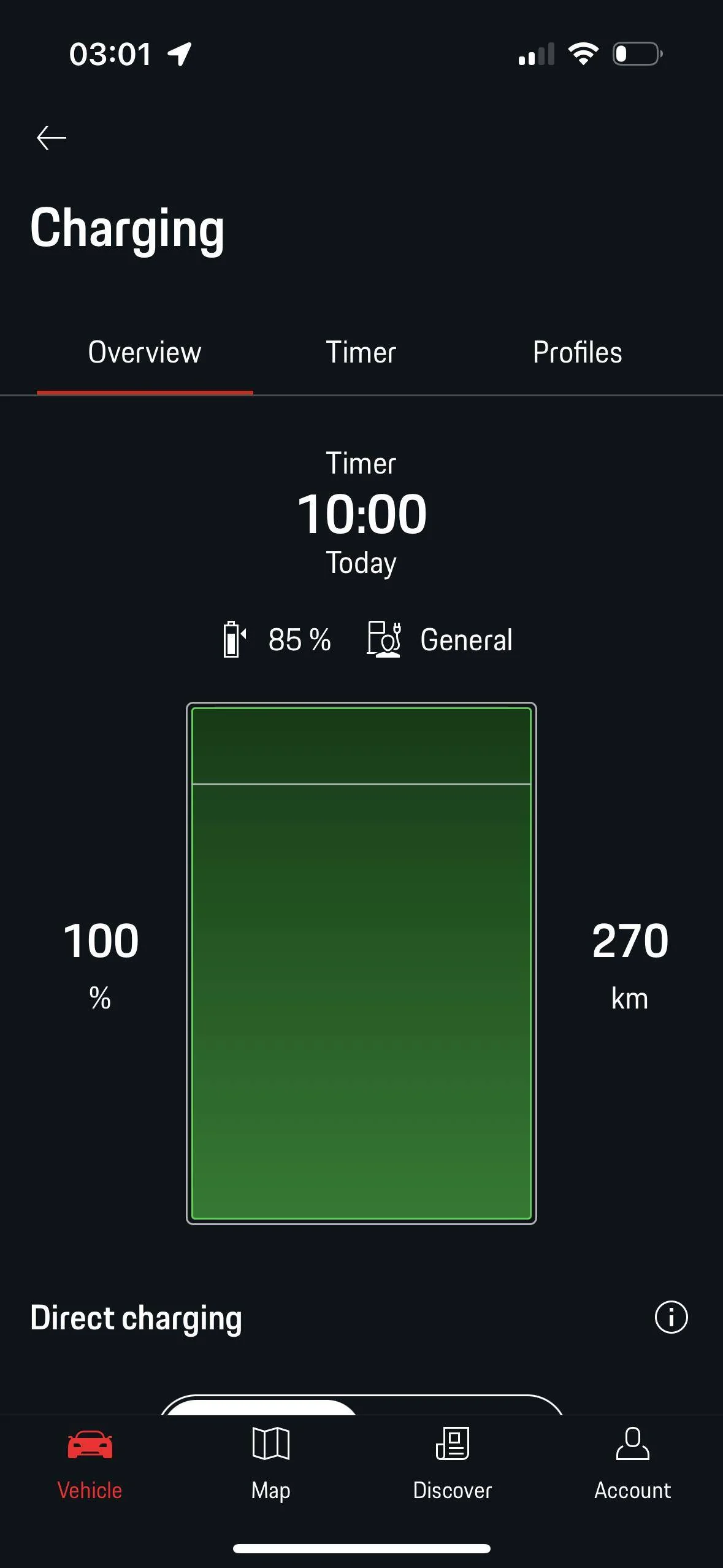

Taycan RWD 2021 (with bp+)
Hey guys
I bought my taycan rwd in august with battery performance plus and in the beginning I got about 330-350km range at 100%, the seller told me these numbers should increase overtime but they havent. I have driven 6000km.
now in the winter I get 270km at 100%
and these numbers doesnt sit quite right with me, I know it will decrease at lower temperatures but the range calculator on porsches website says I should get way more.
Did you find out what is wrong? Mine is the RWD 2021 with 21" wheels and bp+, and I can get only 320km at 100%. I'm a bit concerned because I drive 120km/h, average consumption is 22kw/100km so I should have much more range...
The car now has 400km+ range after being reset in PCM, not sure why it got better after that.

Note that the range is an estimate. I would not worry about low estimates. My range fluctuates between 300km and 400km. My right foot caused the weird predictions. The estimate is based on your latest trips, the weather (temp, rain etc) active navigation, type of tires, ac, weight of passengers + trunk content and probably a few things we don’t know. The consumption per 100km is the only thing that matters. 19-25kwh/100km is “nice”. When you keep your average consumption between the 19-25 range, the guess-o-meter will adjust and predict a more realistic range.
Maybe also worth to calibrate your battery and its management system. Lots of threads around here about how to do it.
Nice! Ty! Will try these procedures
Olá
This in "normal mode"? AC in ECO? If yes, you must be Ayrton Senna's lost son ?
I'm joking. I have a heavy foot but currently it shows around 421 km range in normal mode (AC OFF) at 95%. I usually drive in individual (sport) mode so 380-390 km (with AC ON in ECO) is what I usually see
