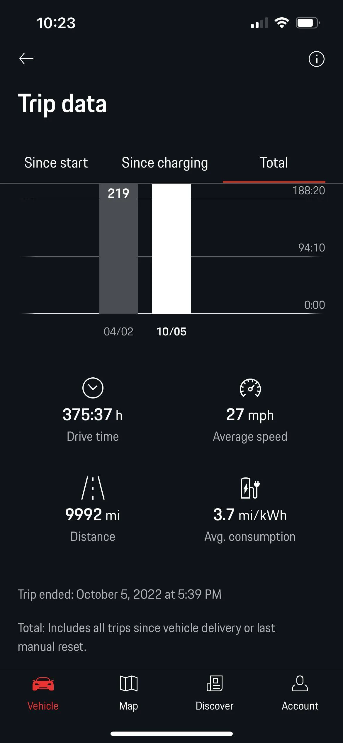

MY21 RWD with PB+, and 21-inch Exclusive Design wheels. Standard charge port. 3500 miles.
3.0 mi per kWh since start. Recently getting 3.4 to 3.6 mi per kWh. Maximum estimated range is 314 miles, but get 290+ regularly.
3.0 mi per kW since start. Recently getting 3.4 to 3.6 mi per kW. Maximum estimated range is 314 miles, but get 290+ regularly.
You might mean 3.0 miles per kWh. kW is a unit of power as in electric motor power, charge rate, and recuperation (regenerative braking)
kWh is a unit of energy as in 93 kWh battery pack, my home uses 12,000 kWh per month, or I get 2.7 miles per kWh of energy.
Thanks, it was a typo. Corrected.
