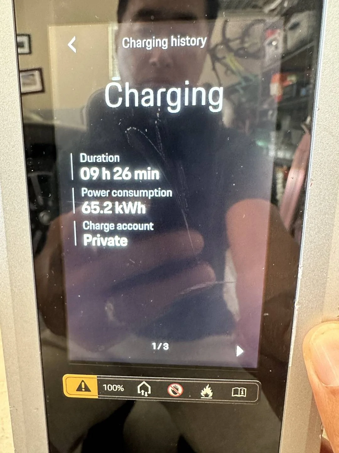

Then about 9 months passed. One day I have noticed my charger was showing the battery was charged only 65 kwh. I had 1% left in the battery that night and it charged up to 85%. That means my battery took only around 65kwh- to my knowledge. I feel like somehow the software is thinking my car battery size as 79kwh base rather than plus. I took the car to Porsche South, hoping they might do something more but they said exactly same thing - nothing shows with scan so nothing is wrong. Also when I showed 65KWh consumption photo to them they said its not what is doing on the battery but some sort of charging rate. I think this is a total BS but I want to ask you all about this.
How much KWh charges with your taycan? KWh showing on the mobile charge after complete the charging is not how much Khw is going into the battery?

Apples and pears.
The 65 kWh in the photo has nothing to do with your battery and is simply the amount of energy used to charge your battery during that charging session.
All batteries have a net and gross capacity. For the PB+ 93.4kWh gross becomes 83kWh net useable.

I believe OP's point is that 65kwh was used to charge his car 84% (from 1% at start to 85% SoC at finish). That amount of energy translates to about 77 kwh at 100% battery capacity. If the 65kwh was the gross consumption supplied by the EVSE to charge the battery 84%, then why isn't it corresponding to a 100% capacity higher than 77 kwh?
I agree with your comment about miles per kwh being important, but OP is concerned about the capacity of the battery, not just the consumption rate.

It’s not the rate. It’s the energy. OP is thinking right there. But I assume it’s also the energy through the EVSE before losses, so likely even less in the actual battery.
In any case, OP is missing the total vs usable as @TaycanCook points out. Still seems on the low side.
The principle OP is using is the correct way in my opinion. As you state he charges 84% and the PMCC reports 65.2 kWh (assuming that is correctly measured). And that would give 77 kWh less perhaps 10% losses in charging equipment and cables etc. So battery may hold just 70 kWh?
It would mean about a 16% degradation? (based on 83.6 kWh new usable). That does not sound totally incorrect but on the low side.
Best would be to use a OBD scanner and plot the mileage and SoH into @ciaranob excellent material.

10% degradation means you now have 75kWh real capacity. Up to 10% losses means 0-100% should draw 82kWh from the grid.

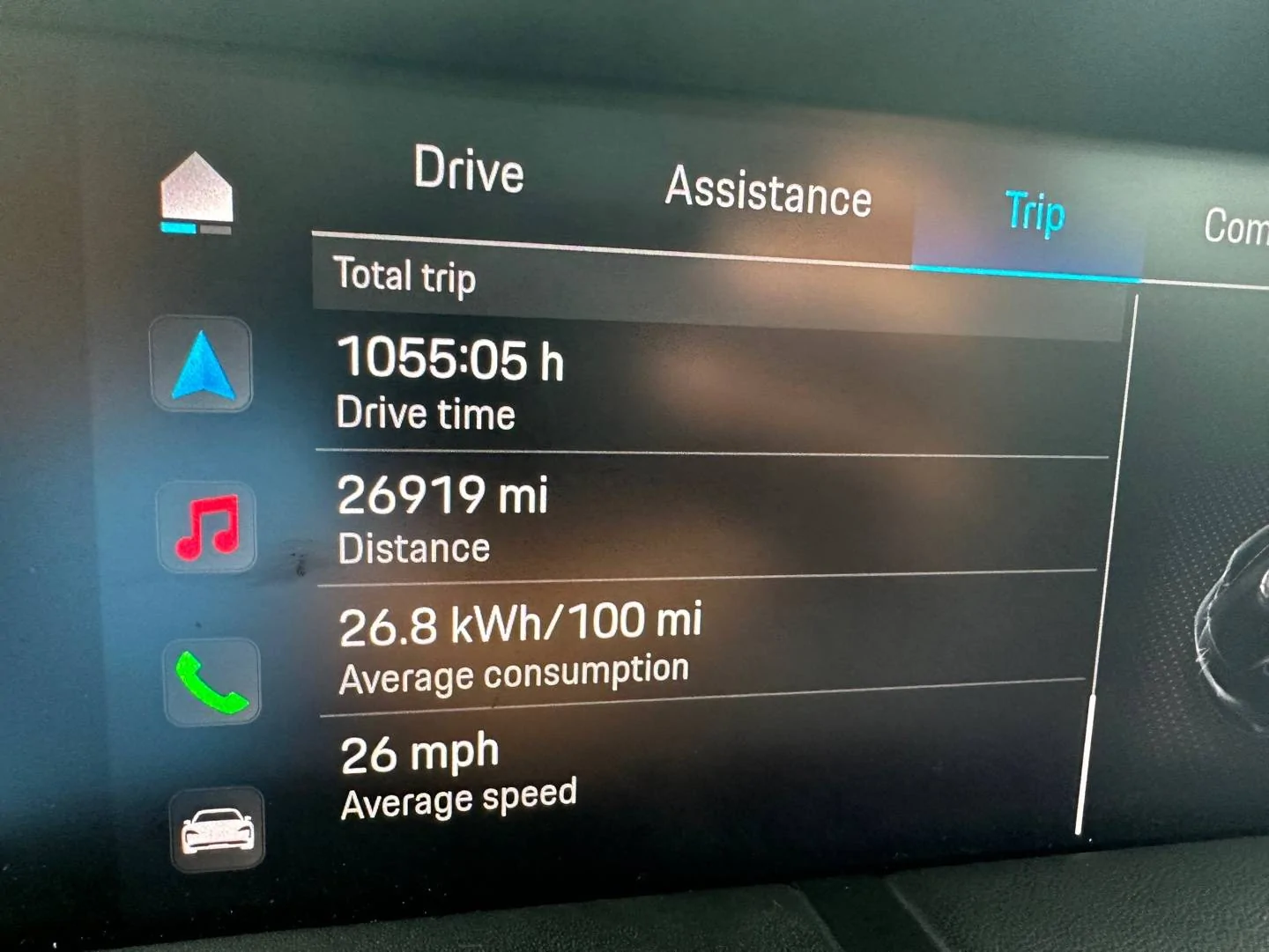

Thank you so much for your information. My consumption shows with PCM is 26.8kwh / 100 Mile for total trip and today trip 36.5kwh/ 100mi.
With total trip info, shouldn't I get 300 miles with 79kwh ?
EV is complicated. I will go to Charing Point to charge my car from maybe 1% or 2 % all the way to 100%. How much Kwh should my car be charged and stop at 100%?
And from82kWh 85% of it is 69.7 kwh ? that is maybe what I see on the charger.
I can't imagine 2020 PB (not plus) need to work with only around 59 kwh after 3 years
No, you will not get 300 miles of range. Is that your question?
Dude, just charge your car to 85%. Note your odometer reading. Drive it down to say 10%, check your odometer again. Take the miles traveled and divide it by the change in your state of charge, and voila, you have your range. Why are you trying to make it so difficult? It’s not rocket science.
