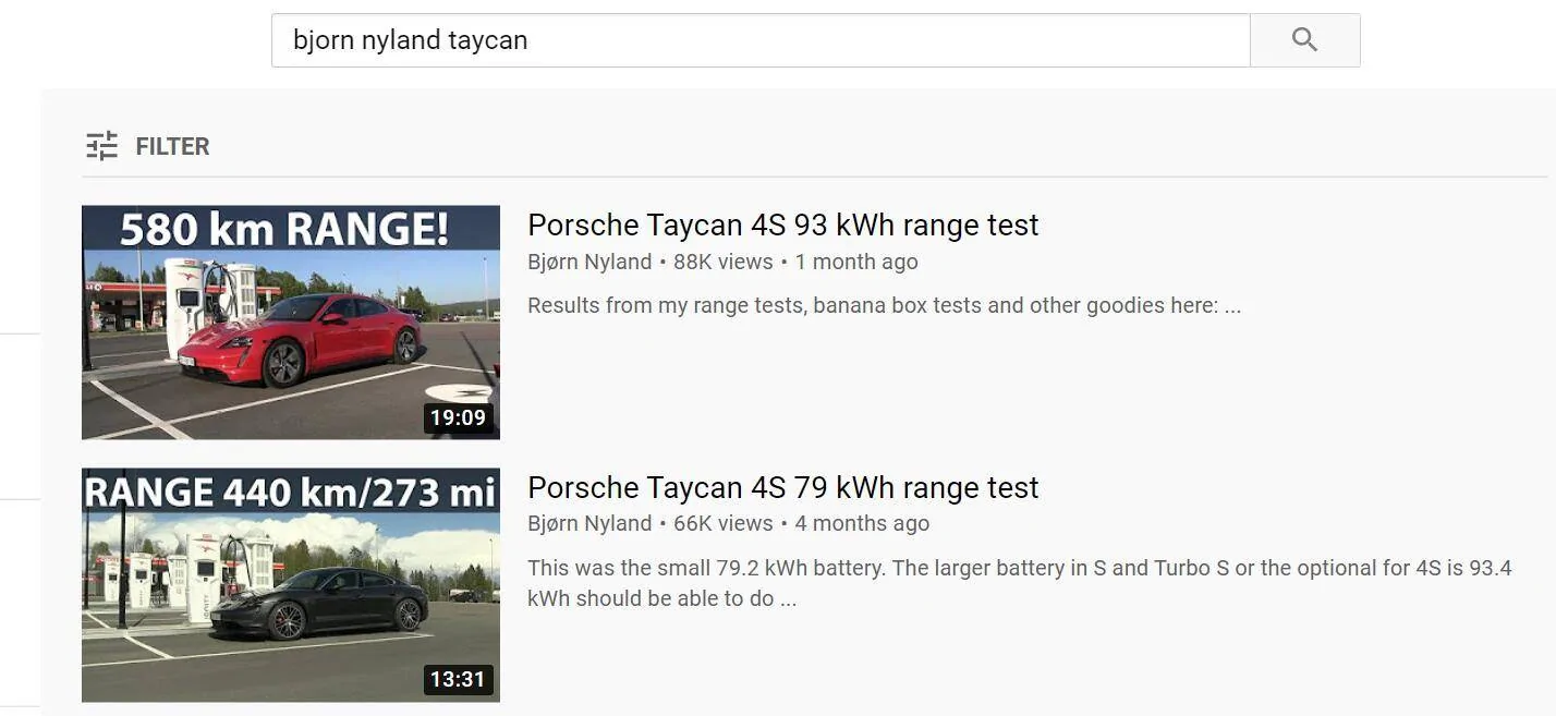

This is my 4th electric vehicle. I have yet to remember one situation where I thought I should have bought the smaller battery. On the other hand, I had several occasions where I wished the battery was larger.
It is also definitely more than 30 miles extra range - watch the YouTube videos, Bjorn Nyland has done again a great job

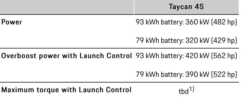

Maybe what I'm having a hard time wrapping my head around is that it is called "performance plus" when it really does nothing to increase the actual performance. 0-60 is the same, top speed is the same.
Go for the bigger battery - yes, it’s a chunk of $$$, but possibly the most important upgrade you can select. Even though the 0-60 times are basically the same, the larger battery allows the motors to produce more power, hence the “Plus” label:
