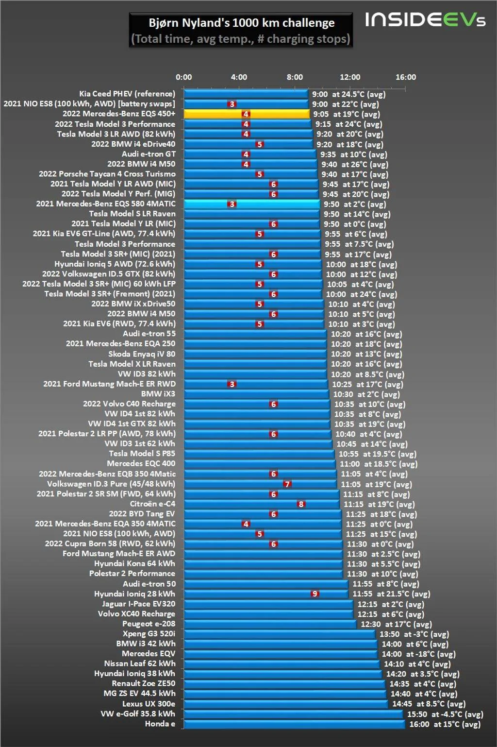

A good way to report long distance driving is the 1000 Km test. The Taycan does quite well because it charges so fast.

I recently did 2 trips of 1000 and 1300 km in one day. By the time, you grab a sandwich (and eat it), go to the ?, battery has enough until next stop.
I'll save perhaps one stop with a higher range, but 20mn on a 1300km trip is insignificant

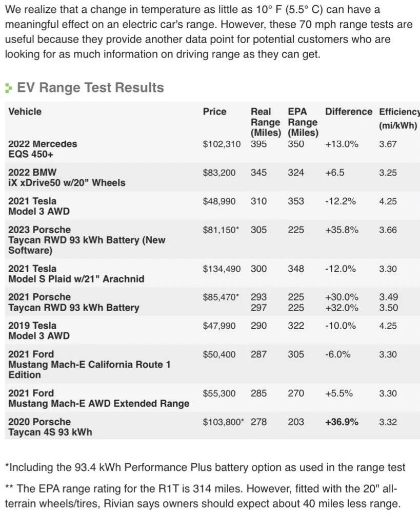

300 miles is WLTP - laboratory testing and is only that - real world, by region you'll glean from this forum. The online range calculator tailored to your car and general spec is quite accurate in my experience.
I doubt anyone buys a Porsche (any) for efficiency at the end of the day. Best to ignore what the range quoted at the end of a charging session and as I mentioned above, rely more on the consumption data which will then help you figure the underlying realistic range all other things being equal.
Folk in humid / warmer climbs (Florida for example) will easily get close to 300 miles reported range (one forum member has exceed this) but few have quote their consumption which is the real leveller.
Folk in UK - summer - 260 ish, winter - 235 ish

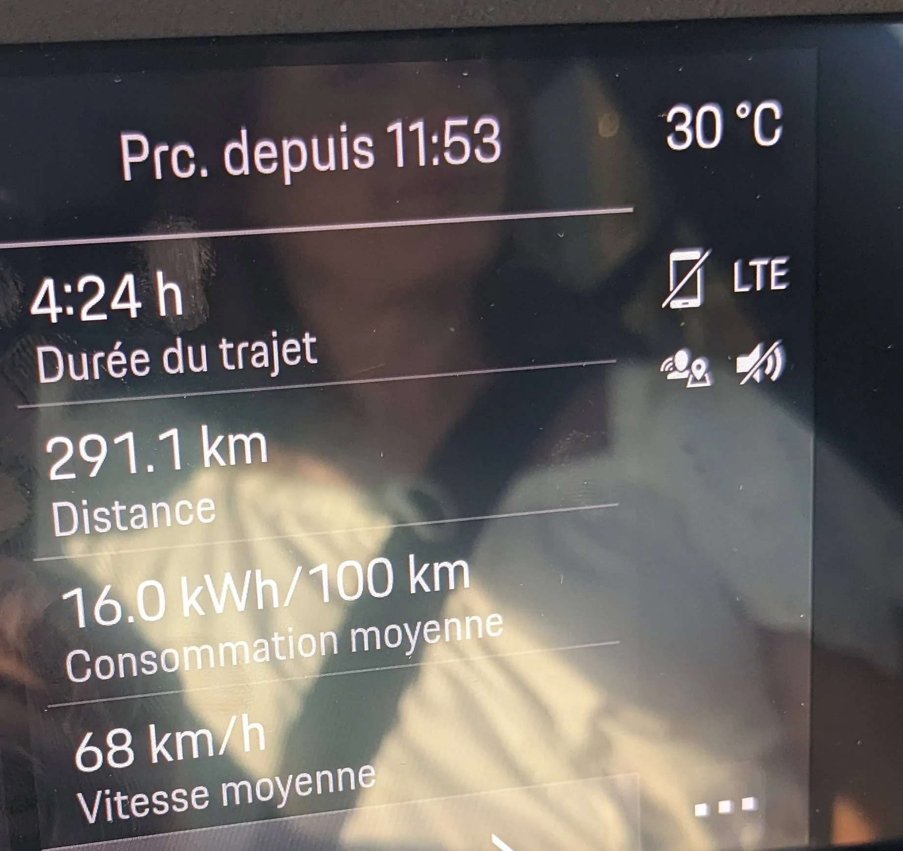

Porsche Taycan Is my battery performance battery plus or not? PXL_20230811_155615869~2
I wasn't trying to break any record: 16 kWh/100 km in summer (30°C outside, 21° AC inside), 3 adults, 5 luggages (frunk and trunk full), driving at 50/60 mph on a curvy mountain road (including traffic lights).
That's about real 320 miles range.
