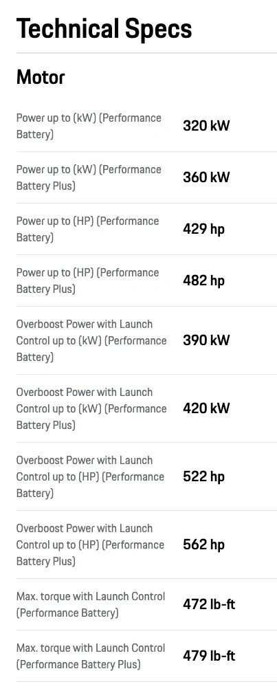

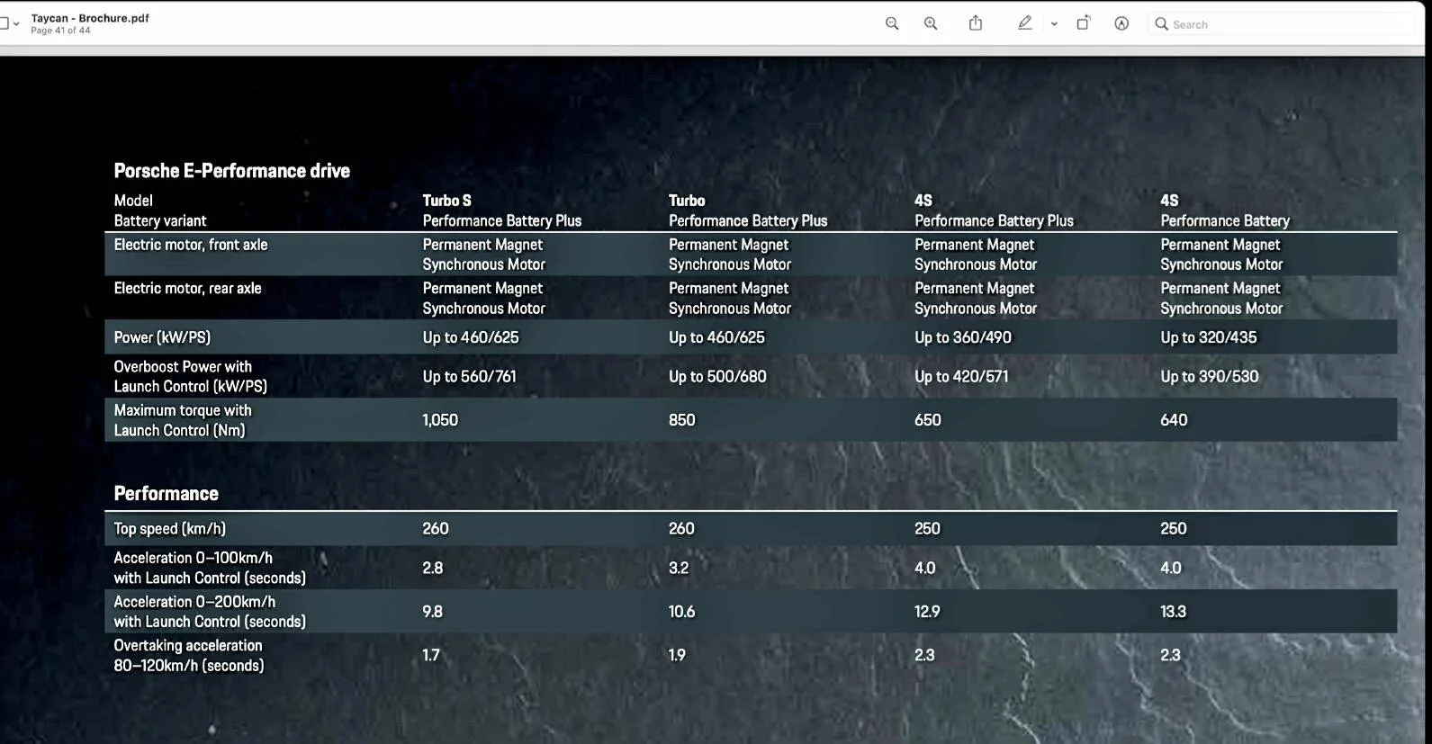

My understanding is that 0-60 is the same, but 30-70 mph or any of the other "car is already moving, accelerate MORE" show better performance for the PBP.
IMHO that kind of "passing acceleration" is in many cases more important and also more noticeable in daily driving.
I'll try to find the actual numbers.

Passing times are faster, which has more real world practicality. I also believe the PB+ charges a bit faster on fast charging stations. That might mean a lot or nothing to you. If you plan to travel in it, that's important, as is the added range since depending on where you live, the unreliable EA network could mean that extra mileage saves you to get to the next charge point.

I am very happy I got the larger battery. As others have mentioned it really isn't about the increased range as much as it is about the acceleration at midrange speeds...60 mph - 80 mph to pass on the highway for example. I really noticed the difference in test driving my identical model with and without the performance battery....My range is about 280 miles in Southern California.

Two good points and one dubious point. First, the "while-already-moving (WAM)" acceleration is definitely better with the bigger battery in the 4S. It's one of the reasons I moved in that direction, but not the principal one. Instead, it's because of your second point: the PB+ does indeed charge faster at EA stations and that is time (aka money) well spent.
