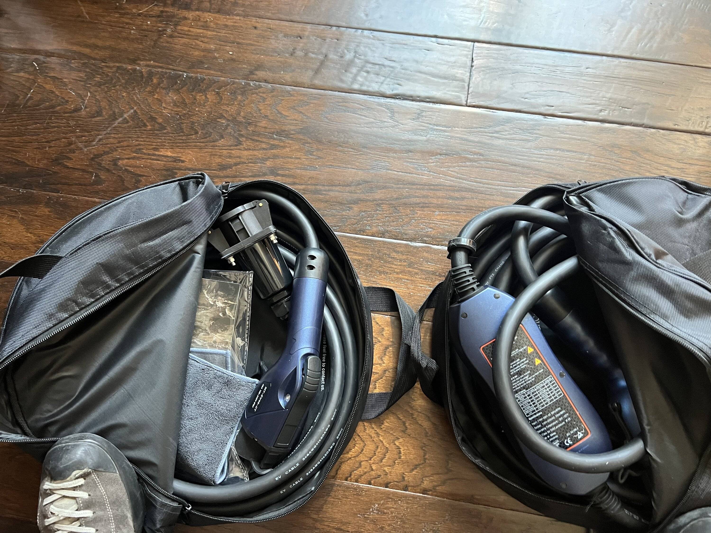

Well put an order in for the Mustart portable EVSE I mentioned previously thinking it would probably take some time i.e. possibly months due to supply chain assumptions and with my PMC+ reconfigured ready in between. This despite knowing how quickly their extension cord I ordered months ago was delivered and sure enough they stepped up again, literally shipped overnight for free it was dropped on my doorstep today - impressive!
Works like a charm - very impressed with the overall quality of the Mustart gear and this EVSE nice and compact relative to the PMC+ - top notch.
All their gear comes in a neat carry bag with wall mounting hardware etc. included (mounts not needed by me).
Porsche Taycan PMC+ Not Throttled and Works post uPdate IMG_6969

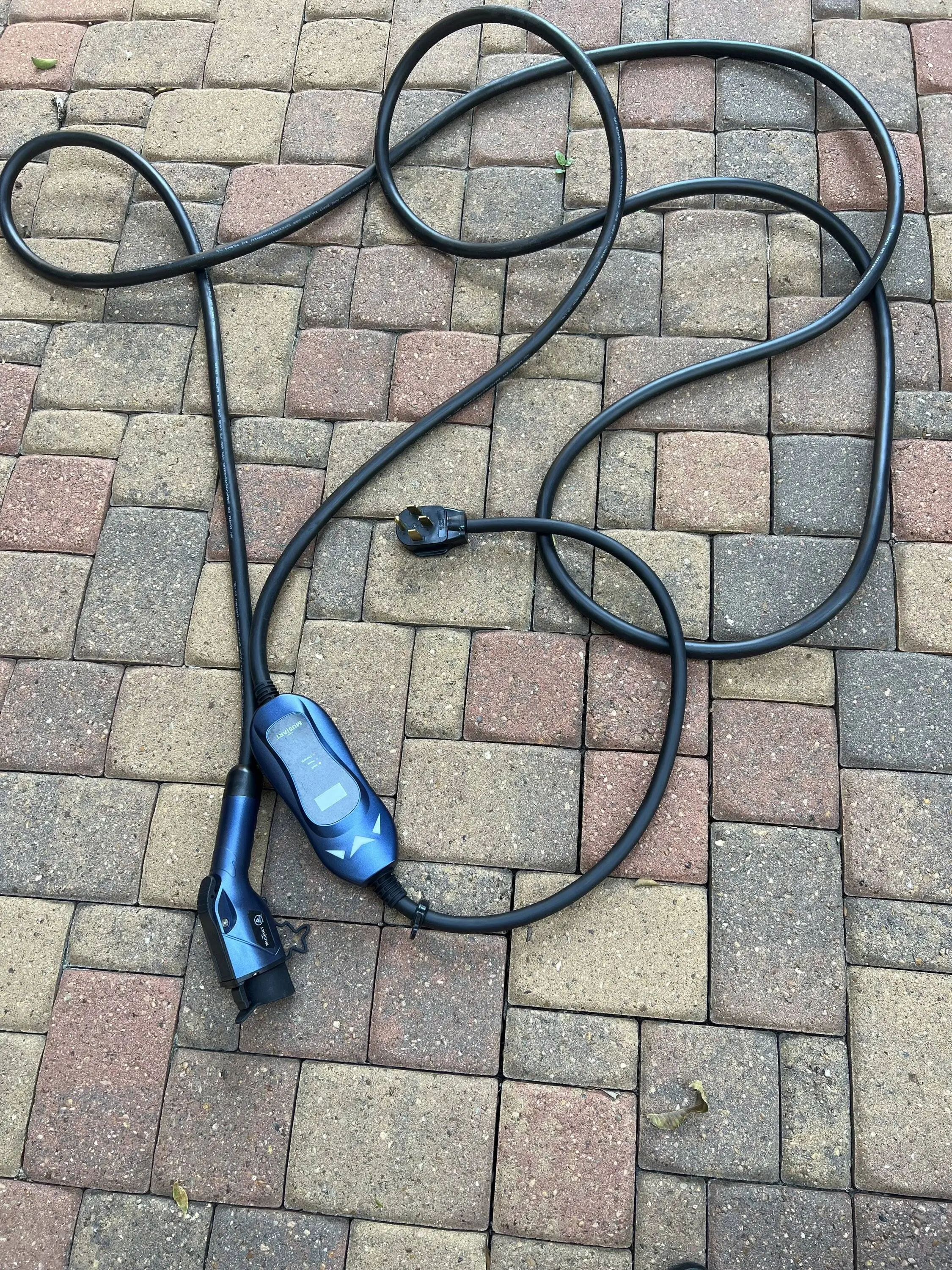

Now have a matching pair - one for the extension cord (20 ft), the other for the EVSE (has a 25 ft cord):
Porsche Taycan PMC+ Not Throttled and Works post uPdate IMG_6970
Porsche Taycan PMC+ Not Throttled and Works post uPdate IMG_6971
Porsche Taycan PMC+ Not Throttled and Works post uPdate IMG_6968

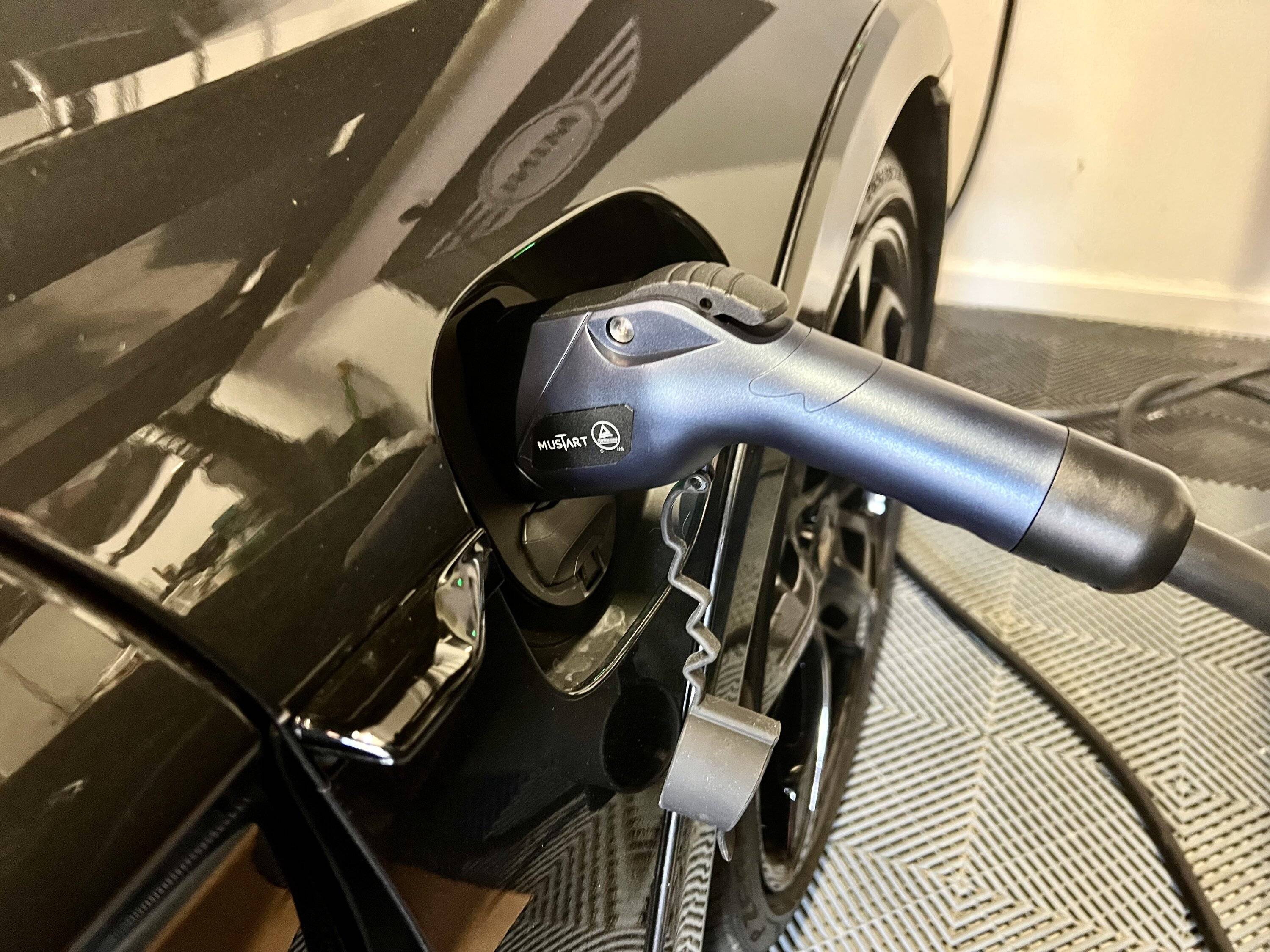

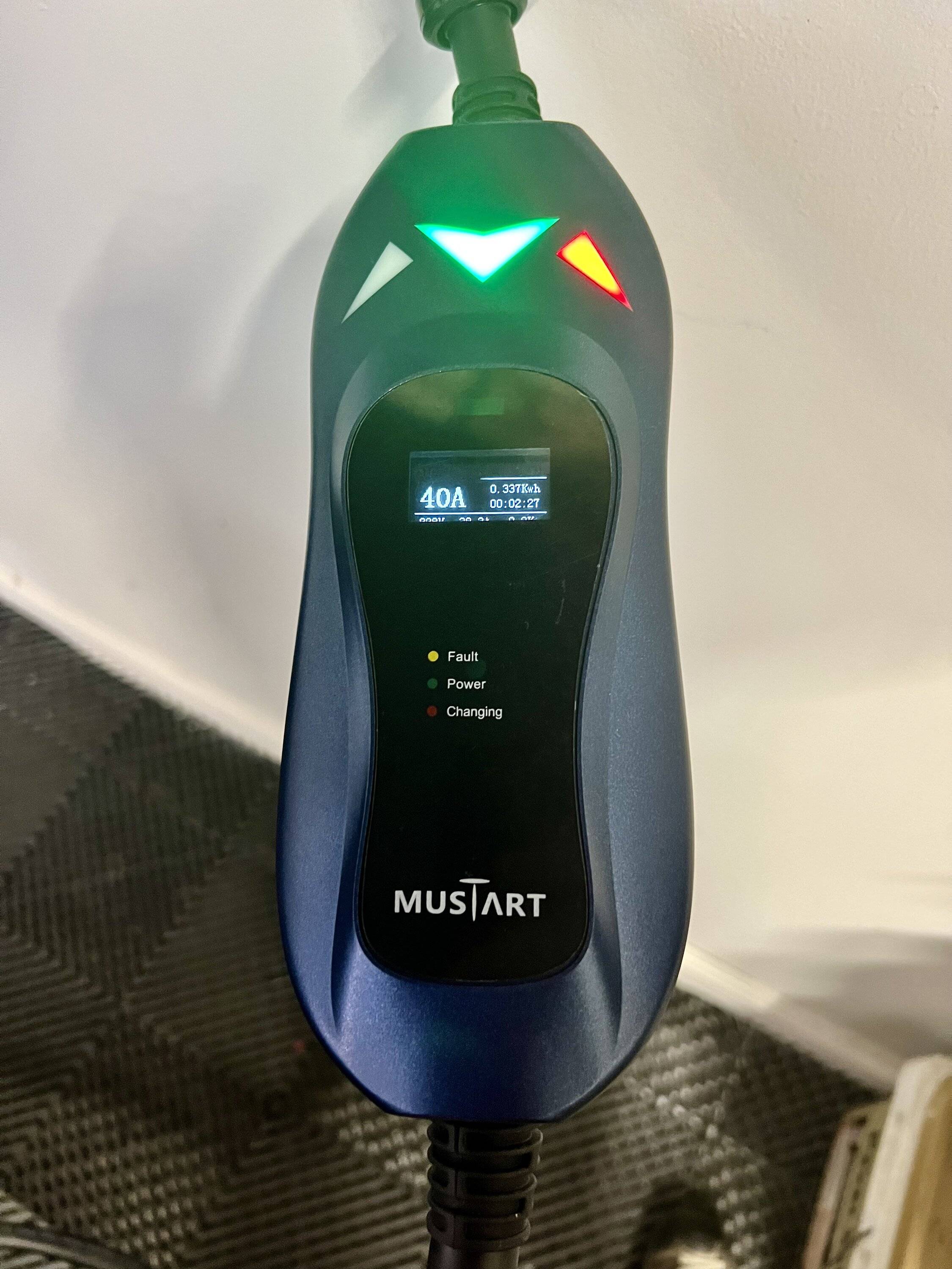

Plugged in to test using my other available NEMA 14-50 socket in the Garage (my main garage EVSE a Charge Point Home Flex hardwired to NEMA 60A which gives steady 10.5 kW to my car) - nice rubber caps attached to protect the plug when stored:
Porsche Taycan PMC+ Not Throttled and Works post uPdate IMG_6967
Has some nice real time data on the display and getting solid 8.5 kW in car - good to go! My Porsche uint will simply be an emergency back-up that TBH I can hardly ever see needing:
