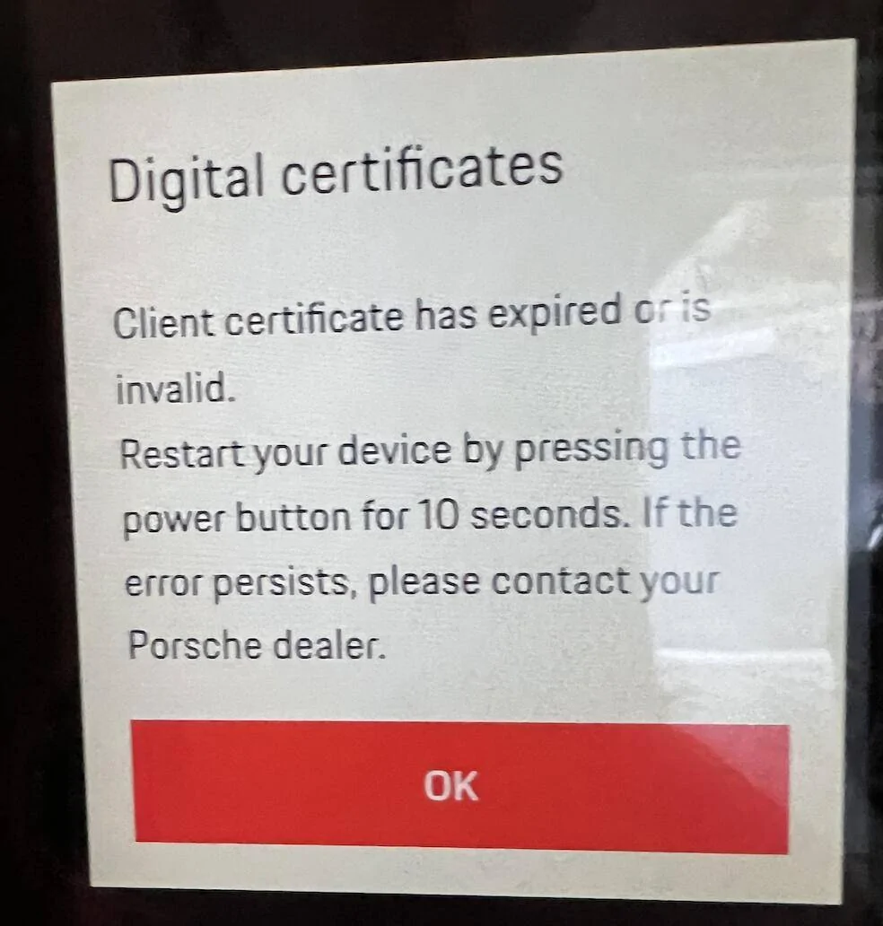

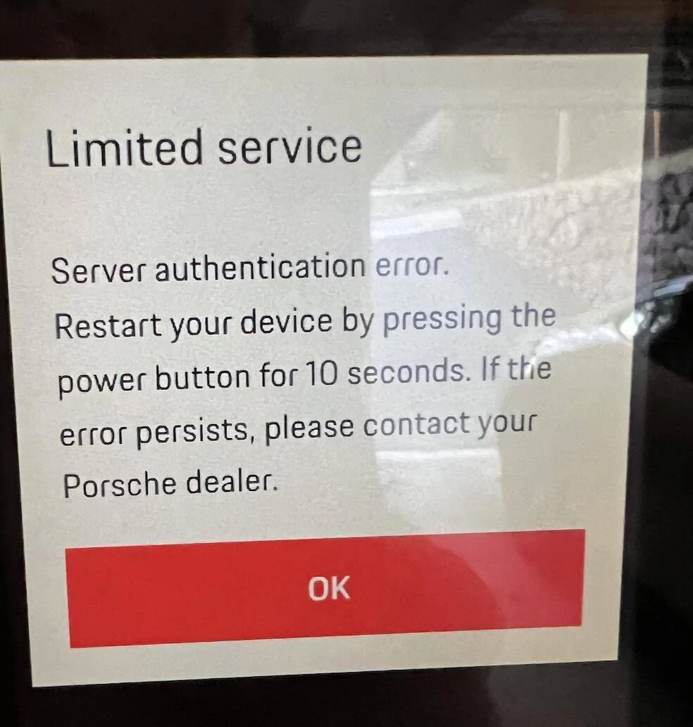

Thought I'd see if the collective wisdom of this group has any bright ideas for this PMCC issue. I am tempted to replace it as most experts here recommend but truth is it's operated ok for me and it just hasn't been bad enough for me to toss it. I've had it since Sept 2020, used the Hubbell outlet, and never had a problem with overheating. With the latest update (3014) have adjusted the current back to 40A and turned off the sleep-mode so it doesn't keep resetting.
Anyway, the PMCC is displaying a message that the certificate has expired. After clicking out of that screen, then it displays a message that there has been a server authentication error. And my app shows a "Charging Error". Despite all this my Taycan charges fine from the PMCC - the General Profile works fine, and the timers work fine. It's just slightly annoying and disconcerting to see the "Charging Error" message in the app and the messages about the certificate on the PMCC. I found the Certificate Error thread here, and what worked for everyone there was to do a software update - but my PMCC has the latest software so that's not an option. Any bright ideas?

this is a new one for me…and doesn't help the PMCC's case in my opinion.
I think the screen shot that suggest if the error persists to contact you Porsche Dealer is about hte best you can do - but I'd be super surprised if any of the mechanic's at a Porsche Dealer know anything about SSL certificates and what to do when they expire. Nor can they generate the necessary software release to resolve the issue.
I'm going to go out on a limb here and suggest this is a software fault on Porsche's end (cerfications expire about every 5 to 10 years) and the PMCC has been haunting the industry now for about that time period.
anyone wanna take a bet that someone at Porsche forgot to get a renewed certificate, and if even they did know about the need for a refreshed cert, they failed to to generate and distribute an update to refresh the cert on the device? That's my bet.
  1. Dealer won't be able to do anything
  2. they will escalate to Porsche
  3. it will take days/weeks/months for something to happen
  4. it will be resolved by a software update
    1. but there is even money chance this certificate will block the device from OTA updates since the cert is expired it will be blocked from talking to the servers
  5. there is a small chance dealer will replace the "faulty" unit with a new one - but if my theory is correct and it's a systemtic software issue, all the new ones will have the same problem
  6. it also could be a server side error with a poorly worded client side (PMCC) error screen - and the problem may resolve itself with Porsche updating their cloud/server software - with out insight into the communcations design of the PMCC we can not know if the error is all that accurate
    1. SSL errors are hard to diagnose and server side issues can somethings cause client side failures…exactly like this.
the above 5 items is 100% speculation on my part, but I'll suggeest after 30+ years in the software business well informed speculation…
it also makes sense that it doesn't affect EV charging - because this only for the useless PMCC software on the device that reports charging statistics to the Porsche portal.
It will take time and effort to resolve this - more than replacement cost EVSE worth of time/effort in my opinion, and you may have to leave your PMCC with the dealership for diagnosis - meaning you will not have an EVSE if the dealer needs to keeps the device to "diagnose it" - translation - store it on a bench somewhere in their servcie shop while they wait for Porsche Germany to get back to them after the esclation.
I'd be curious if this is happening to other PMCC's - because if my theory is correct, Porsche just let their entire "fleet" of PMCC's expire and this problem will not be unique to specific units, but rather endemic the fleet - and will cost Porsche a lot of money to resolve if owners demand they be "fixed".
here are you choices:
  1. have your dealer begin a resolution process
  2. purchase an alternative
  3. live with and ignore the problems since it doesn't seem to affect core functionality - and your Taycan still charges.
I'll be fascinated to hear of any investiation and/or resolution steps to this.
good luck!

if some entity at Porsche let a cert expire (speculation on my part) - I'm going to suggest these sorts of problems can be cleaned up fixed pretty quickly if the team knows what to do…but if this is unexpected to Porsche and they do not have a team in place already up to speed on these sorts of issues - well then get out your pop-corn and watch this one evolve…

Thanks Dave for your usual insightful input!
I did a factory reset and took the PMCC off of wifi - I don't use the web portal much and as an added bonus, I won't get unwanted updates. Let's see if not being able to request the certificate does the trick.

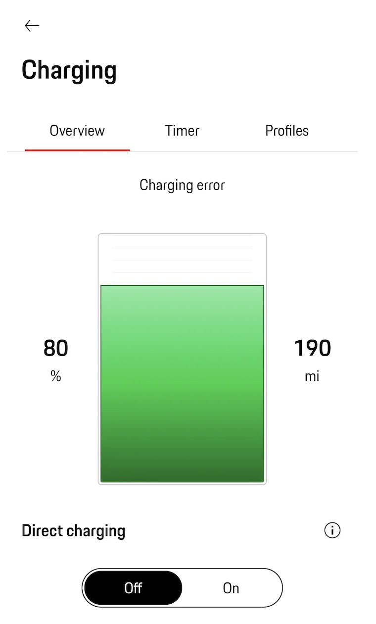

I know the "charging error" on my app only occurs when charging on my PMCC and it only recently started happening. I charge at a second house with a Clipper Creek that works great and does not result in the app having the "charging error" message.

I think taking the PMCC offline from wifi did the trick. Porsche should be embarrassed. In any case the "Charging Error" is gone and no more Certificate error.
