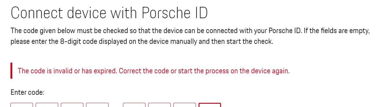

Good idea! I hadn't previously done, that so I tried it.
But I don't have a User Code to enter; I suspect the user code is generated by the PMCC during the pairing process.
So I tried entering the ID of my PMCC (hoping that may also work), and (of course) that didn't work. I got this error:
Porsche Taycan PMCC Server authentication error Capture PMCC
I can't click on User Profiles on the PMCC. When I do, it says, "The device is offline" or something to that effect.
Keep the ideas coming!
Note that the PMCC charges my car just fine. It's just the pairing with my Porsche ID that's broken.
