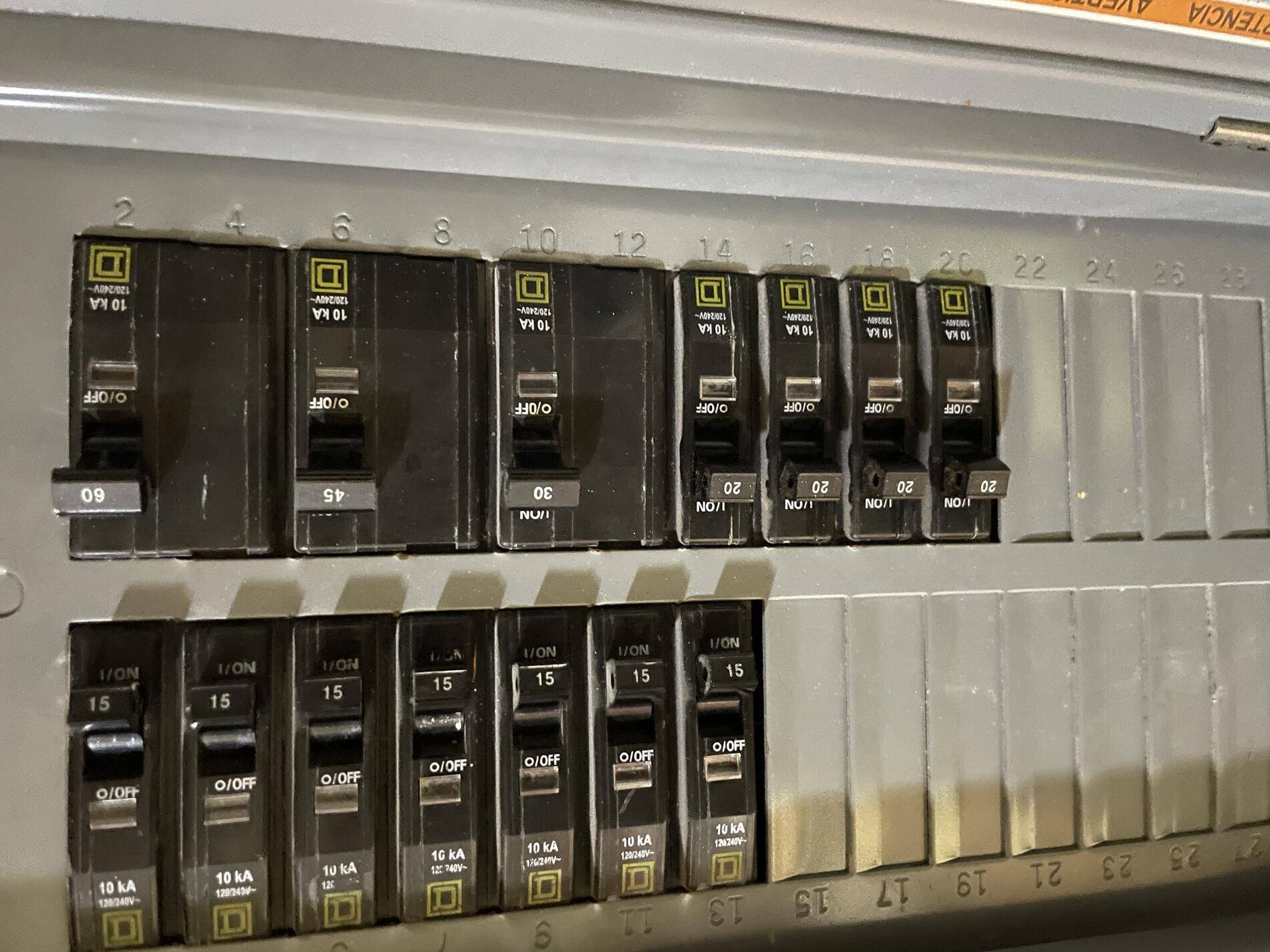

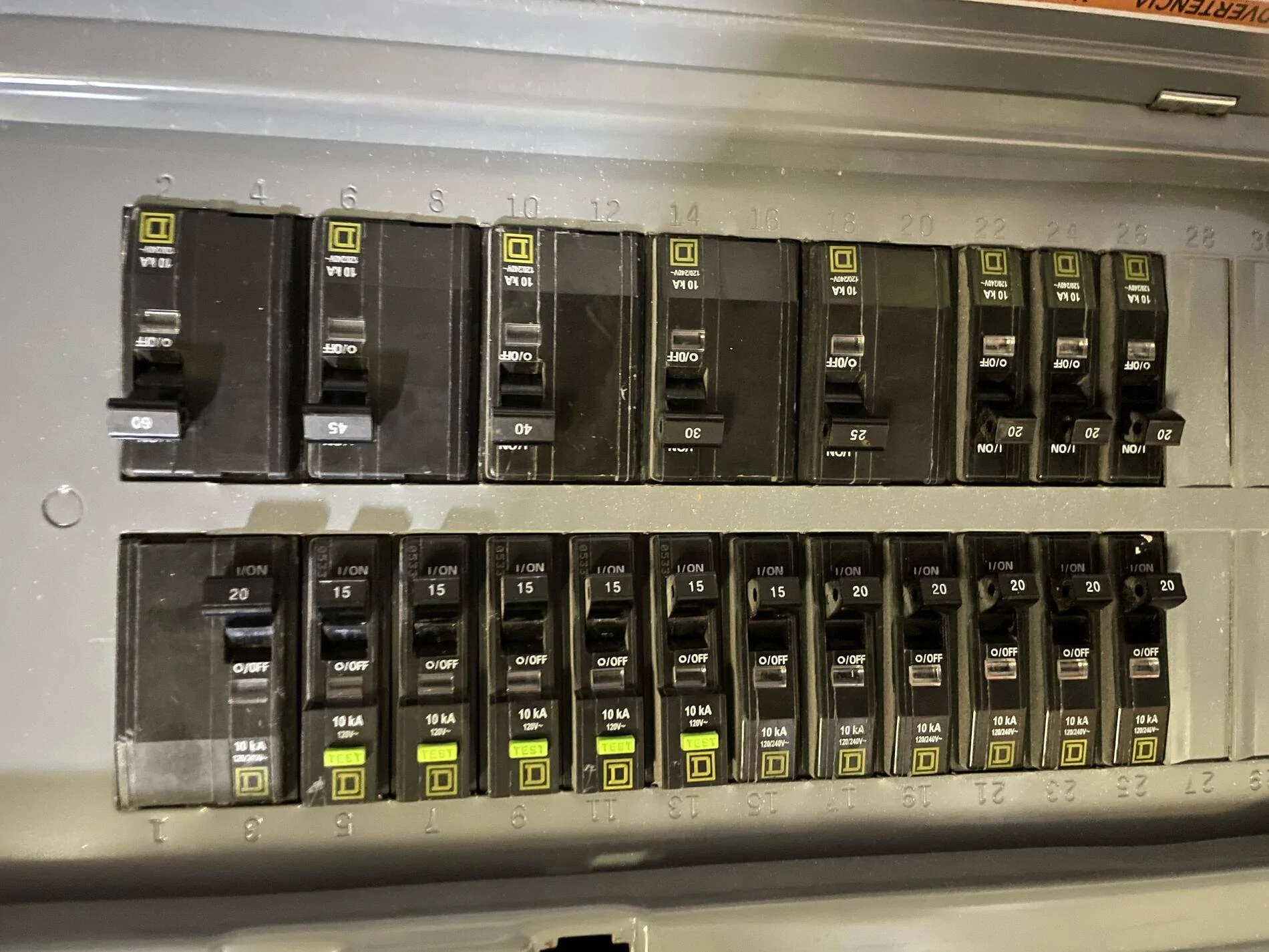

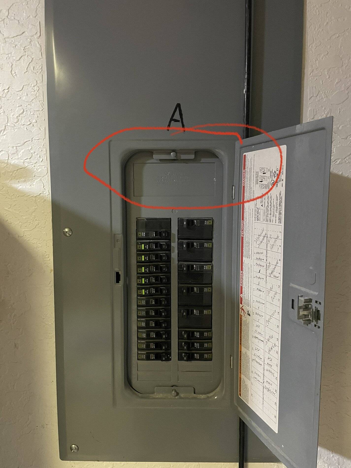

Isn't this where my main breaker should be??
The label on the inside of the lid should have an amp rating also which would help ballpark the incoming feed size.
193
7,037
10,540
193
7,037
10,540
hmmm your loads seem to be as follows:
  • slot 1 & 3 - "big" 20 - disposal & dishwasher - not a big factor for 'simultaneous use'
  • slot 2 & 4 - 60 amp - AC Compressor - I'd bet it comes close to max load and can pop on & off at any time - so could be loaded while charging an EV
  • slot 6 & 8 - AC Compressor "front" - see above
  • slot 10 & 12 - Oven - only used during meal preparation - not commonly on during EV charging after midnight - but I don't know your family
  • slot 14 & 16 - Cooktop - see oven usage patterns
  • slot 18 & 20 - 25 amps - water heater - will go on & off at random times, but mostly during the day while people are awake - unlikely to have a lot of load "during" off hour EV charging
the two AC units are the most expensive and the most likely to ever be running while you're charging your EV - if you schedule it to charge "while sleeping"…

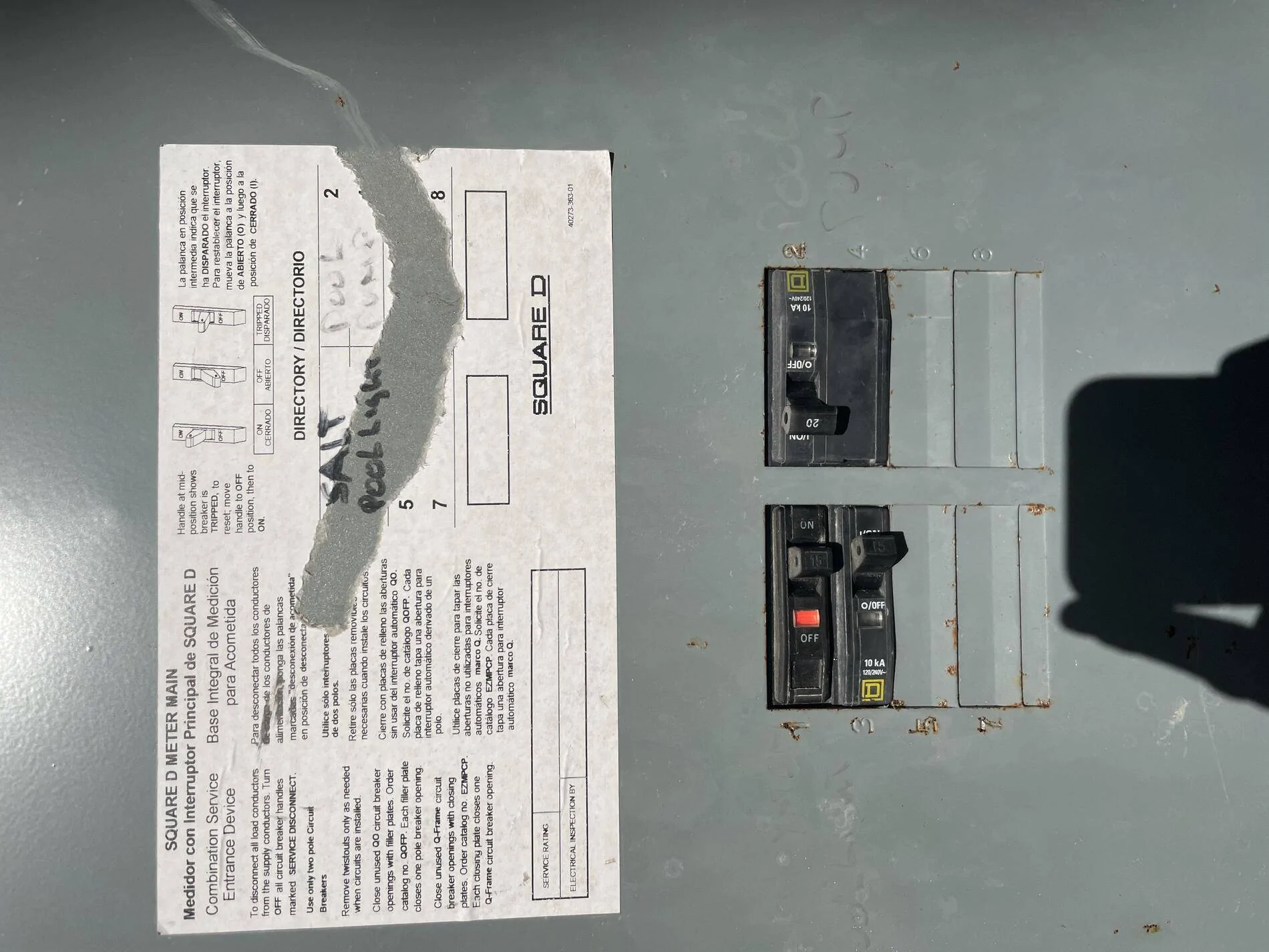

Sorry the pics are sideways, don't know how to fix that.
This is what is outside

The first pic looks like another subpanel. The second looks like it’s for a 400 amp service. I still don’t see the main breaker though.

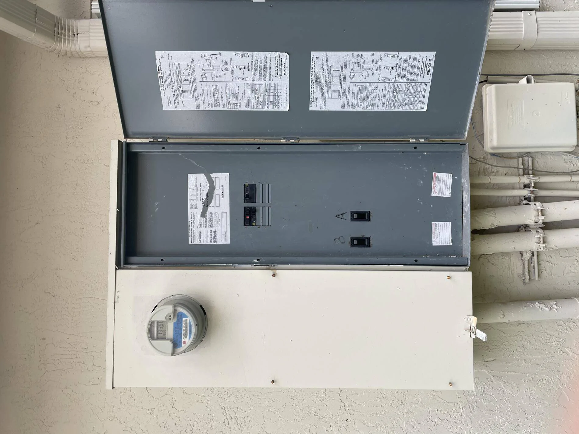

I live in a gated community. Maybe im not allowed access?
It might be those A and B ones for the two panels you listed earlier. Might be two separate 200 amp feeds. Can’t tell.
