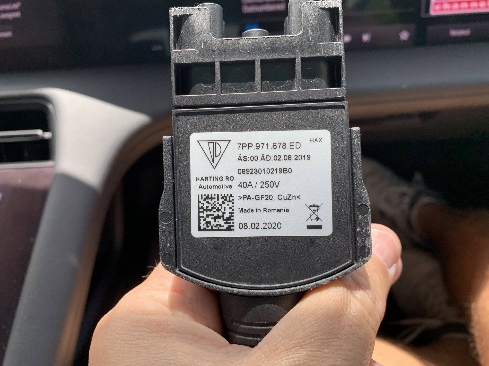

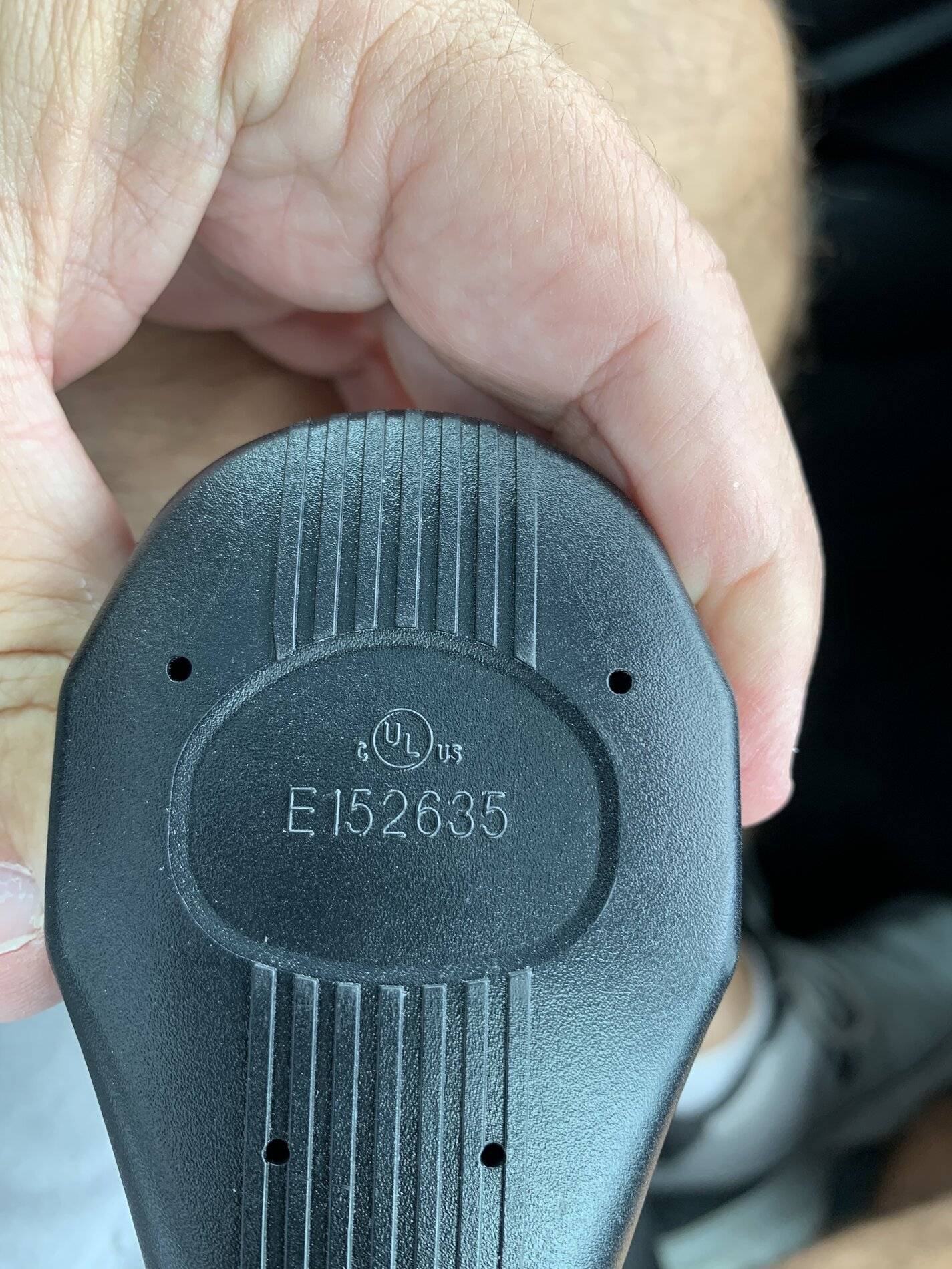

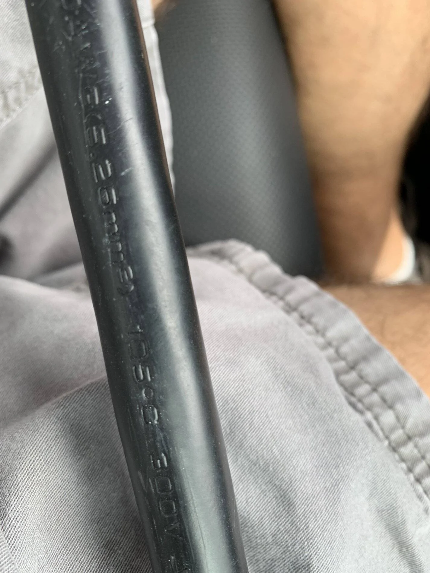

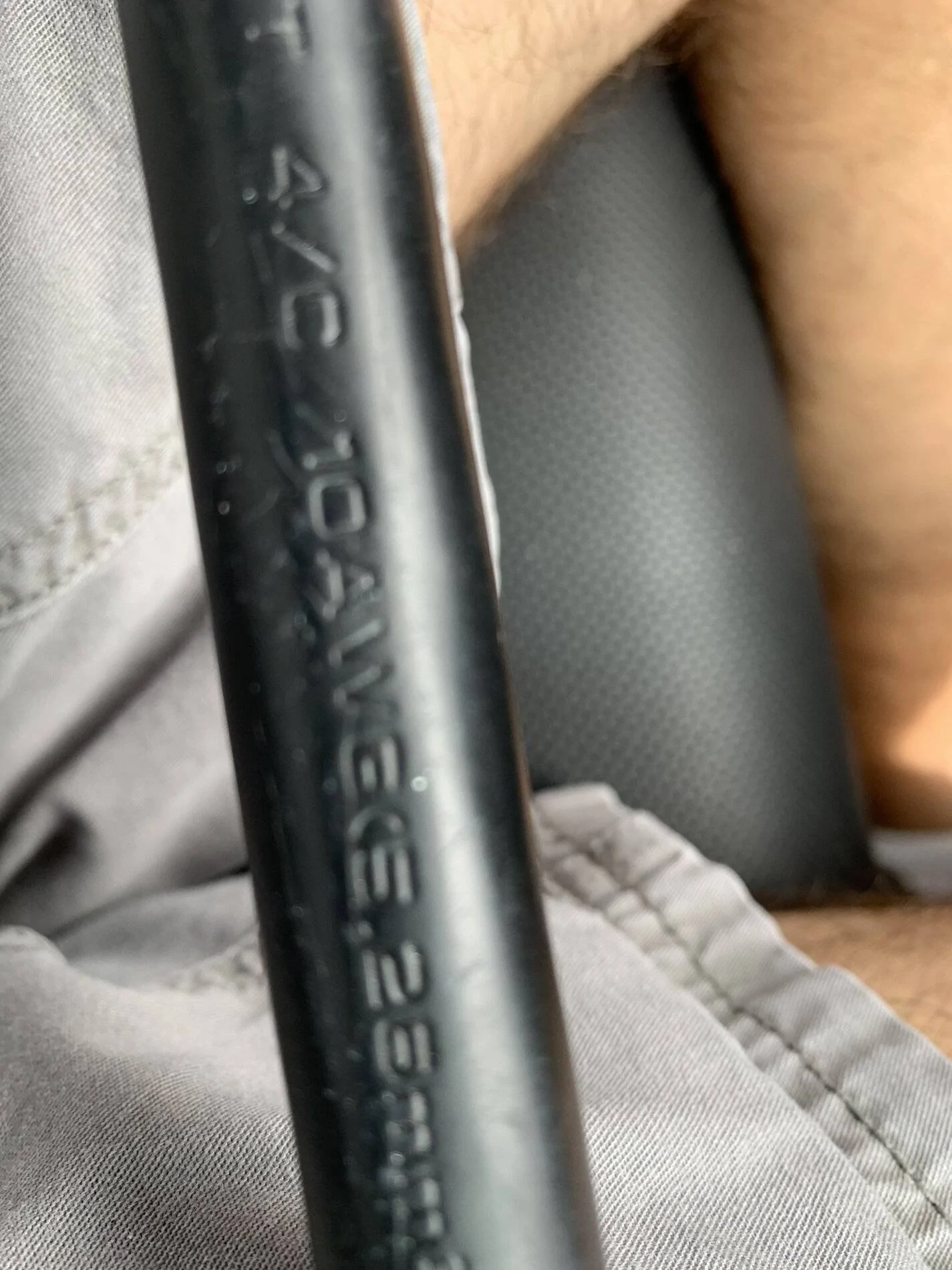

So I have researched and found detailed information on this pigtail cord heating problem.
it is concerning. If you look closely at the cord, it has an Underwriters Laboratory stamp of approval and code number in several places.
Looking up this information at UL, the plug, one end of cord, and cord itself are made in various places (Romania and Taiwan). The components are then assembled somewhere.
The UL numbers when searched state the maximum load on cord is 30 Amps continuous. The plug that goes into charger is 40 Amps. That is why cord at 10 AWG is getting way too hot. Pulling 40 Amps through 30 Amp rated cord.
This is mandatory safety recall IMO.
Some light reading for you: https://www.taycanforum.com/forum/threads/nema-14-50-supply-cable-heat-data.1940/
TLDR: The 10 AWG cord is not optimal at 40A, but it is electrically safe.
this is outstanding information - and if true I agree if UL labs does not rate the cord for 40 amps continuous that would be a safety issue - posting that information here however does no good.
have you contact Porsche North America about your findings and provided the documentation from UL labs.
we’ve always known 10 gauge wire is a bit iffy for 40 amps continuous load - I’d like to see Porsche/Audi/VW update teh cord to 8 gauge wire for their EV fleet - it’s really really substandard.

Yes there is open case with Porsche NA, and the dealer. And as to safety, the rubber on my cord partially melted. No one should use this at anything over 32 Amps (technically that is even too high), especially unvented Porsche enclosure with lid closed.
