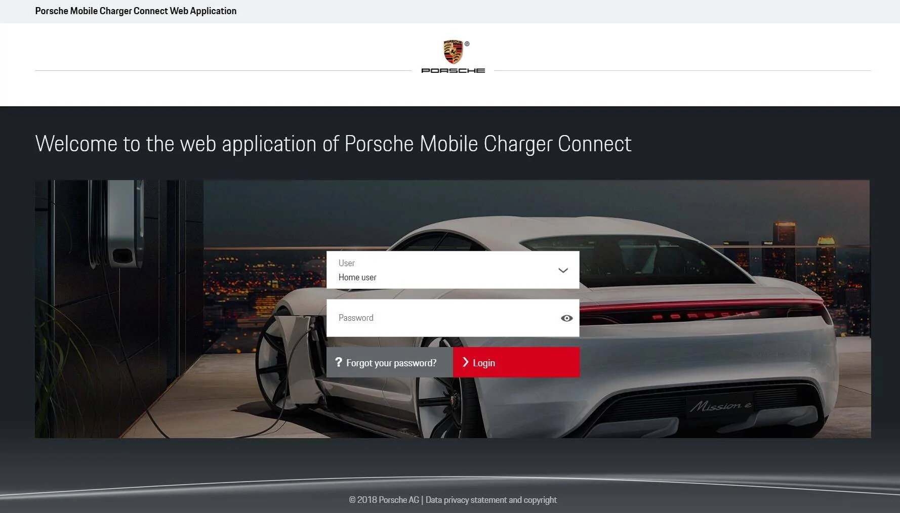

The IP address of your PMCC is available from the PMCC directly (if you can't easily figure it out from devices connected to your router). On the PMCC go to Settings then navigate to the second page and select Networks and then Network Information where you will see your IP address.
From a browser (Safari / Chrome / other) type in the IP address and accept the messages displayed (browser may complain "Your Connection is Not Private" that it is not a trusted site but click "Advanced" and then "Proceed" (if using Chrome)) where you will be presented with a logon screen similar to:
Porsche Taycan PMCC Software Update This Morning 1614508458268
There are two user accounts which you can use - Home (default) or Customer Service (Tech) - and the passwords for each are printed in the letter / envelope you got with the PMCC.
Proceed as user Home.
Porsche Taycan PMCC Software Update This Morning 1614508743040

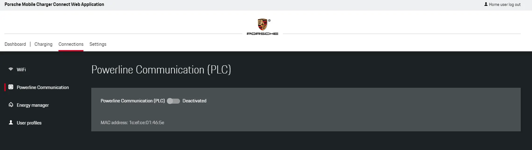

Have a browse around but one key item to check is located on the Charging tab
Porsche Taycan PMCC Software Update This Morning 1614508820761
Given the TSB (Technical Service Bulletin) and reported association with 12V battery drain issues it is important to disable the PLC (Power Line Communication) function (unless you are dependent on this for connecting to your home network) and simply rely on WiFi for connectivity.
Also look at the same tab with the Customer Service (Tech User) account as the main override is located here.

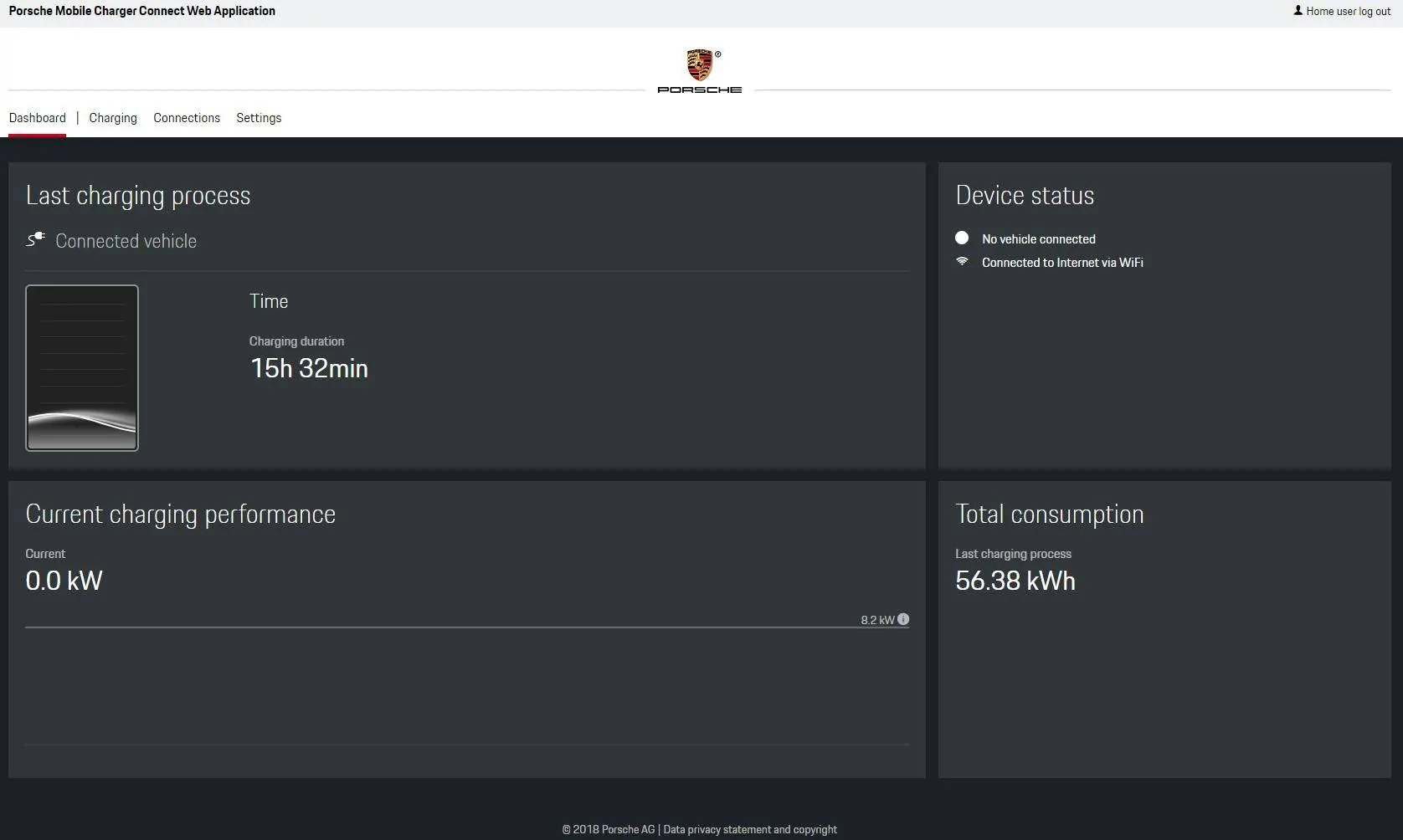

I don't think you can access these options via My Porsche and possibly the current charging stats graphics are better.
Configuration of the PMCC can be performed from this interface also (remember to wake up the PMCC from sleep before attempting to connect to it) which may be easier than via the touch panel.
