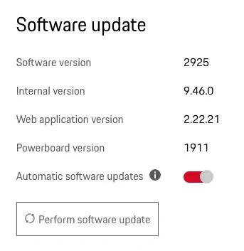

ok mine is now updates - 2925 - no apparent changes - and the minimum amps is still 6 amps - LOL - Porsche a known issue with charging that slowly that drains the 12V…
I'll dig around in the web UI and see what else I can find, but so far nothing dramatic appears to have changed.
Porsche Taycan PMCC Software Update This Morning Screen Shot 2021-02-26 at 9.39.29 AM

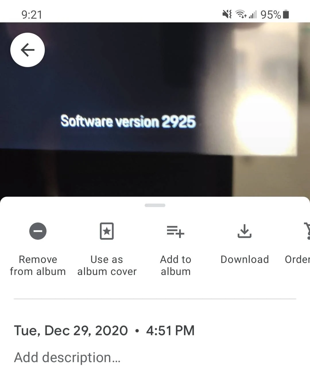

version 2925 is NOT new. See attached a photo I toom on Dec 29th showing version 2925.
My car was mid Sept build and I leased in end of Nov. I believe 2925 was the version PMCC came with.
This version certainly does not fix the 12v issues since it has PLC enabled by default.
Has your 12v battery ever crashed ever since Dec 29? If yes, there's one theory out the window.

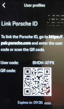

Got a PMCC software update this morning. If I hadn't been standing beside the charger, I wouldn't have seen it. Wonder what it's for? 12V issues?
Mine updated as well. Had not used mine in a couple of days. Have the unit since late June when the car arrived at the dealer. Was able to get the charger while they performed PDI, so that I had it installed at home when they handed the car to me two days later.
feye
Sep 16, 2019
2,411
1,871
Shenzhen, Munich
Porsche Taycan 4S+ 2020
Porsche Taycan PMCC Software Update This Morning 1614393370748
Has anybody linked the charger? Does it then work with Plug & Charge when PIN code enabled?

i can try - but you might need PLC enabled to do that - and porsche says turn it off to avoid a know 12v issue - also unclear if you need 2021 MY for that
but my PMCC is linked to my porsche id - so far all it seems to get is charge history data on login.porsche.com

OK, so it should work! Thanks!
I tried again to link my Porsche ID today. First with the old version and it failed as before. Then the update for the PMCC came. With the new version it failed again but with a different message. Something is wrong with my phone or Porsche Connect.
