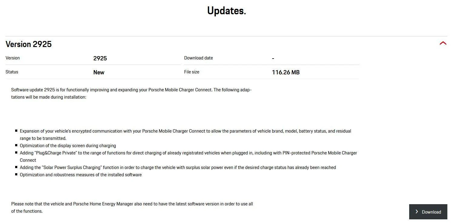

Really difficult to say since there are no release notes available? At least I hve not been able to find any. Seem to indicate some new features to come though.
Not being able to crosspost I share the screenshot I have documented in another post. These are the changenotes from Porsche website

@elberk , thank you. Had not found those notes. Where did you find them?
The footnote indicates that the car also needs to have been updated to the latest release though. Hopefully that will come soon.
When downloading the Update image for offline update from Porsche website, it presents the change notes. Strangely enough, when your device has updated via OTA already, the website will deny you the file and info. So you have to be creative to enter a serial number like 0012345 and hope that it wasn't updated already.
And yes, I heard there is a car update campaign planned end of March, which possibly corresponds to some of the listed features.

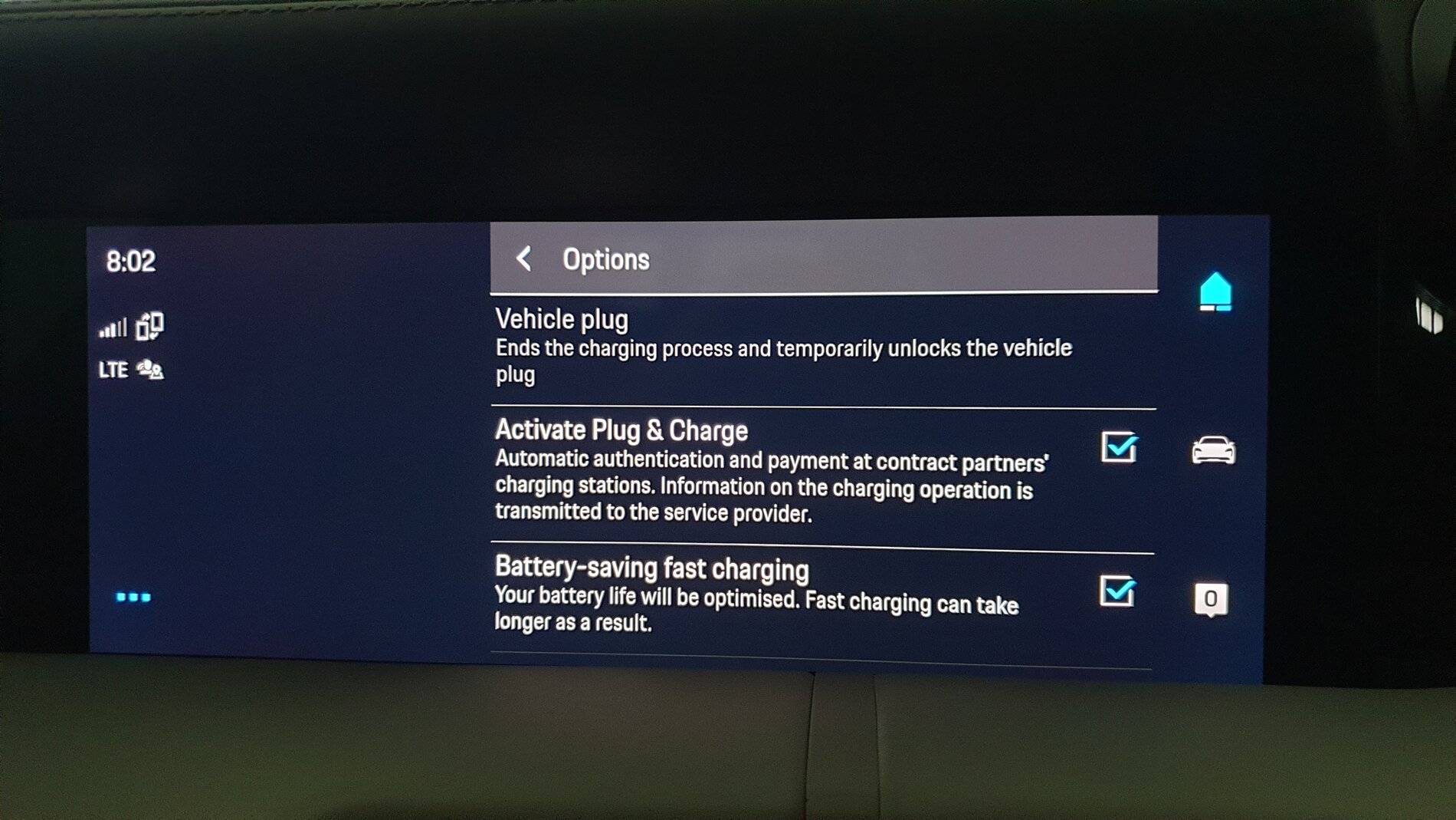

can you post a screen shot of where in the PCM (Taycan main computer) you enable this?
I can't find it on my North American Taycan, but may not be looking in the right place.
This may be a MY21 feature but look within the Charging menus or within the Vehicle settings.
Sorry I can't remember which menu precisely but it's too late in the day to go check - can do in the morning.

Plug and Charge is for now only on MY2021s. But thanks @W1NGE for confirming there is indeed communication between the two. And you confirmed that communication ceases if you disable PLC between the PMCC and vehicle in the PMCC service menu set-up? If so then we are stuck with a trade-off - disable PLC between PMCC and vehicle to reduce the risk of 12V battery death but loose some of this functionality, or keep it enabled and live with the risk...

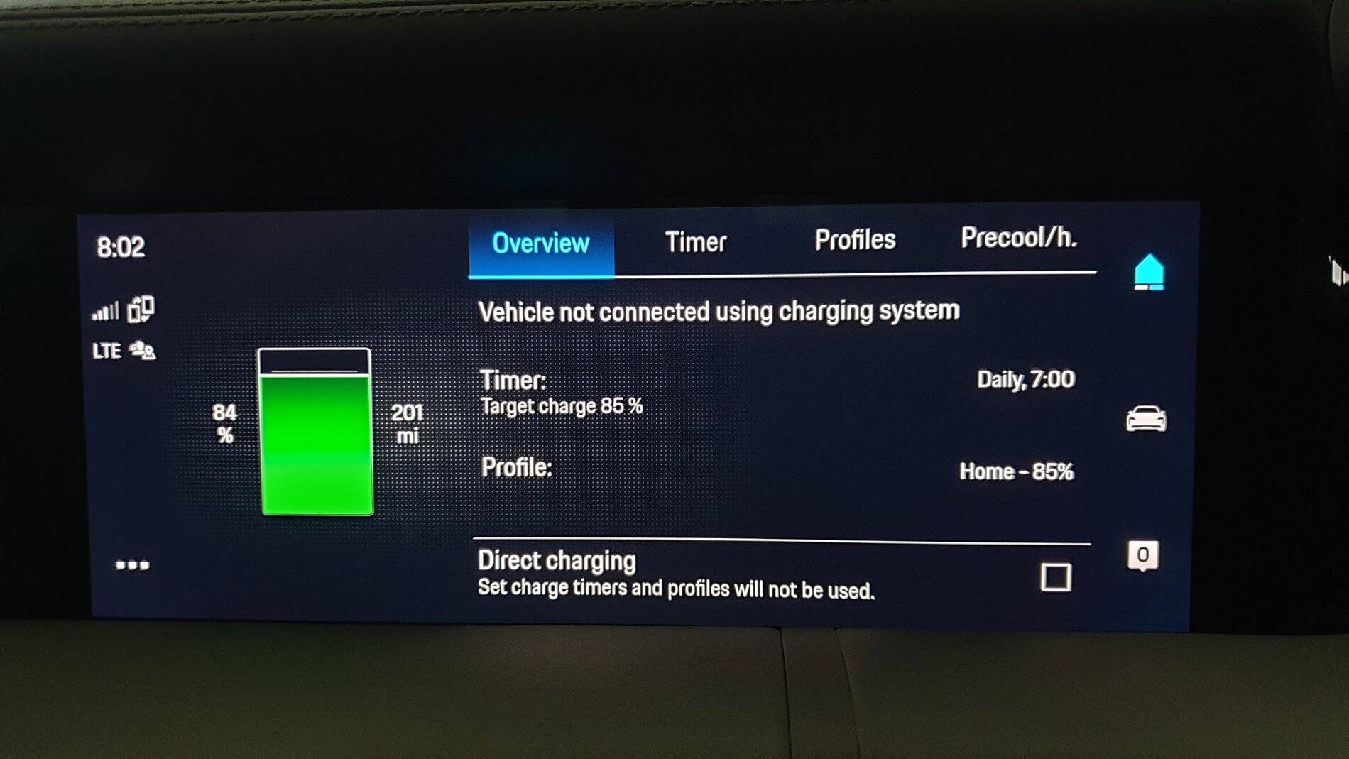

The option to activate 'Plug and Charge' is embedded in the sub-menu of Charging:
Porsche Taycan PMCC Software Update This Morning 20210304_080250
Porsche Taycan PMCC Software Update This Morning 20210304_080227
I can not find this either! It is probably a MY21 feature?. I have been searching all over the PCM but no luck.
Pity I would have loved to try that else.
