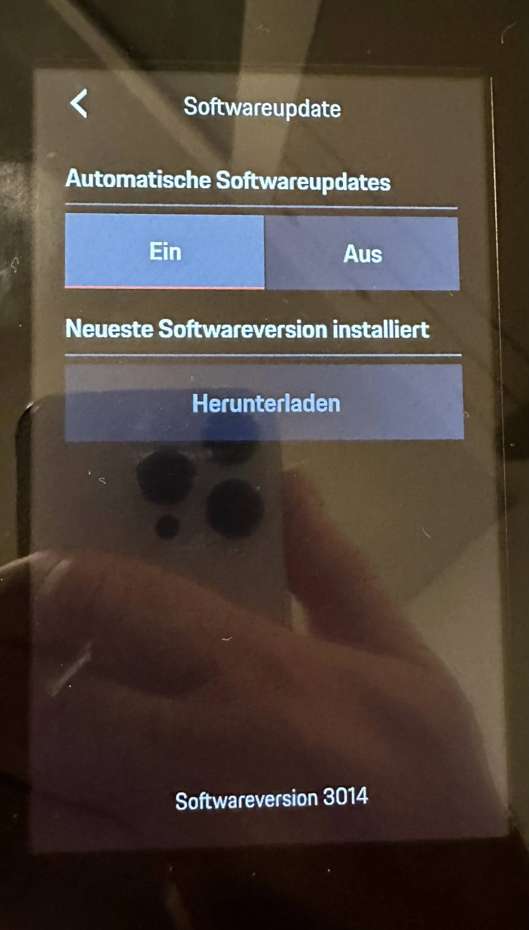

PMCC software update this morning??

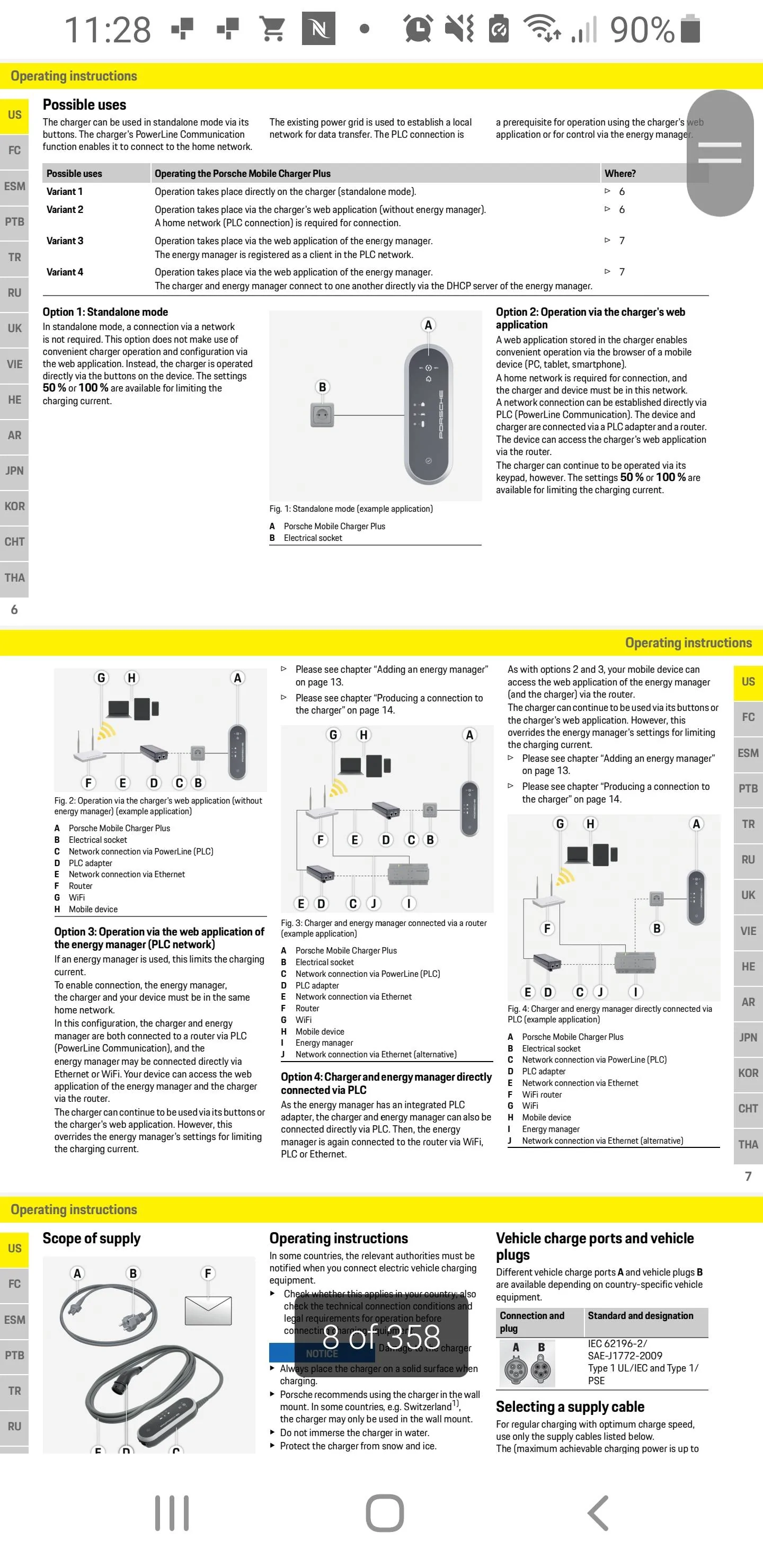

Thanks both, @AndiL and @W1NGE; the PMC+ manual indicates it's possible to have it controlled by a "charging manager" when connected to a network - which I assumed to mean I can program a charging schedule or control charging remotely. I was wondering how that worked, given that PLC works within a circuit.
I originally thought I'd stay with the PMC+ for a while before looking into a "proper" EVSE, but given what I read elsewhere on this forum, the PMC will likely stay in the car as a travel charger.
Charging is controlled by the car (timers and profiles). Management is via the PCM, My Porsche App or My Porsche website.
PMCC or PMC+ don't provide any charging session control.
Both have a web interface to make config changes and to view stats etc.
You can introduce a Home Energy Manager (HEM) into the mix via PLC which may be of interest but aside from that there's no great need to be networked.

With PMCC charging via timers (in the car) can be optimized using an energy manager (Porsche HEMS) to charge optimized with costs as you can enter your tariffs in the energy manager web interface. You can NOT defined charging timers etc. locally via the web interface, you still need to do this in the car or the Porsche app.
This does NOT work with the PMC+!
11,078
6,858
HEM supports PMC+ as well as PMCC.
Page
Porsche Taycan PMCC software update this morning?? 20221015_112927
Porsche Taycan PMCC software update this morning?? Screenshot_20221015-112852_OneDriv
