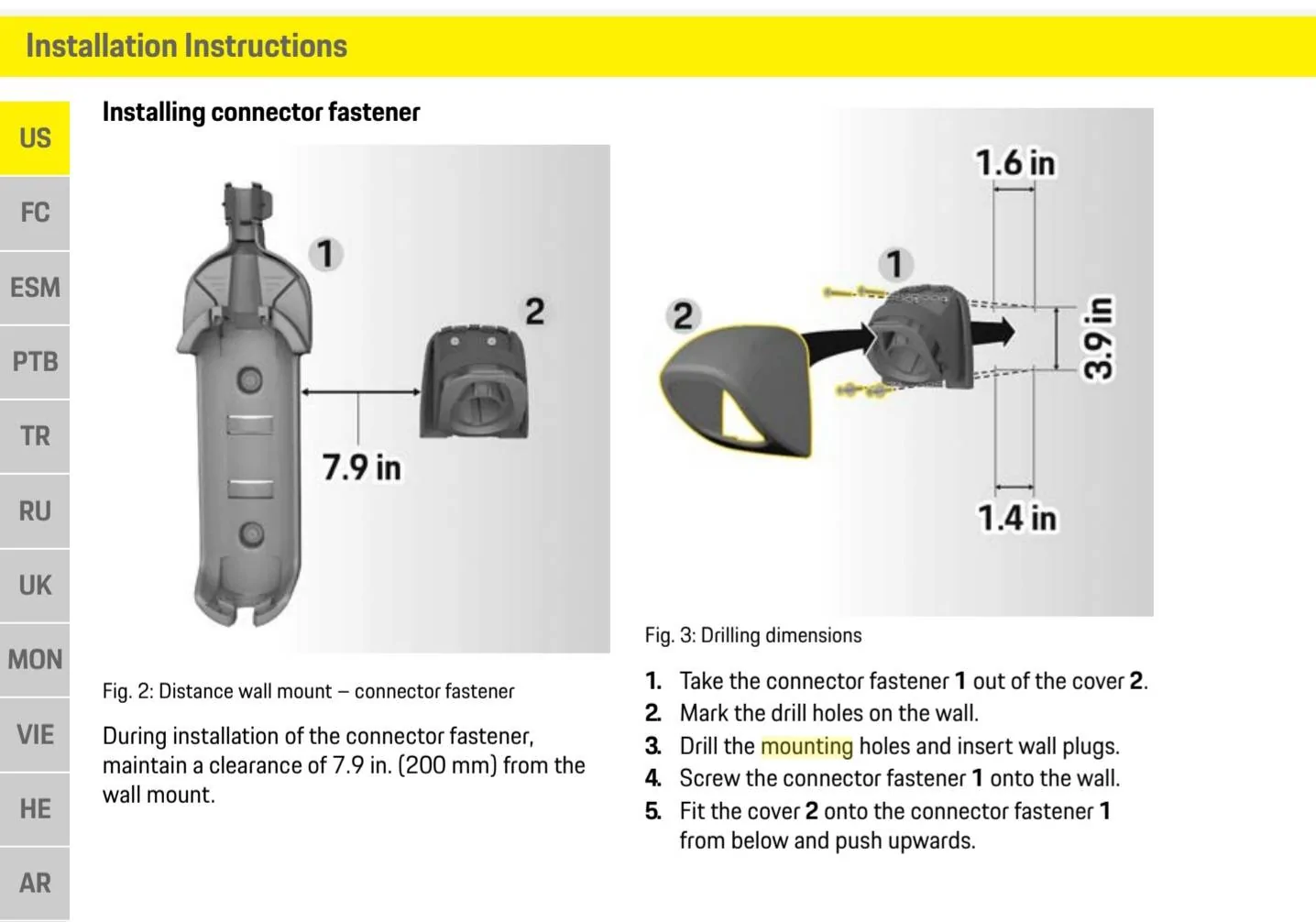

You don't get the wall plinth for the PMCC as standard, well not in France. This is an accessory option. I have it on order.
The subject is the PMC+ - I'm guessing the basic wall mount is bundled.
4,777
8,364
Mine, delivered last month in the UK, had the basic wall mount kit bundled with the unit.
The picture shows the PMCC mount unless I've ordered the wrong one.
Have they change the spec then. I certainly got the wall mount included with the PMCC in 2020.
and the manual describes it as well.
The simple wall mount was included but the big dock was some 400€ extra?

Just to clarify, I'm aiming to use the basic PMC+ that ships with the car (as opposed to the upgraded and more costly PMCC). Looks like the budget mount ships with the basic PMC+ (which will be fine for my needs).
That's annoying then as I ordered the wall mount and negoiated it free included in the price I'm paying. I'll need to get another accessory free of charge or keep it as a spare so I can mount it in other locations.
11,102
6,871

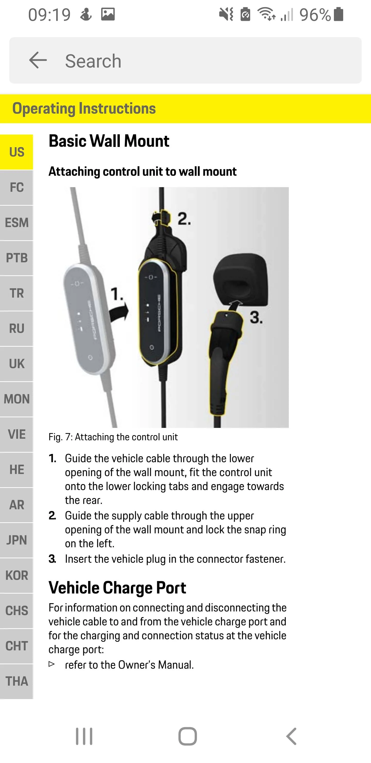

I posted 2 pictures from the PMC+ manual.
The base mount is provided as standard which would more than suffice.
The other mount supports both PMC+ and PMCC I would assume but check the manual.
thanks I must have this one one order then
