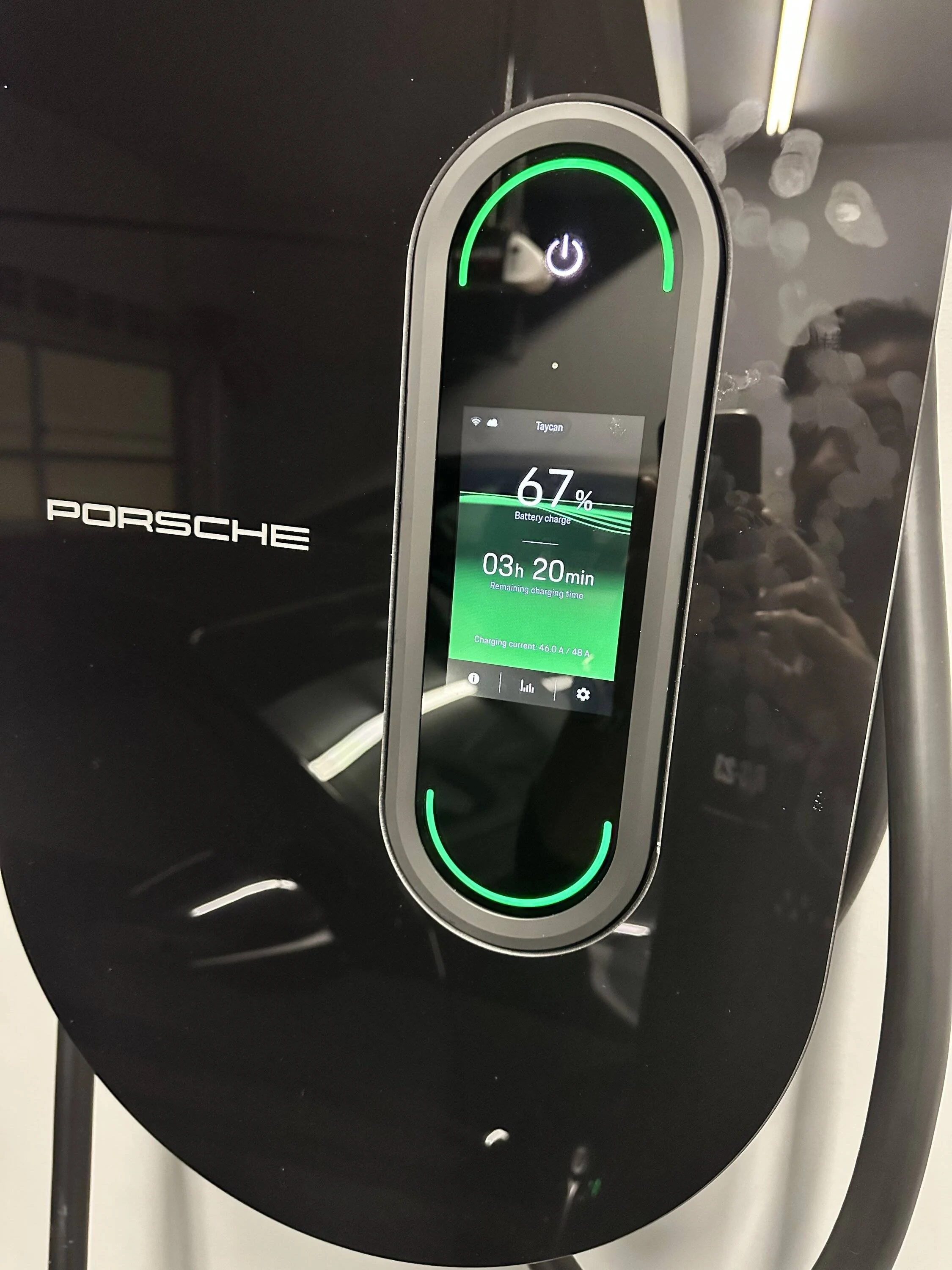

quick update. After watching few PMCC videos (as no PWCC videos) on YouTube, I skipped the pairing and went straight to next page. It’s connected Tk my Taycan and charging. Though I would love to pair with my Porsche ID, I think this is good enough for now.

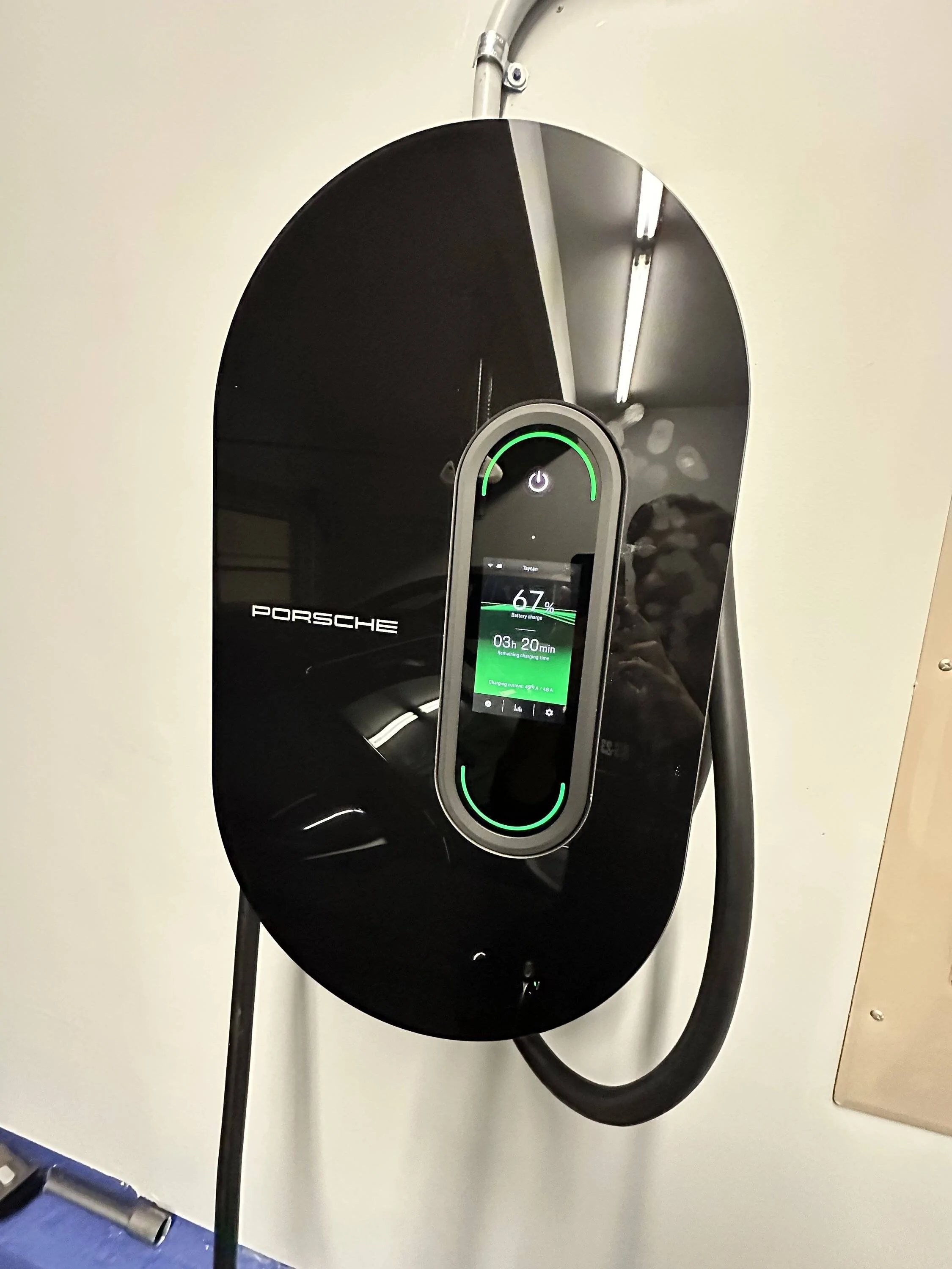

Did you add a 100 amp breaker in your main panel then run the line directly into the wall unit? Most people run to a sub panel then to the wall unit. I am planning to run mine the same way you ran your unit looking at the photo's.

I just ordered the same 19.2 kw wall unit. I plan to add it to a beach home I have as there is currently no charger stations in the area for at least 35 miles away. Plenty of level two but no high speed should I need a quick charge.
This unit will do the trick should I ever need faster charging. I plan to install the unit myself as it's a pretty straight forward install with the unit being within two feet of my main service panel. I will post my experience once I get started.
I added the 100A breaker directly in the panel rather than a sub-panel.
One issue you'll want to consider is that 2 AWG wire is very stiff, so although the wire entered on the right side of the panel, I needed to route it across the bottom of the box to tie it into a breaker on the left side.
Also, be sure to follow the torque guidelines to the best of your ability. You don't want any oxidation to build up on the breaker connectors (although this is less of an issue for copper).
Thanks for the insight, my plan was to buy single 2 AWG line to make it easier to work with. In my case I will put a 100 amp breaker in my main panel then run three separate 2 AWG lines (2 hot and one neutral) then one ground. This should make it more manageable to work with such heavy wire.
For a US/North America installation you don’t need three 2 AWG lines, just two. Also, the ground wire I used was 6 AWG since it doesn’t carry current during charging. You should check with an electrician of course.
Thanks Sam so you don not need the nurtural line then. Makes sense as most 220 v hot tubs are wired that way.
