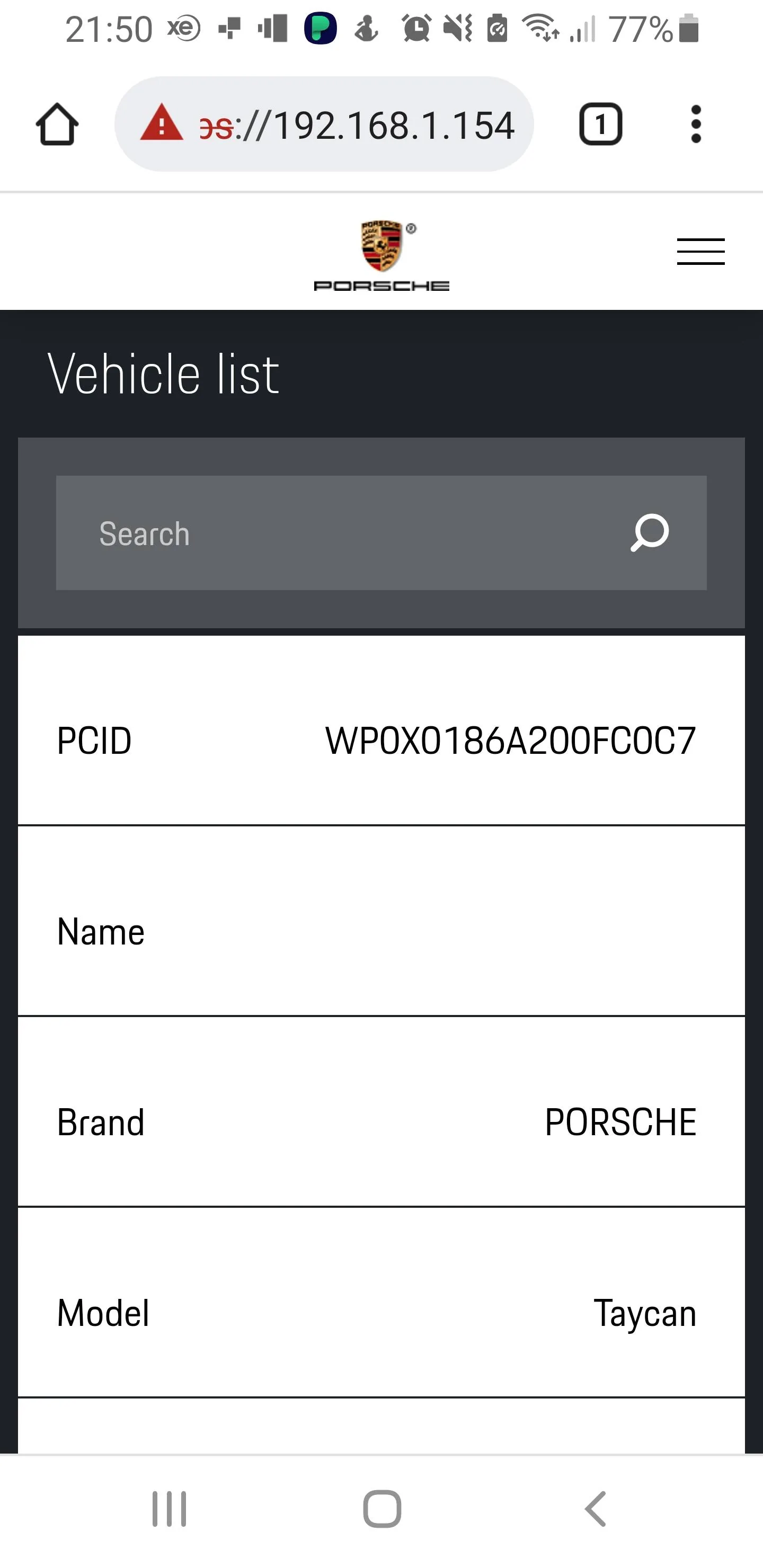

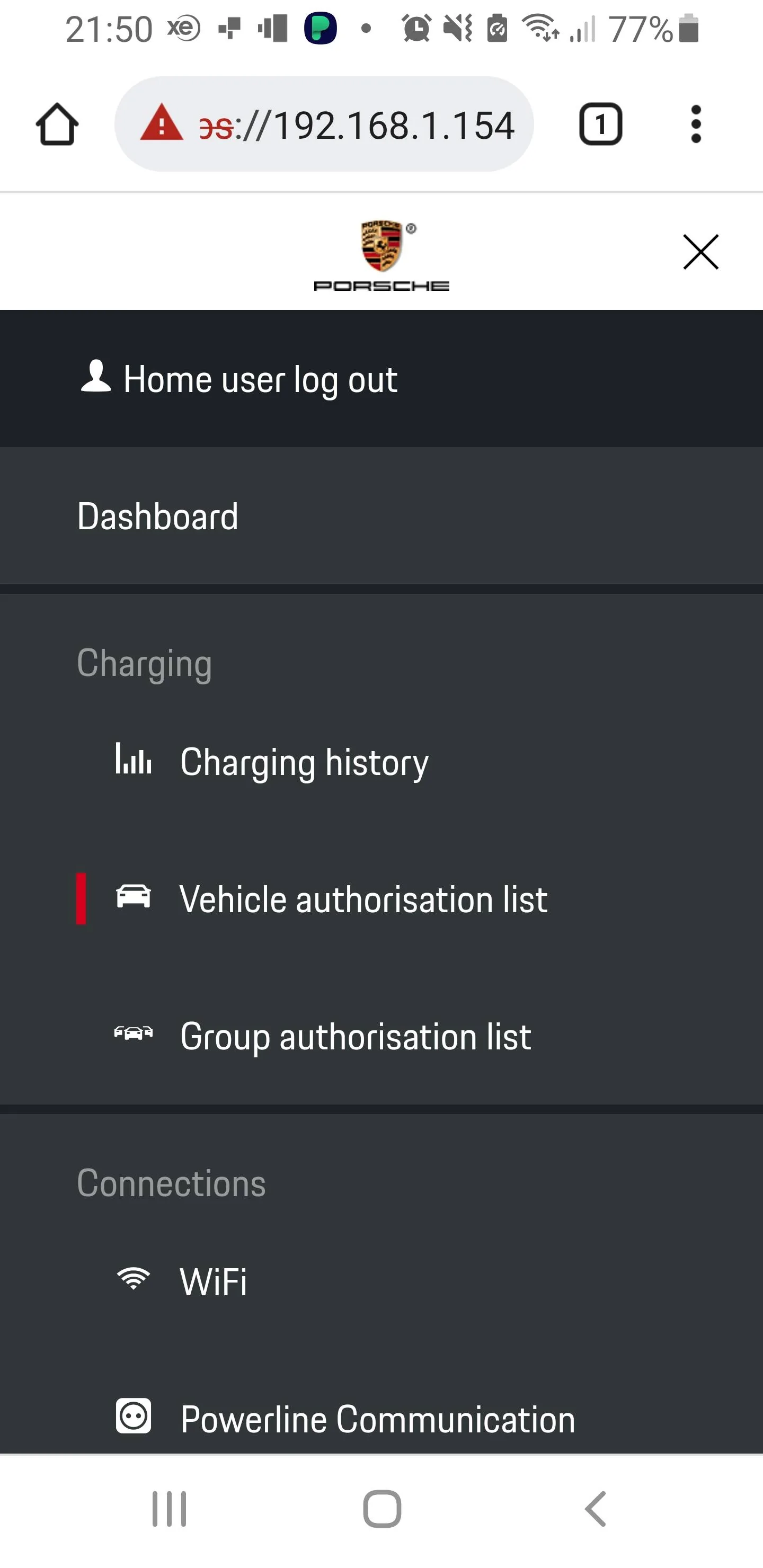

I know all of this (of course) but I had to add my car's PCID as an authorised vehicle. PCID is provided by the car on connection. Suspect Audi, Seat, VW do the same.
Just a thought
Porsche Taycan Porsche Wall Charger Connect | Unbox & Install Screenshot_20221207-215012_Chrom
Porsche Taycan Porsche Wall Charger Connect | Unbox & Install Screenshot_20221207-215023_Chrom

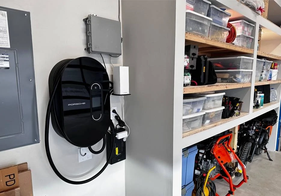

I have been very frustrated with the PMCC and wanted to change to another EVSE, but I also wanted the 80A capacity for a future 19.2KW charging experience.
I looked at wired alternatives but they were both somewhat clunky looking (IMO) and pretty pricy (e.g., the ClipperCreek CS-100 is $2,195). When the PWCC came out with a special price of $1,339 (shipping included and a free return if I didn't like it) I decided to give it a good look, and came away feeling that it would be a good choice. There was a bit of "leap of faith" here though, given the poor PMCC quality, but there was a free return option so what the hell?
Of course, after I ordered it I read some posts on this thread that indicated that it might only work with Porsche vehicles, and I was concerned that if that was true I had screwed up (more on this later).

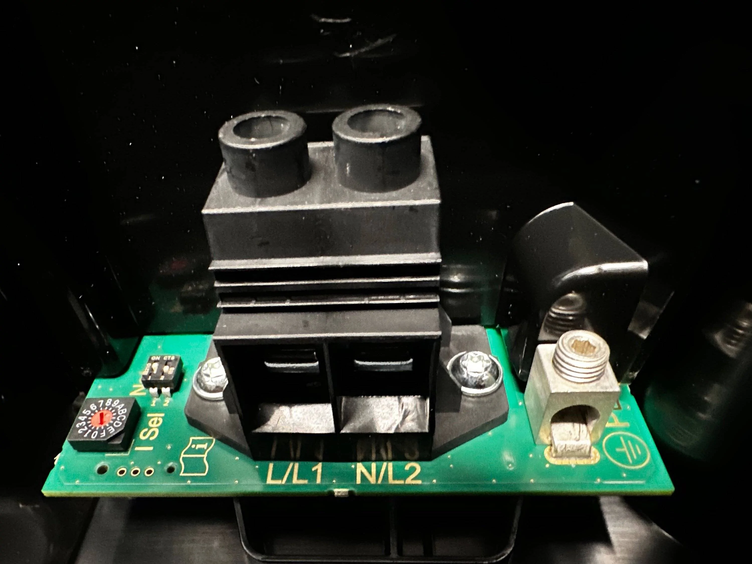

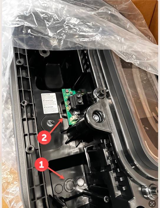

The PWCC arrived and the unboxing experience was the same as described by @satchurator. I'll share just a couple of pictures that might be of interest to others. I decided to not use conduit since the PWCC is only 16" center to center with my distribution panel. In the picture below #1 points to a spot where I drilled to open up a hole for power entry, and #2 points to the wiring connection to the PWCC electronics. We used 4 AWG wire for the two hot lines and 6 AWG for the Ground.
Porsche Taycan Porsche Wall Charger Connect | Unbox & Install Inside of PWCC 2022-12-22_12-26-34
Here is the connector in #2 above up close. On the left side is the selector switch to choose the breaker size, and the DIP switch to select the power source type.
Porsche Taycan Porsche Wall Charger Connect | Unbox & Install RenderedImag

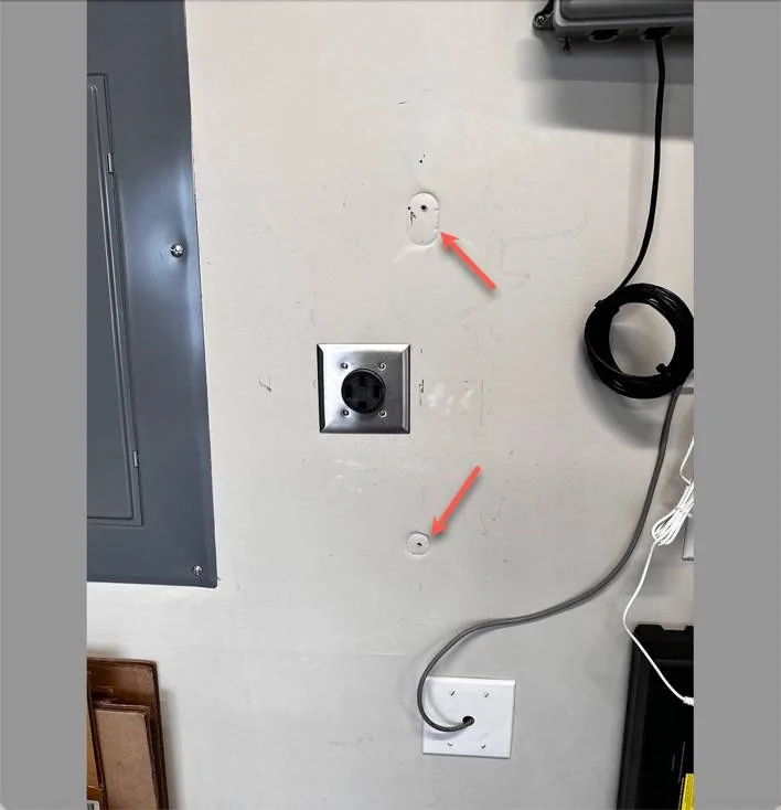

I also decided to use the same mounting holes for the PWCC as I had used for the PMCC.
Porsche Taycan Porsche Wall Charger Connect | Unbox & Install Existing Holes 2022-12-22_12-31-34

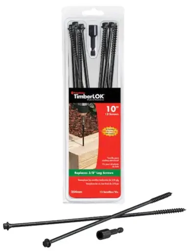

One difference was the need to use 10" fasteners and I opted for TimberLok (Home Depot), and I only used two for the stud mounts.

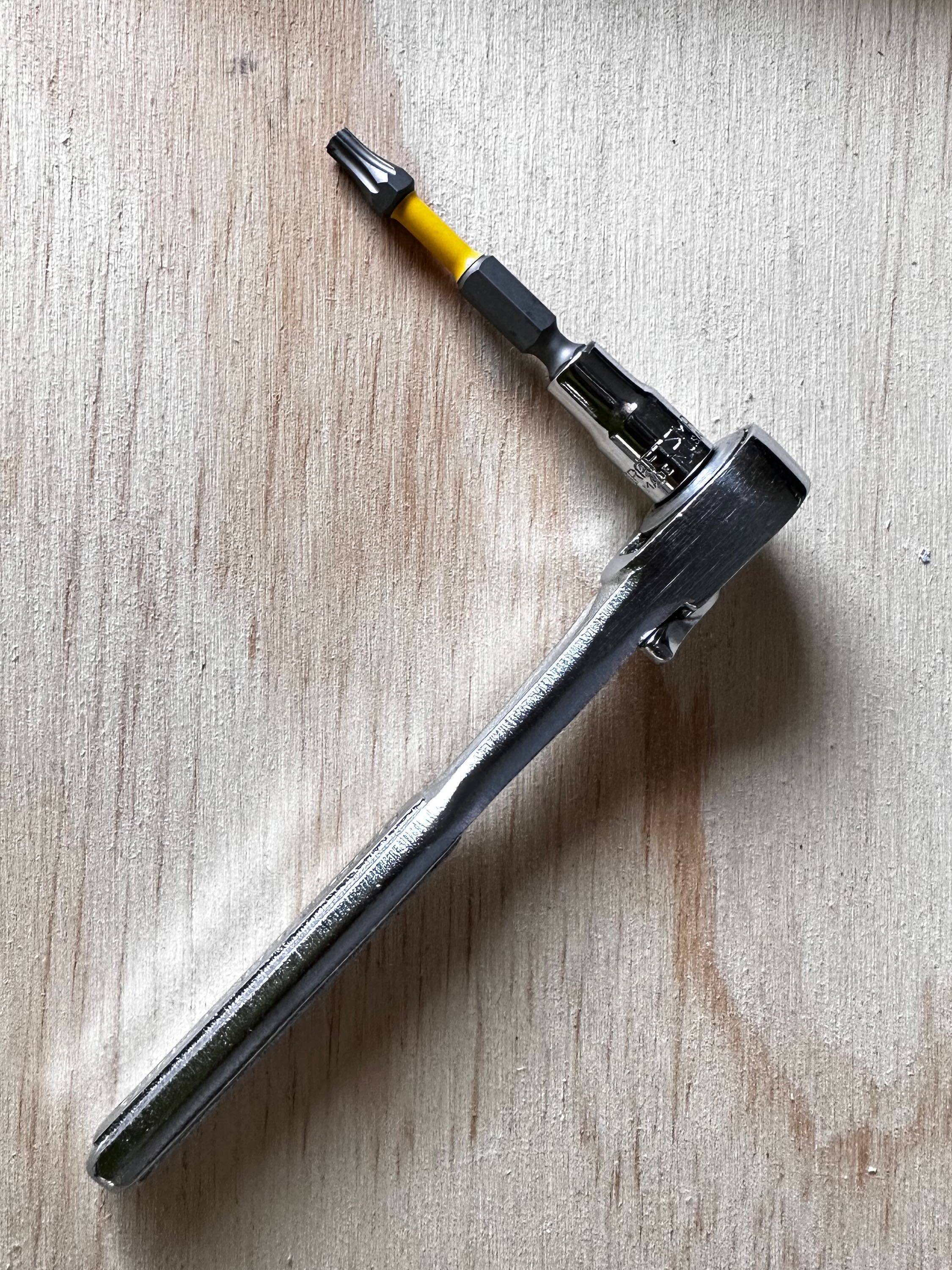

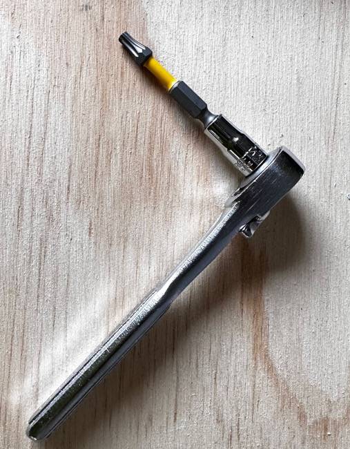

@spicyypenguin mentioned the difficulty of attaching the front cover, and for that I used a T25 Torx head and a 1/4" socket wrench. The Torx fits in the 1/4" socket fits perfectly, and it is short enough to allow for screwing from the backside of the front cover.
Porsche Taycan Porsche Wall Charger Connect | Unbox & Install IMG_6263 (1)

  • The setting of the unit is for a 100A breaker (Switch Position F), and DIP switch setting for 240V split phase (standard NA power).

P.S. @Administrator - I've tried deleting the duplicate picture of the socket wrench below several times but it won't stick. Can you help me here?
Porsche Taycan Porsche Wall Charger Connect | Unbox & Install Socket for T25 - 2022-12-22_12-33-54
