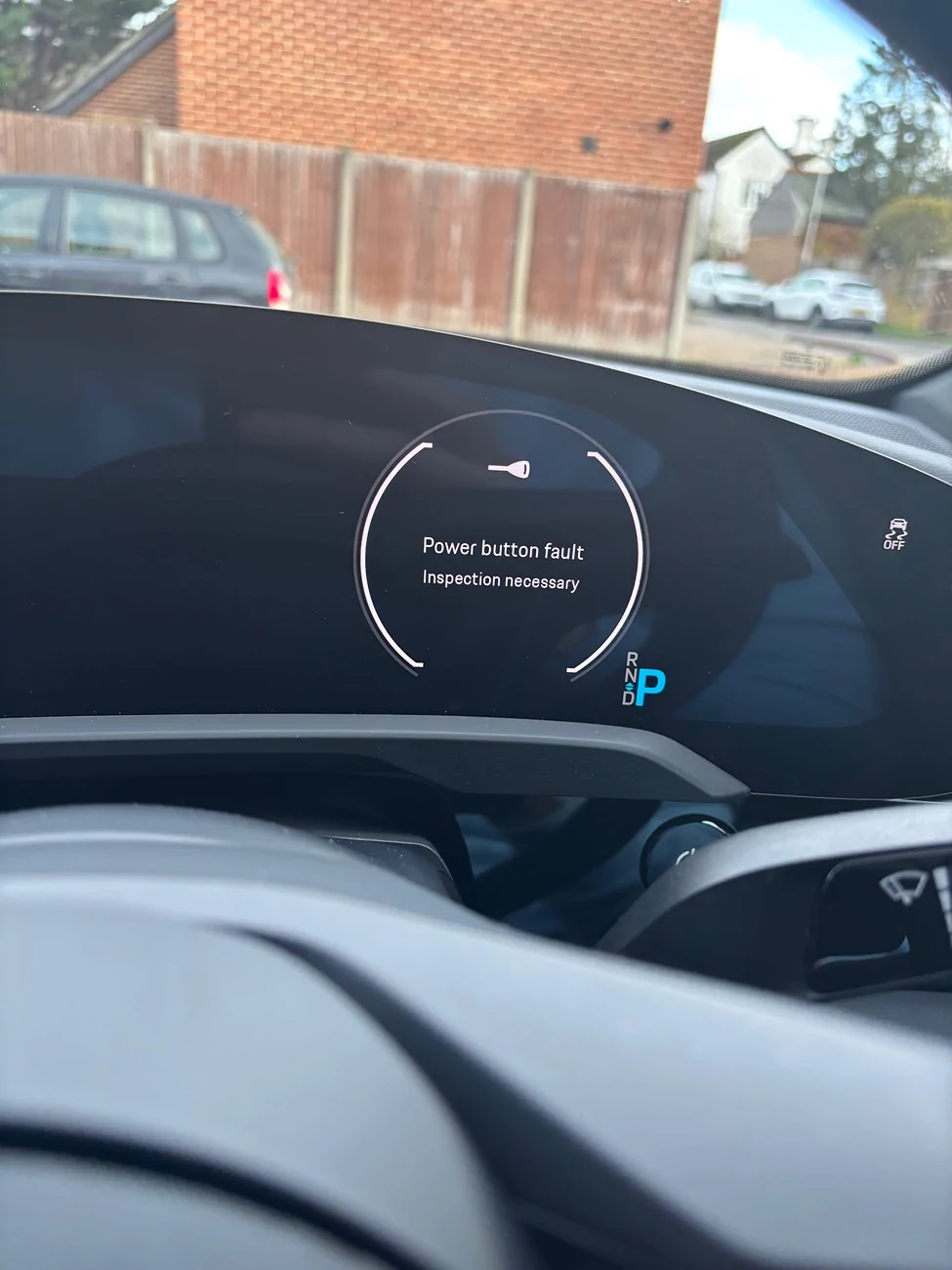

Power button fault - car won’t move

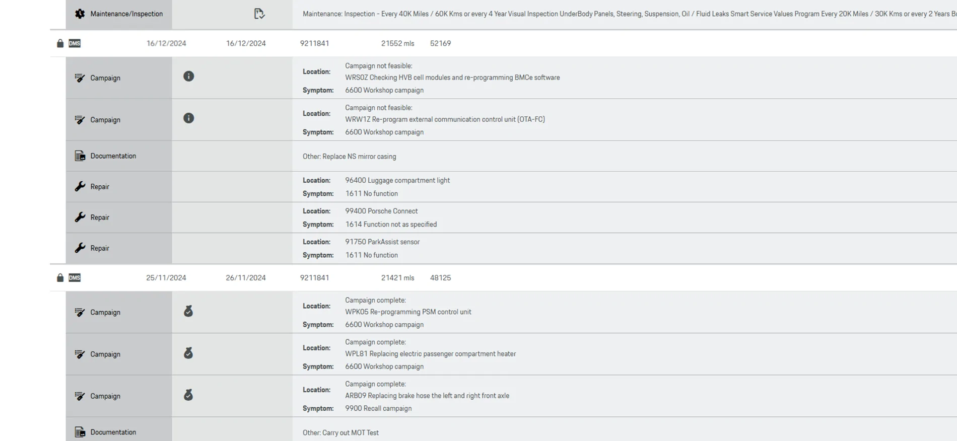

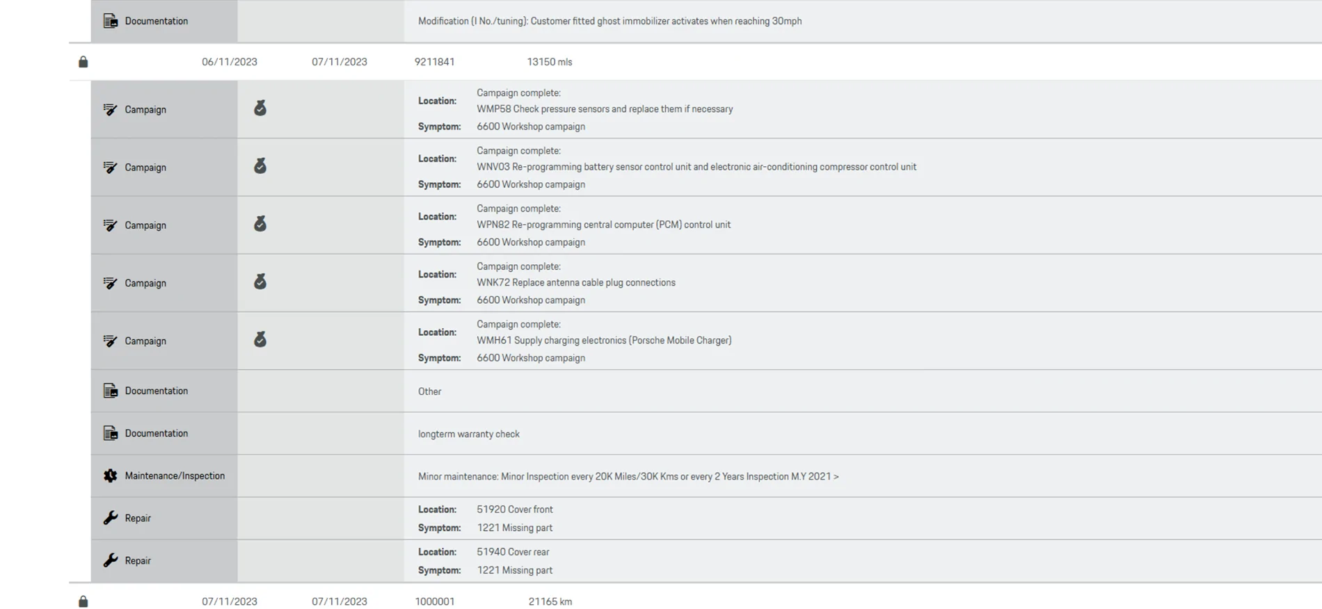

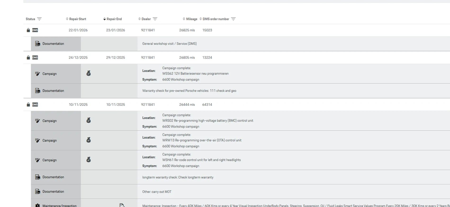

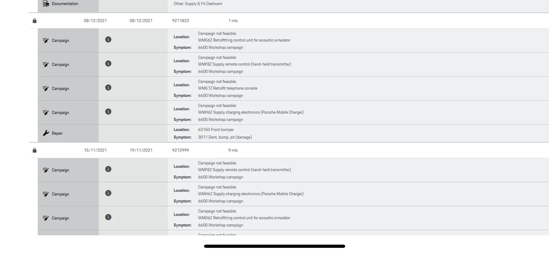

So to update everybody on this It was a ghost immobiliser that they didn’t remove. Even though it’s noted on the service record. They said despite their checks, nothing indicated that it was there. Does make me question the 111 point checks.
In my CPO report, at least the tire measurements were way off... up to 2MM. It makes me wonder how far off the other measures are and what they really check.
