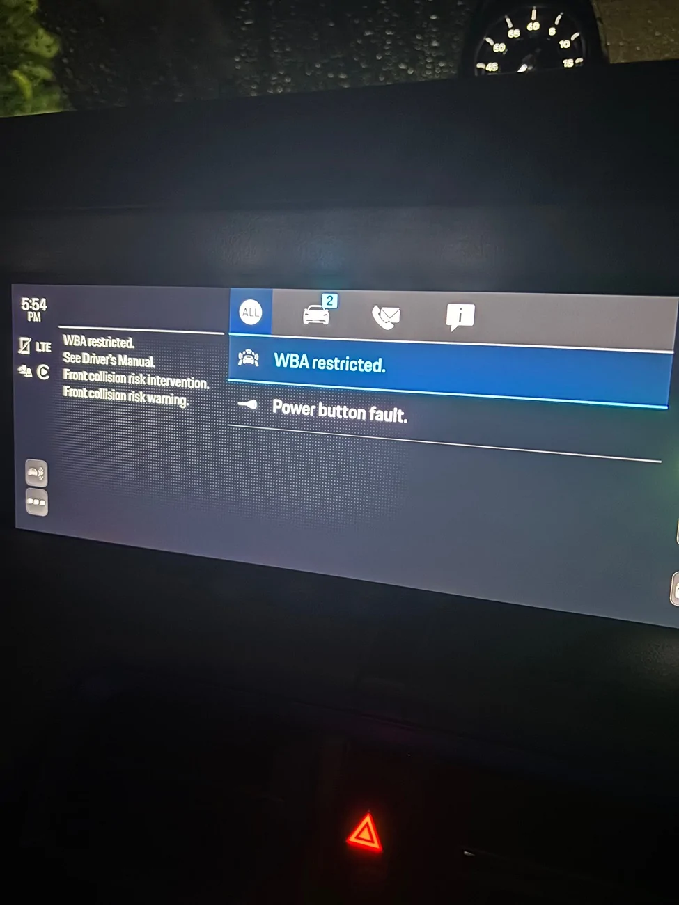

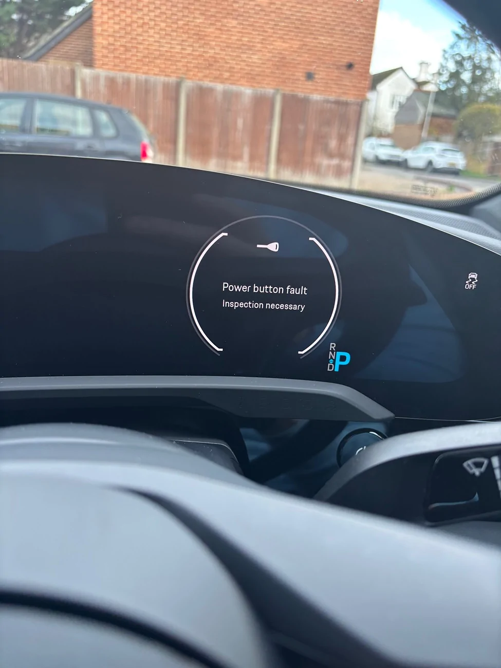

So today I picked up my approved Porsche Taycan from a dealer. I’ve driven it all of 22 miles parked up on my drive went through some settings and then wanted to park my car better on the drive and it won’t move. I get a number of error messages, including power button fault inspection necessary. If I try to put the car into drive, it will move forward half a foot and then stop.
I’ve had the AA around via Porsche assist to check the 12 V battery as I thought that might be an issue because it’s been in the dealer for a month or so without being driven. However, this seems fine at 13.5 V and they charged up and they still had the same issue.
If I remove the driver assist errors that pop-up as well only the power fault button shows but as soon as I put it into Drive or the other Message come back and headlights keep resetting. I have left the car off for 20 to 30 minutes come back still the same problem.
It’s not a great start to Taycan ownership! The car is clean the sensors and cameras are all clear so I think it’s some kind of major electrical fault.
Unless anybody’s got suggestions?

Power Button
I had this error in May 2025. My Opc did’nt find anything and reset the Error
Same thing last December so after controling wires and connectors they ordered a new Power Button and changed it.
It’s a known issue for some Taycans
