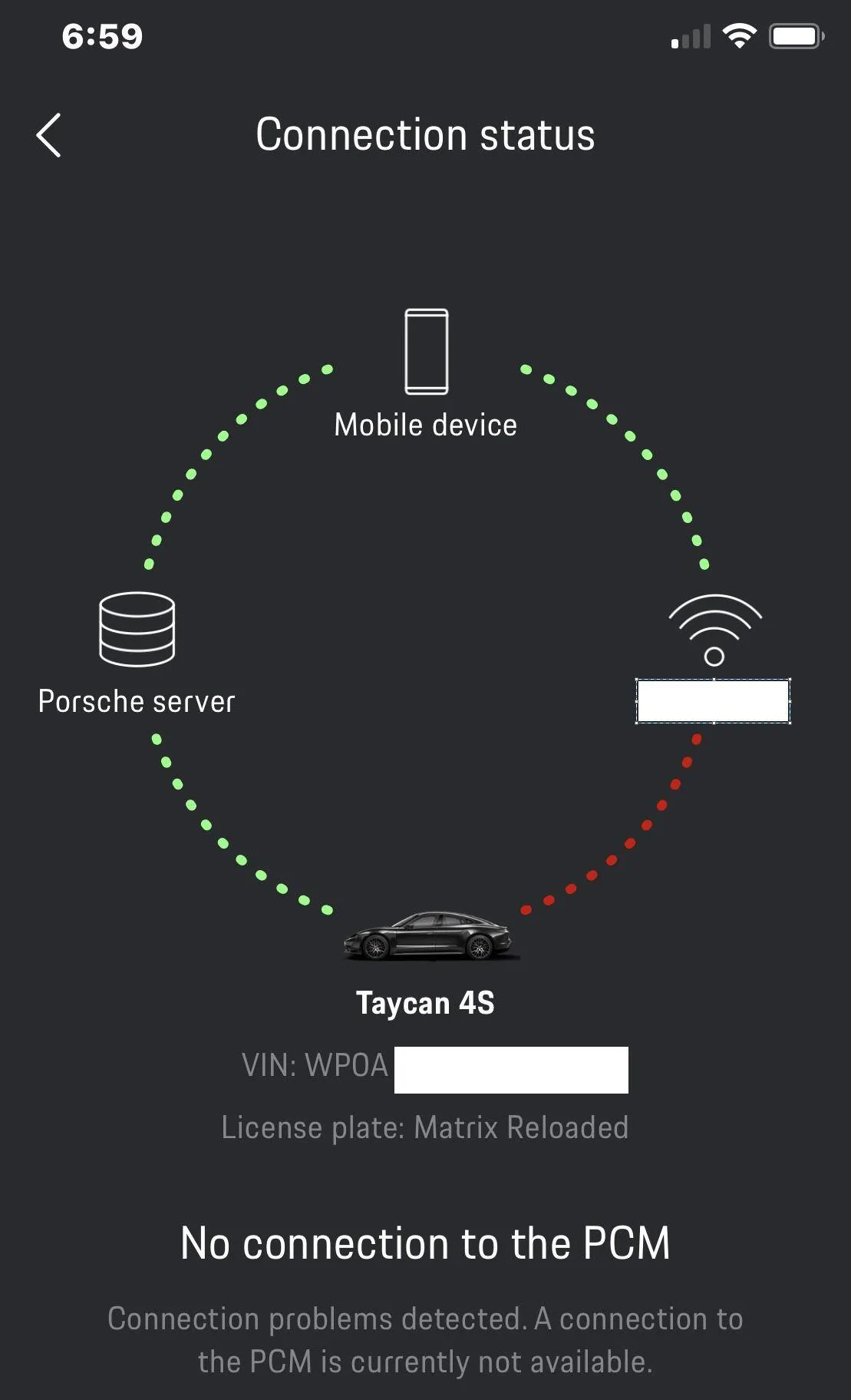

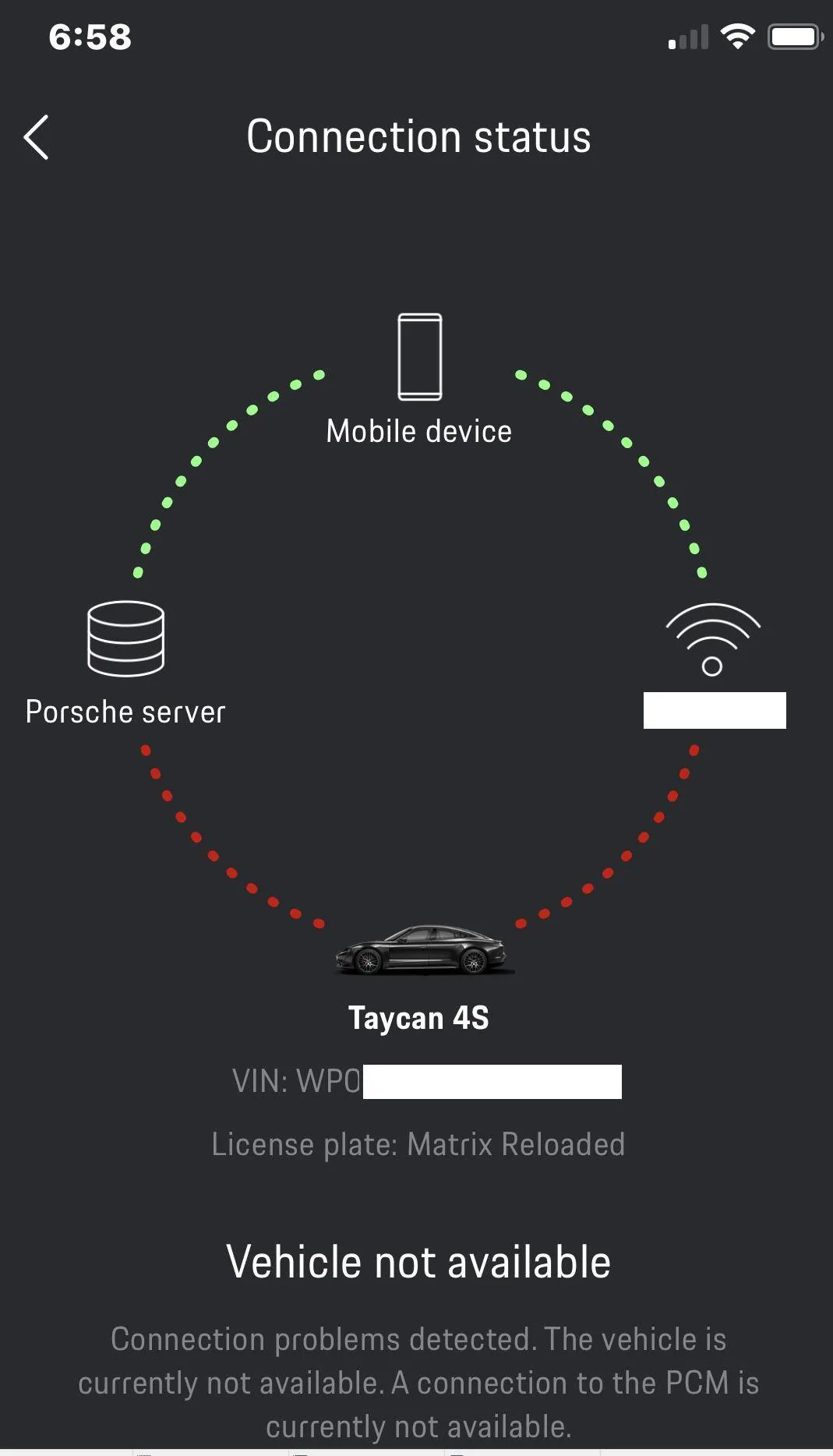

The red dots disappear when your phone has a connection to the Porsche server, and the server a connection to the car. Sometime you may not have an LTE connection from where you park (for instance in underground parking). Picture below - see also my post here
This is at home when trying to start climate. Even if you turn climate on now, nothing will happen
Porsche Taycan Pre-cooling 1594473081159
As you see, after 30-60 seconds , the Porsche server gets connected to the car. If you send a command to start climate, this turns on now.

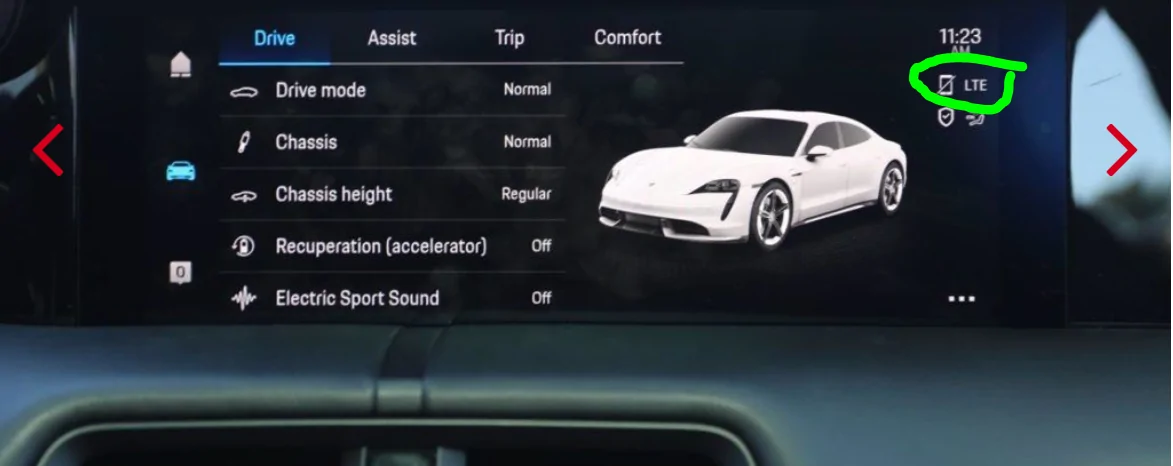

Whenever I start the Porsche Connect app it always has red dots - my impression is that the Porsche server does not stay connected to the car once you power off (that is the explanation why there is virtually no battery drain when parked). I suspect when you open the app on the phone it connects to the server, and then the server tries to contact the car - which takes a little while. As you see in the pictures, the time difference on the app is 1 minute (in fact it is usually only 30 seconds or so to get the connection).
You can try anytime for your car. The important part is to check when you park if you have antenna on the screen in your car (the LTE bars top right corner). If you do, you can remotely connect, if no signal probably not. At work we have underground parking, and most of the area has no reception - that is how I know about it.
