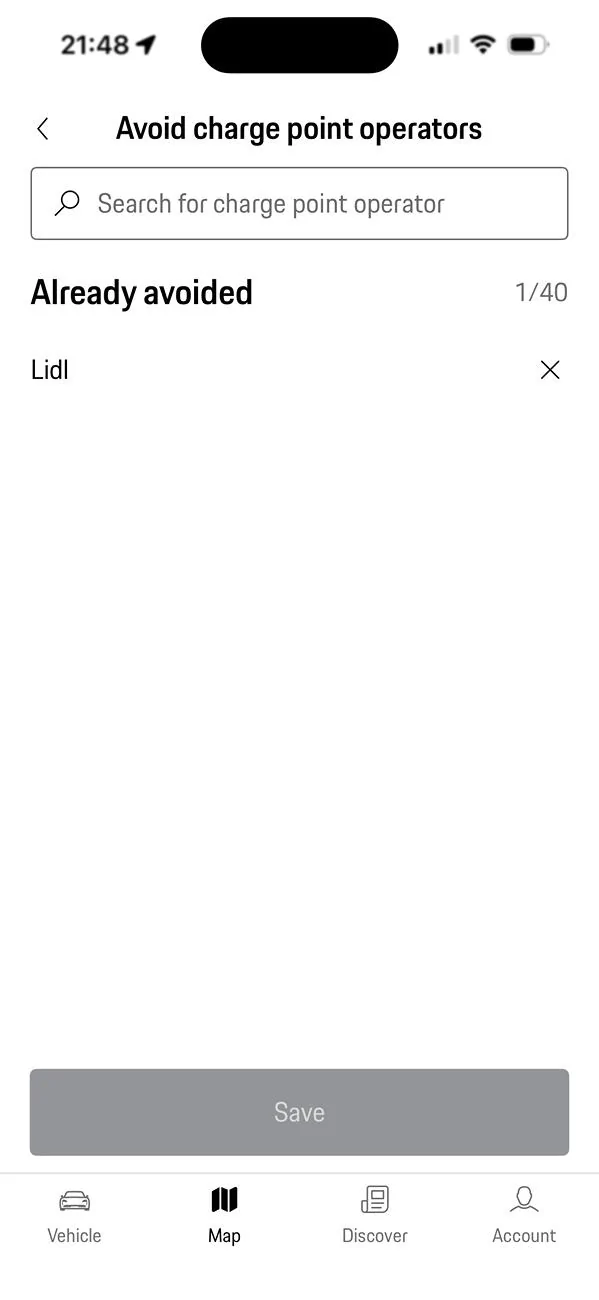

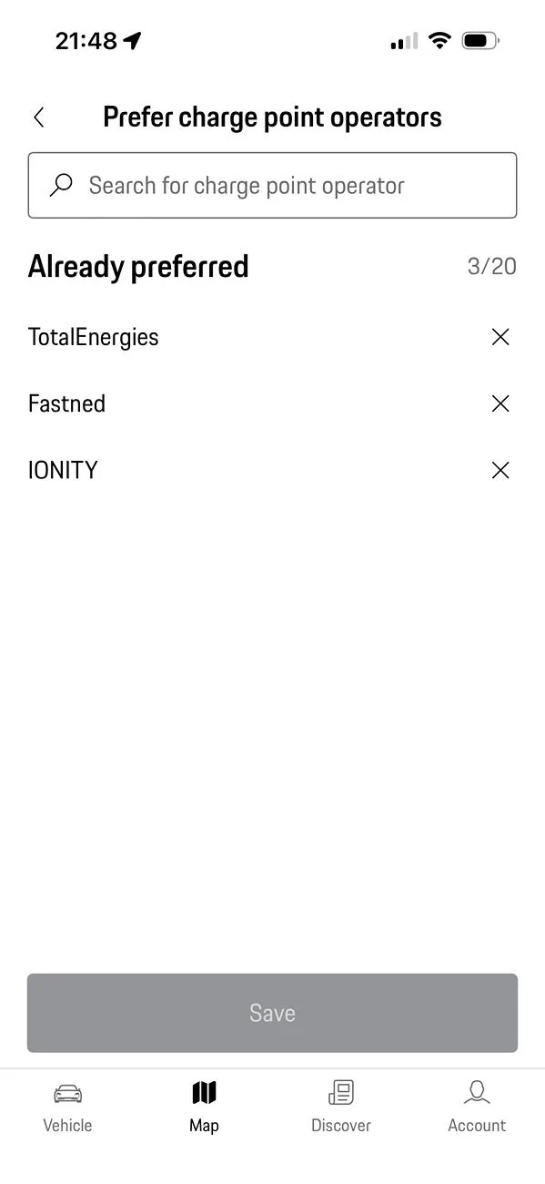

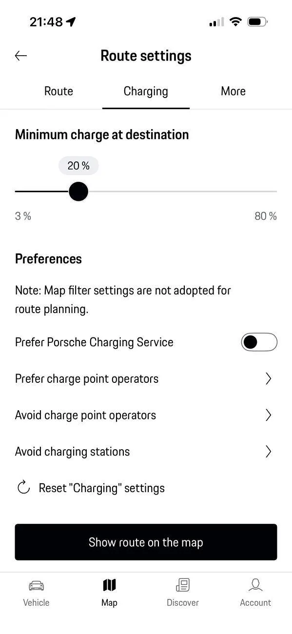

While planning a route in the app, I have the option to add charging point operators to either a preferred list or an avoidance list. For example, I like Fastned and Ionity because they’ve always been reliable for me. Lidl, on the other hand, once caused serious issues with my car in France—it had to be reset after using one of their chargers.
I tried looking for a similar option in PCM, but I couldn’t find a way to manage preferred or avoided operators. Where can I find this setting? I have the J1.1 MY23.
Porsche Taycan Preferred charge point operators IMG_5395

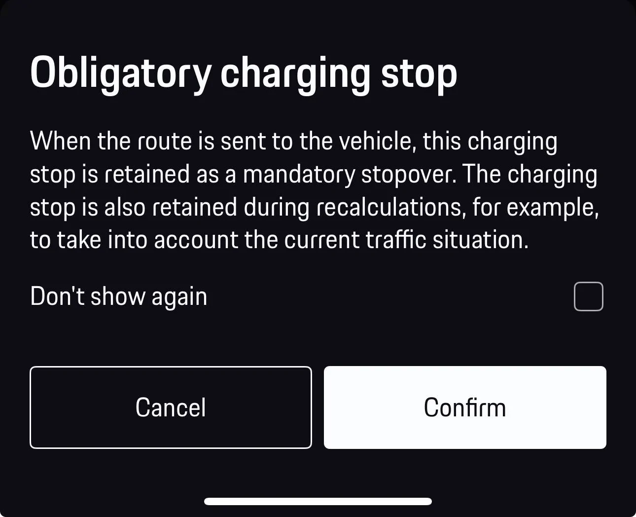

Todays app update brought the option to mark a charging stop as obligatory preventing the car to through it out the window when recalculating the route

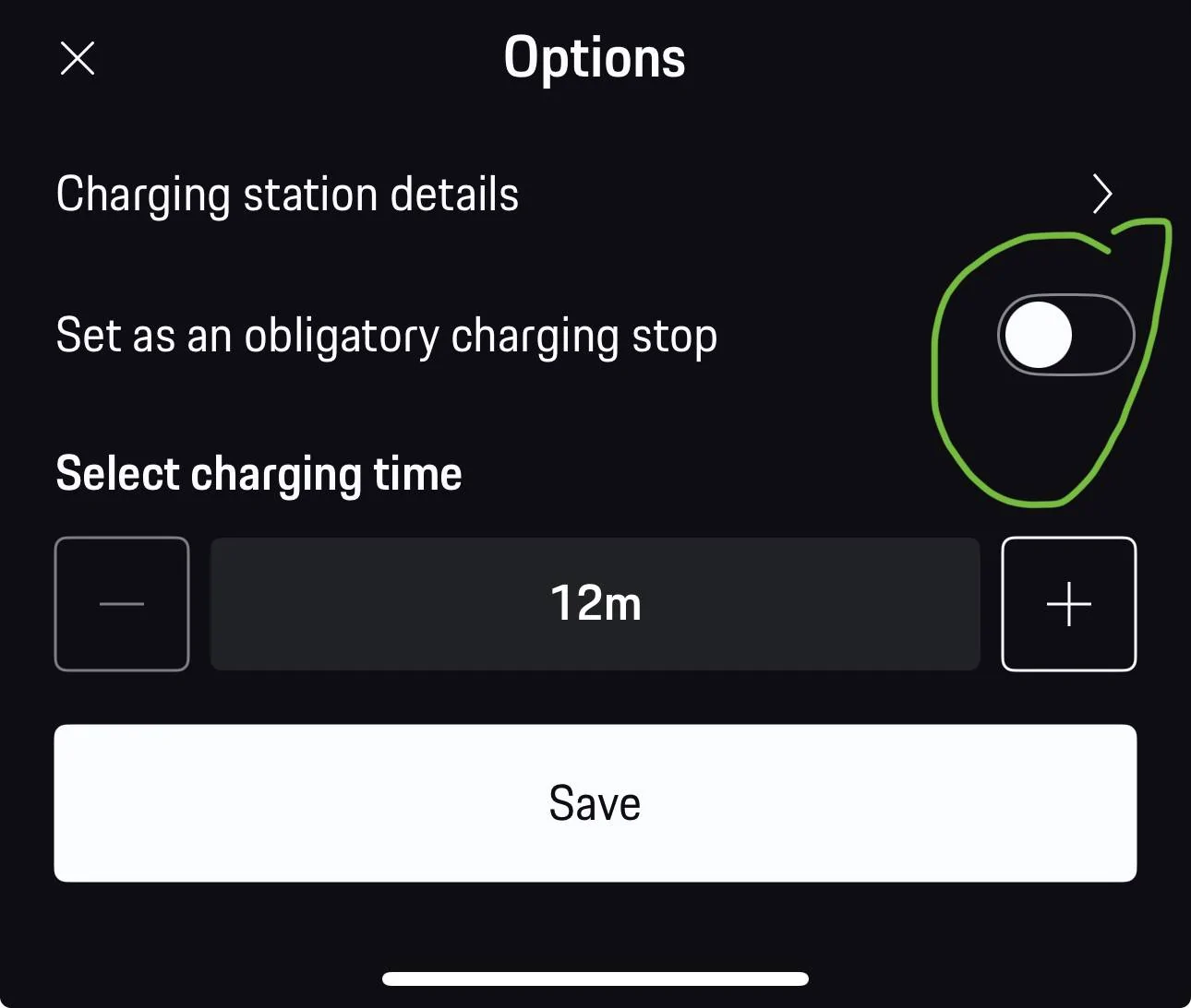

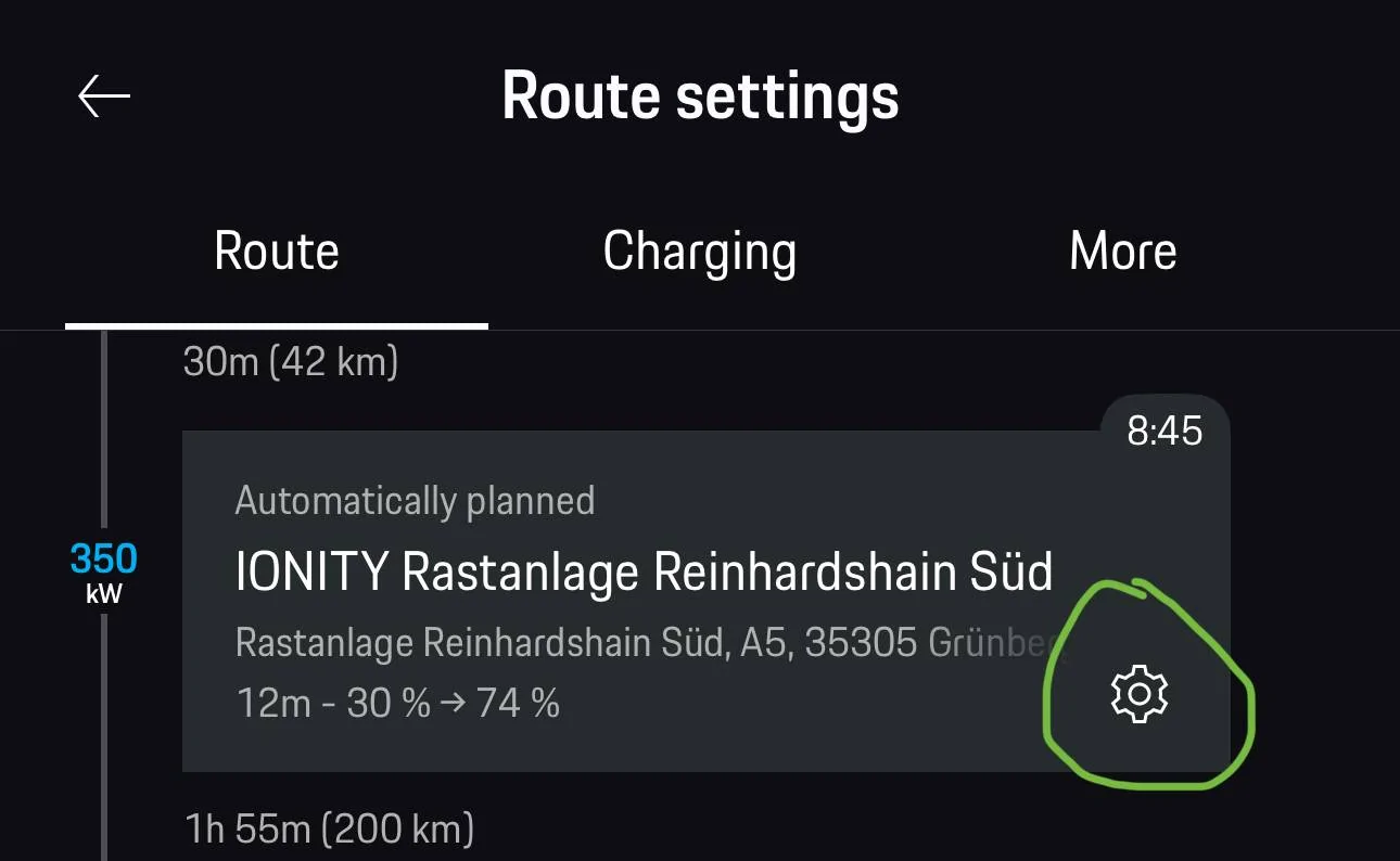

Sure, here you go:
- when planing a route via the App set your destination and calculate the route
- click on “plan” to go to the stop overview
- find the charging stop that should be retained and click on the settings symbol
- activate the toggle for “set as an obligatory charging stop”
I’ve attached some screenshots, hope that helps!
