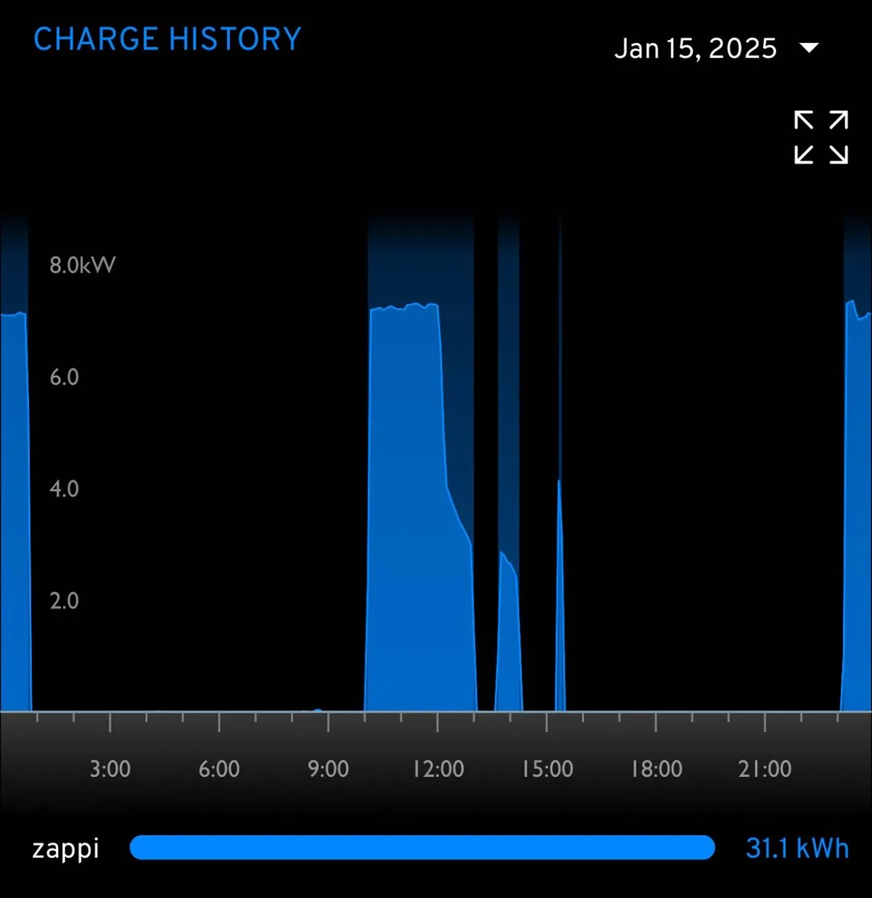

When using a timer the BMS will delay a large proportion of the charging process so it finishes just-in-time for departure. The charging process obviously heats the battery, so this delay is there to ensure you have warmth in your battery for when you leave.
I don’t know if it uses the heater or heat pump to also actively add heat to the battery.
In this example I plugged in the night before and it added about 30% SoC immediately, then paused overnight and added a chunk of charge to meet my 100% target for 15:30. You can see if finished charging a bit before (see the tail-off as it approaches 100%), then a short blast of shore power to preheat the cabin.

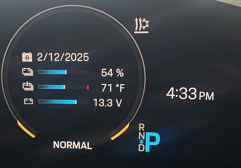

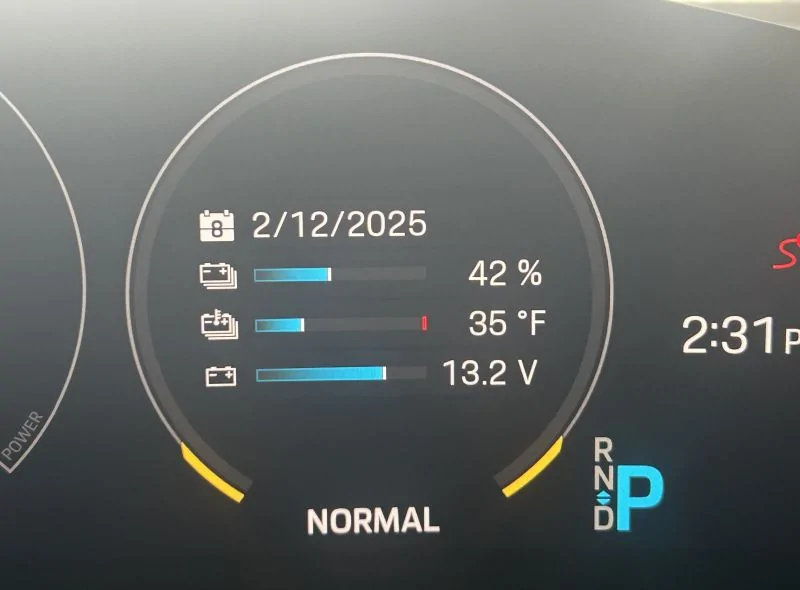

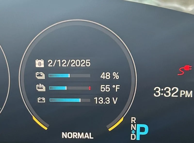

So I did a test. I plugged into a slowish Level 2 source (6.3kW, 5.8kW into the battery) at 2:30 PM with the battery at 35F and set a timer for 4:30 PM. At 3:30 the battery had warmed to 55F and it still showed 5.8kW charging rate. At around 4:00 the preconditioning kicked in and at 4:30 the battery was at 71F with the cabin warming also. It doesn't appear that the car used the PTC heater during charging prior to cabin heating because the car remained at 5.8kW for at least the first hour. Does Level 2 heat the battery when cold? One way or anther, it does quite a bit.

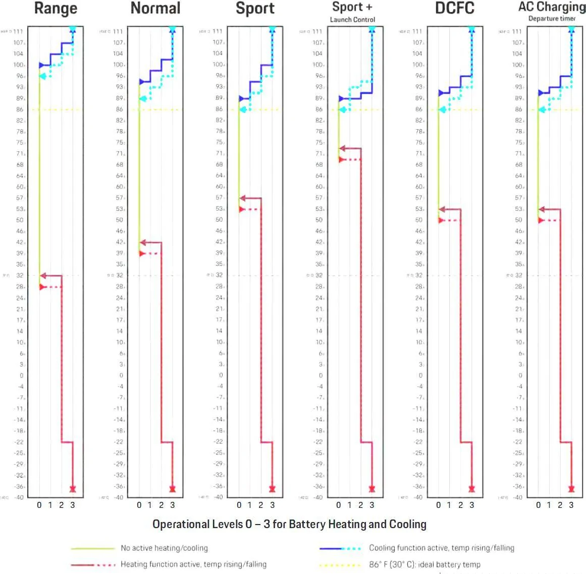

Yes (see AC Charging profile). This graphic is from 2020 Taycan documentations provided to service techs during training.
Porsche Taycan Preheat/Precool function, what is it doing? 1739427846910-3z
Also, there is wasted heat during charging, approximately 10% of the incoming energy is wasted as heat, i.e. does not make it into the battery.
