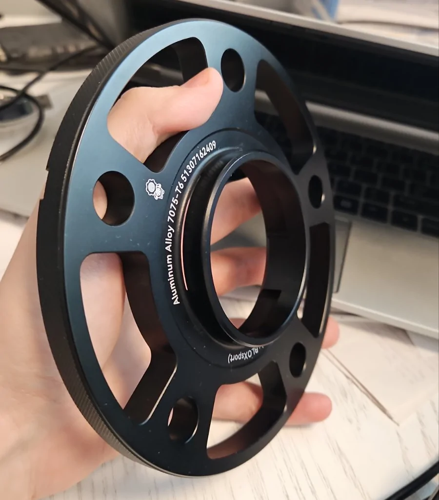

Porsche Taycan Project Purple - MY2026 Taycan CT4 spacer

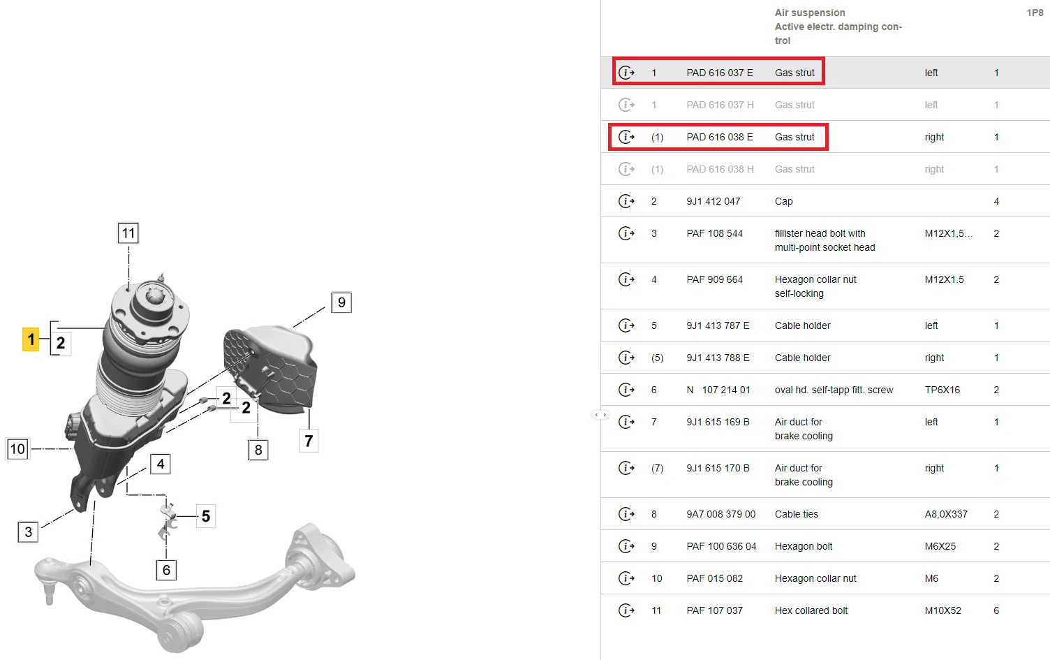

CT, ST and Sedan all have the same suspension part number?
No, CT has different part numbers for the air suspension dampers/struts. I have not checked how it is with active ride though.

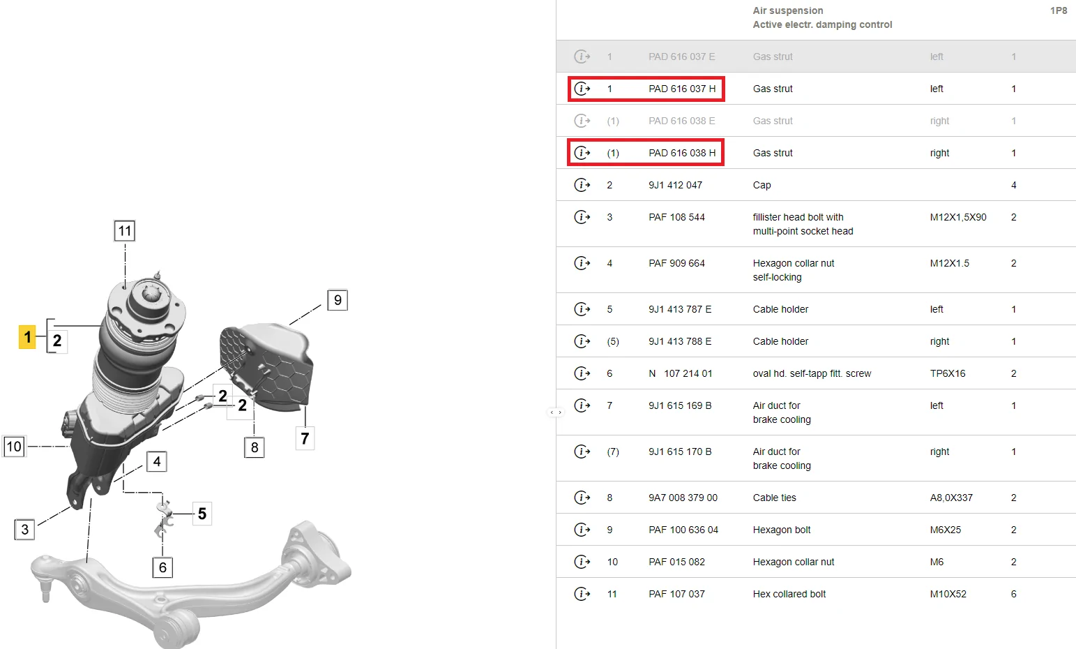

Did some more checking. For the facelift there's 4 different types air suspension struts:
1) Sedan & ST without AR
2) CT without AR
3) Sedan & ST with AR
4) CT with AR
Here are examples of Sedan & ST vs CT with AR in the front:
Porsche Taycan Project Purple - MY2026 Taycan CT4 sedanstar
Porsche Taycan Project Purple - MY2026 Taycan CT4 ctar
Same story without the AR and also in the rear.

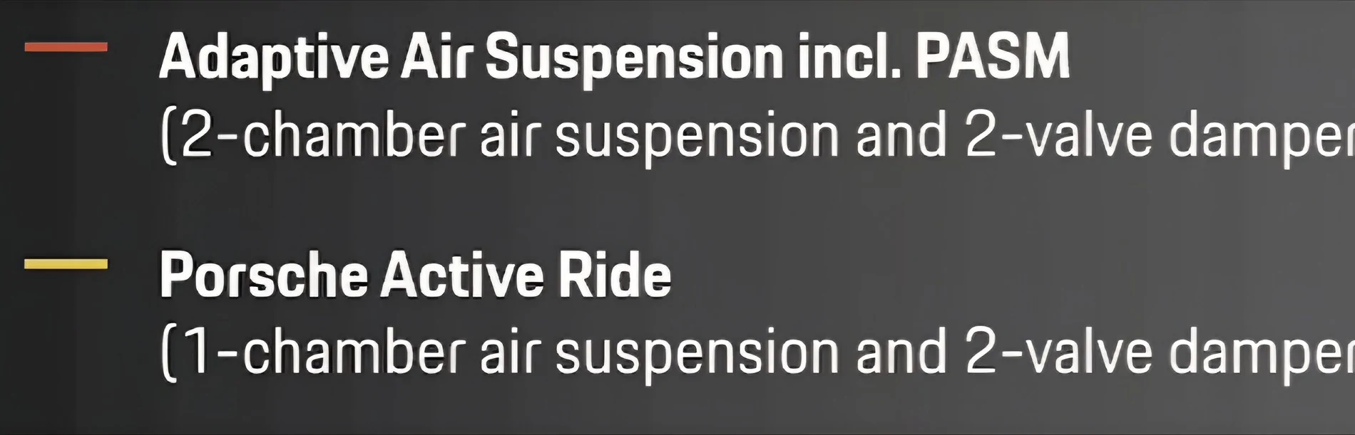

To be more exact the air springs are different between AR/non-AR (they include a hydraulic reservoir in case of the AR and just have a single air chamber).
And the shock absorbers are different between Sedan & ST vs CT. This is visible in the rear part numbers. Since the front has them as one unit, you have to have 4 variants for the front struts. In the rear the shock absorbers and air springs are separate, so there are 2 variants of the air springs and 2 variants of the shock absorbers.
This makes sense, because when you have a different ride height you also should always have a differently tuned shock absorber. Not something that usually is done aftermarket slamming the cars, but the OEM does that because they can do it right.
