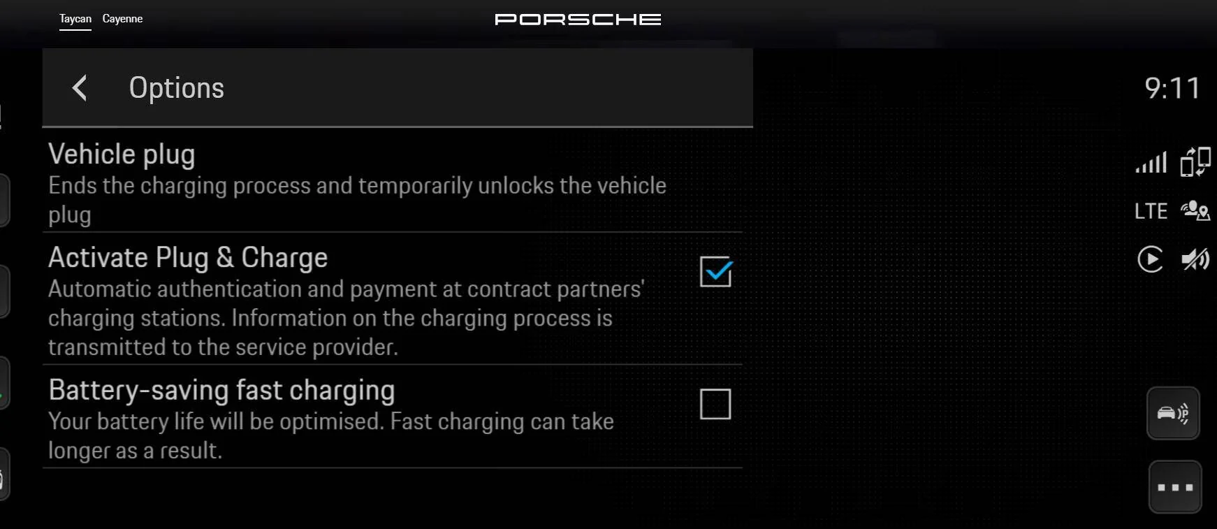

Hmm. This might require a dealer visit. I see no such option in the PCM. The closest thing is "Porsche Charging Planner", which is enabled.
PCM > Charge > < . . . > > Options > Activate Plug and Charge checkbox
From PCM Simulator:

This was the key. I didn't think anybody would be cruel enough to hide things that should go in a navigation tab behind a <...> button way over in the corner, because that is a very inconsistent UI.

You are right about the <. . .>
Did you have plug and charge option enabled? I have forgotten it a couple of times.
No, it was not checked. I'll go test it again later. Thank you for the pointer. Saved me a dealer visit.
