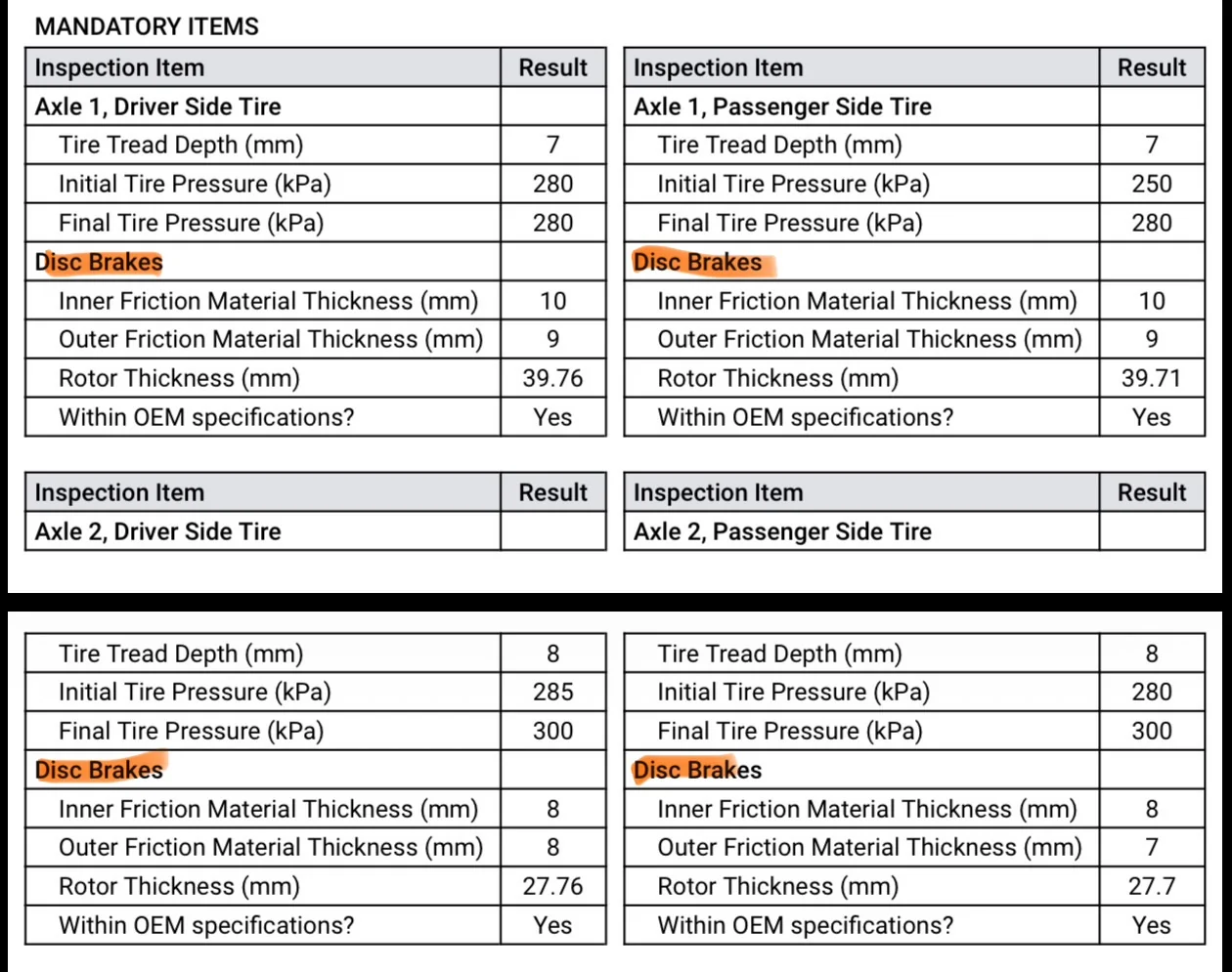

Hi Everyone,
I’m an owner of a CPO 2020 Taycan 4S, and I was provided the attached disc brake details for the front and rear. I was wondering if any of these numbers would warrant a replacement of the rotors and brake pads?
I have the PSCB.
thank you.

That's a lot left. Ask your dealer what the minimum thickness is for PSCBs. It'll take about 70k miles to wear it down Typically the tungsten carbide coating will degrade first (lose the mirror shine).

I believe the pads are a 6 year replacement item irrespective of wear
