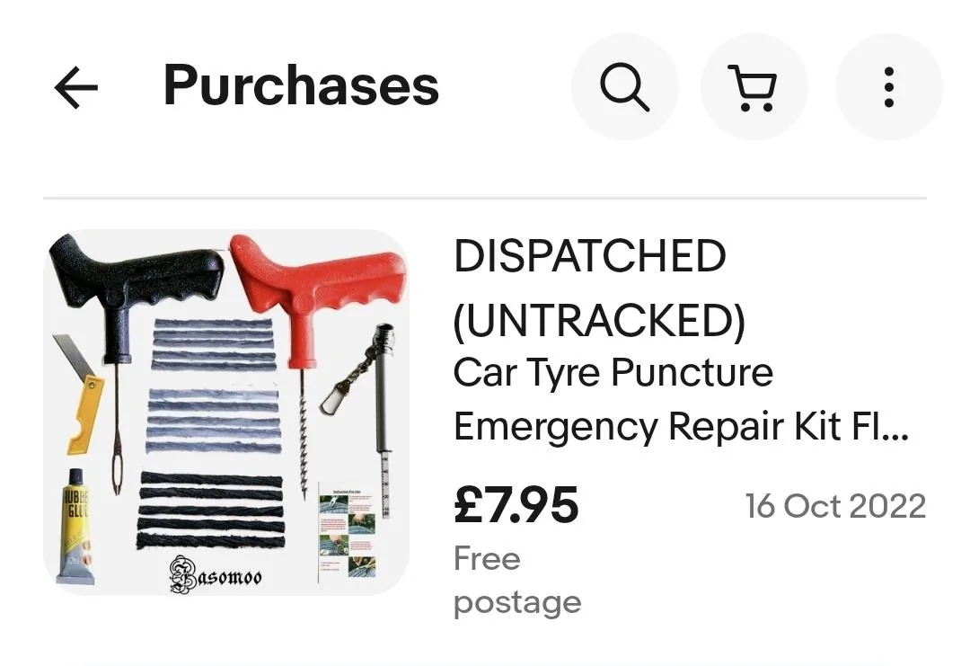

Yes, I carry them in all our cars. Not had to use it on the Taycan, but I recently used it on a BMW which got a bolt through a run flat quite near the edge. I replaced the tyre but the kit allowed me to inflate the tyre and drive home rather than drive it flat. We were then off on holiday for a couple of weeks and the car sat in our garage and didn't loose any pressure. I had the tyre replaced after we were back. I have had tyres professional repaired on my BMWs in the past and driving then until worn out.

Simon - being in the UK, can I ask which one you use please?
One like this from eBay. Similar available on Amazon.
Tips for use...
Leave the nail/screw in the tyre until the last minute.
Thread the sticky rubber stick into eyelet and apply some rubber solution to the stick.
Have a pair of pliers handy or buy a kit that includes to pull the nail etc out.
When ready, pull out the nail, quickly rasp the hole with the supplied rasp and then force the plug in leaving about 20 to 30mm protruding and the sharply pull the tool out and cut off excess flush with the tread.

Those rubber-rope and glue kits have been fixing tire punctures for decades, and work reliably. If you have a standard puncture (nail) through the tread, I've found these to be 100% reliable and last the remaining life of the tire.
Remove the injury, ream out the hole to make it rough and the right size, then wet liberally with glue, shove the rubber rope in (folded over) and trim flush. Let it sit a bit before driving to allow the glue to tack up; doesn't take long. With a good tight fit and plenty of glue, I would not hesitate to use the remaining tire life street driving. (If you regularly pull 1G lateral or track/race the car, get it replaced or at least patched from inside the tire.)
