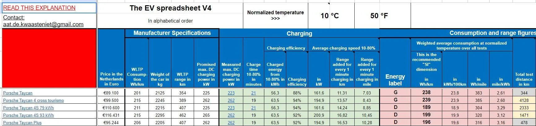

Right, but actual real-world test results show:
Porsche Taycan Questions from a Tesla Owner Taycan consumption
The "Taycan" and "Taycan Plus" test results are apparently from single tests (based on the total km driven in testing), so I'd ignore those as outliers whose results would normalize over more tests.
What we're left with is the Cross Turismo ("tourismo" on this sheet) showing real-world results over multiple tests of about 20% (239 wh/KM vs. 189-199 wh/KM) worse than the Taycan...
First I have to apologize for being curt earlier. Your initial assertion was that the difference in efficiency was attributed to aero, which I doubted. It does turn out that the Cd difference is significant (~20% in favor of the sedan) so your assertion was correct - or at least partially so. However, while reading the Porsche literature on aero, the very same doc mentions a roughly 20% difference in efficiency between the 4 and 4S in the same body style (wagon) - so there must be something else at play here. (I suspect the doc is old/pre-update-with-a-P.)
Regarding the table above, something still doesn't make sense: the WLTP efficiency is the same (215 Wh/km) but the WLTP range is different (389 vs 462). That alone would seem to imply the "tank" size (battery capacity) is different, before we even get to the real world tests.
Lastly, on the topic of the real world tests - the data on the 4CT above shows ~3x test distance covered vs the 4S, and so I'd expect the former to be closer to reality (both are short in terms of distance I'd think sufficient to cover a range of weather conditions, but 1k miles of test could basically be one longer trip). Incidentally, as I mentioned before, the 4CT consumption matches exactly my lifetime average at 2.6mi/kWh, but all of my driving was in cold weather with a roofbox on top. (That alone seems to impose a 6-9% penalty on consumption.)
