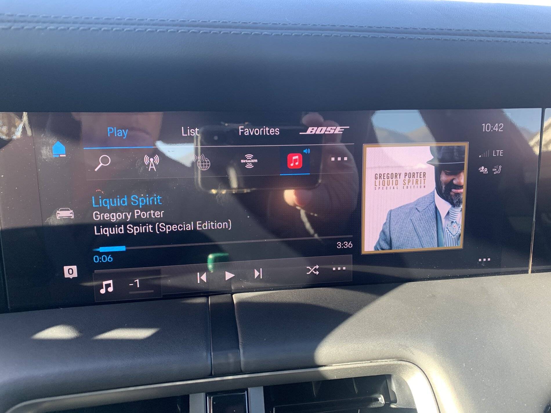

Today I had a volume of -1 (see image).
First problem I have had in two months of ownership with PCM. Knock on wood.
The scroll wheel on the steering wheel was not muted. It did not matter if I was trying to listen to the radio, Apple CarPlay or anything else.
iPhone would connect through the system however no volume/sound still -1.
Center consul plus + or - minus did nothing nor did swiping.
Decided to try the often mentioned method of turning the car off, locking the car with the key fob. Came back 15 minutes later everything worked.
Have to love computers, just reboot.

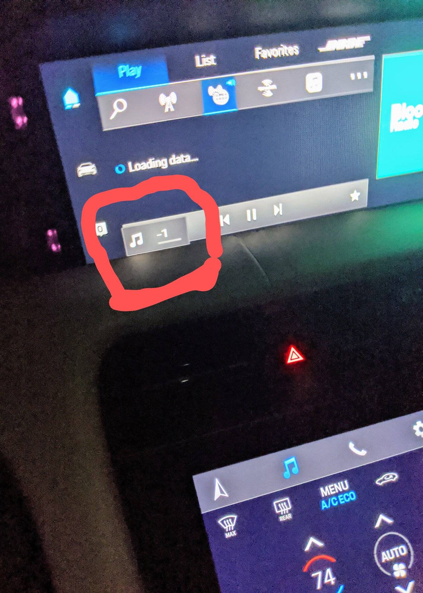

I had the same problem today and nothing played not even the navigation system voice prompts. I had the same negative one show up look at the image attached.. I got an update yesterday for my maps. I wonder if that update screwed it up!! I have an AMG too, and man I have to tell you, no such issues ever on that car. Of course it does not drive as well!

Ujj,
I did not have any updates so I do not think it is related.
Did you try locking manually and leaving it for 15 minutes then restarting?
I experienced this too. Just powered off car (a/k/a CTRL-ALT-DELETE), waited a while and started again. Problem cleared. Thankfully haven't experienced it again other than that one time.
Had the same thing a few days ago. Noted that tapping the audio system tab (BOSE/Burmester) would just bring up a spinner, so it's clear that one of the subsystems never came up.
