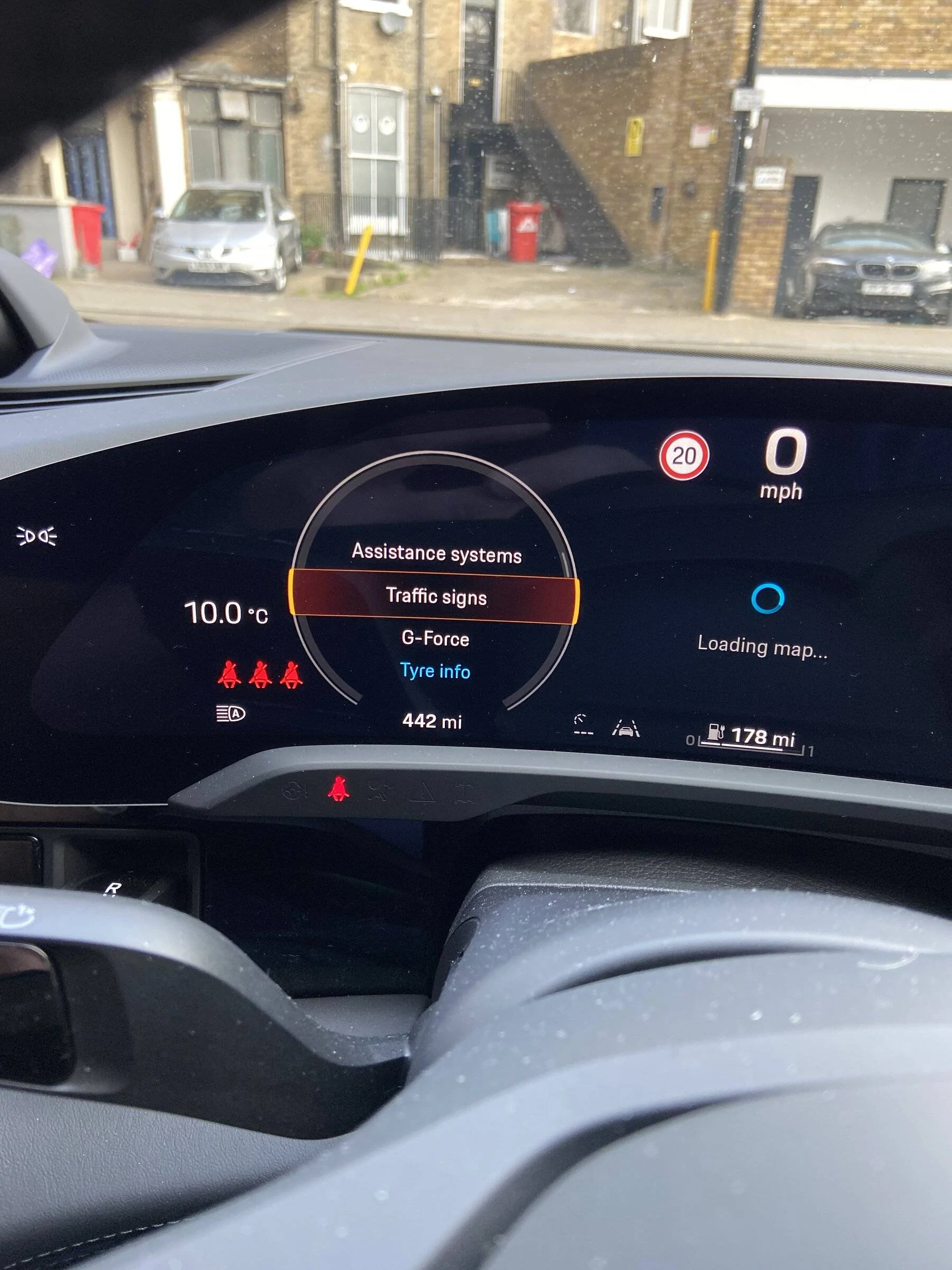

These are the only options i have on LHS. MY22.

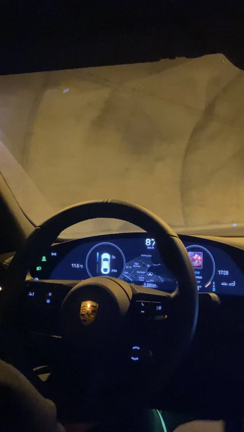

In range mode,my taycan seperates the rear engine and powers front the engine.

So i tested it again more today,
note that mine is MY21
from this vid, when i throttle, it used mainly the rear motors (not exclusively tho), even when im not accelerating like crazy. then quickly switches to front only when i’m coasting (left of the pedal)
That's the same experience I have with my '21 Turbo. RWD primarily for acceleration (maybe 80-90% from eyeballing) and it shifts to FWD when coasting at speed on flat or downward slope.
