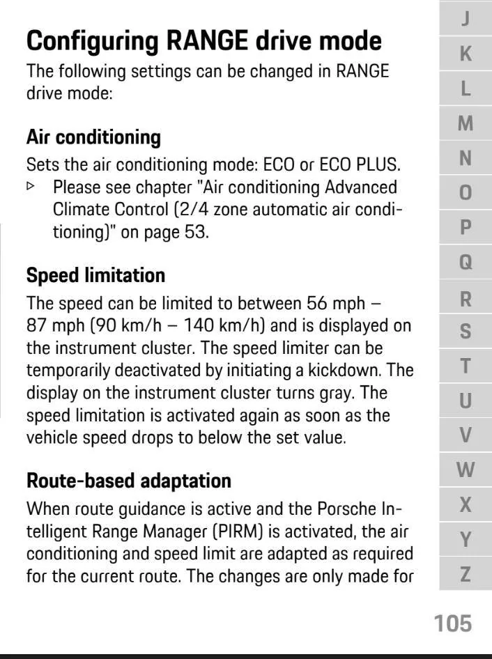

Thanks! But my main question remains. Is it to
Yes, that’s correct Range Mode in the Taycan is limited to around 60 mph (97 km/h) to maximize efficiency. This speed cap is not adjustable by the user. It’s designed for optimal energy savings, especially in city or light highway driving. For higher speeds, you’ll need to switch to Normal or Individual mode.
False! It is adjustable. On PCM where you can customize Individual mode you can also customize Range mode here.
to make it more complex, PIRM can overwrite the users settings up to 150km/h
