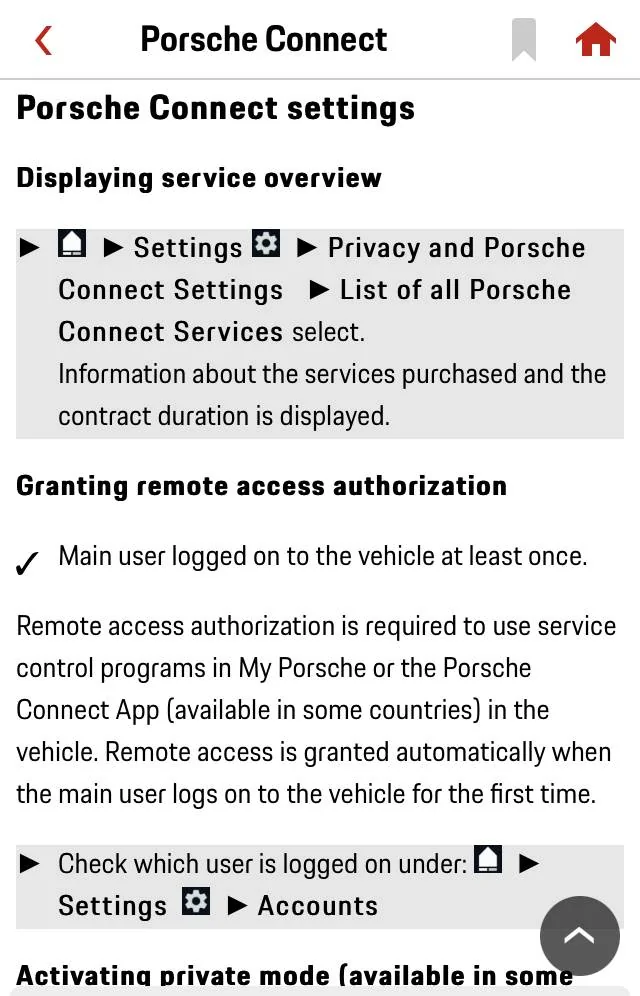

Well I had the range mode configuration disappear only once so far and reappeared recently. I hope it will stay for me. I have had in the past several times that communications were a problem. What it had always been for me was that the car went into that privacy mode without me asking for it. May not be your issue, but FYI.
Porsche Taycan Range Mode Speed Limiting Issue 43F1258C-FB71-4705-AEC0-BB7346C81588
