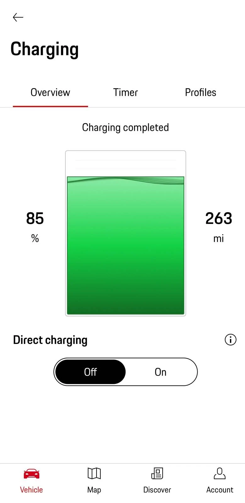

EV’s are very sensitive to ambient temperature. I have a 4S with the larger battery and this is what I got this week, which equates to 309 miles at 100%. Temps here are in the 70s and 80s now.

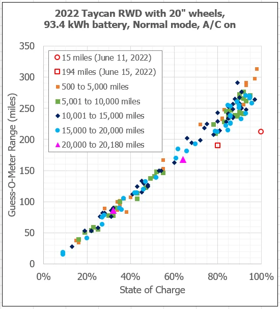

Here's my chart as of today (May 21, 2024). I surpassed 20,000 miles yesterday, so there are only two data points above 20,000 miles. Note it's easy to trick the guess-o-meter by switching to RANGE mode and turning off the air conditioning or heating, so I make sure to stay consistent by not doing this.
