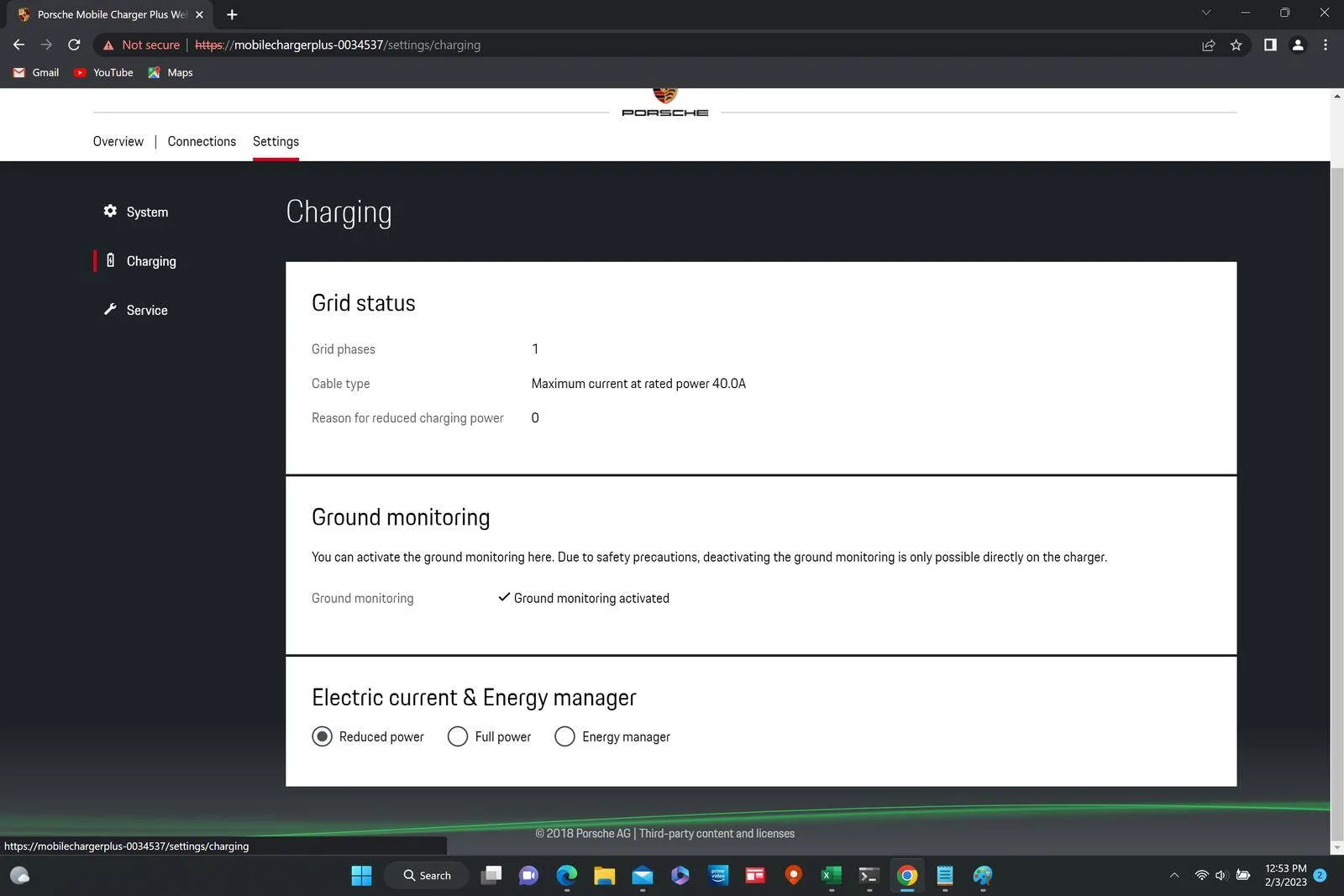

Reboot or switch through the various modes?
If the latter, I found this old screenshot but I don't have the corresponding request (not sure if you meant via UX or programmatically).
