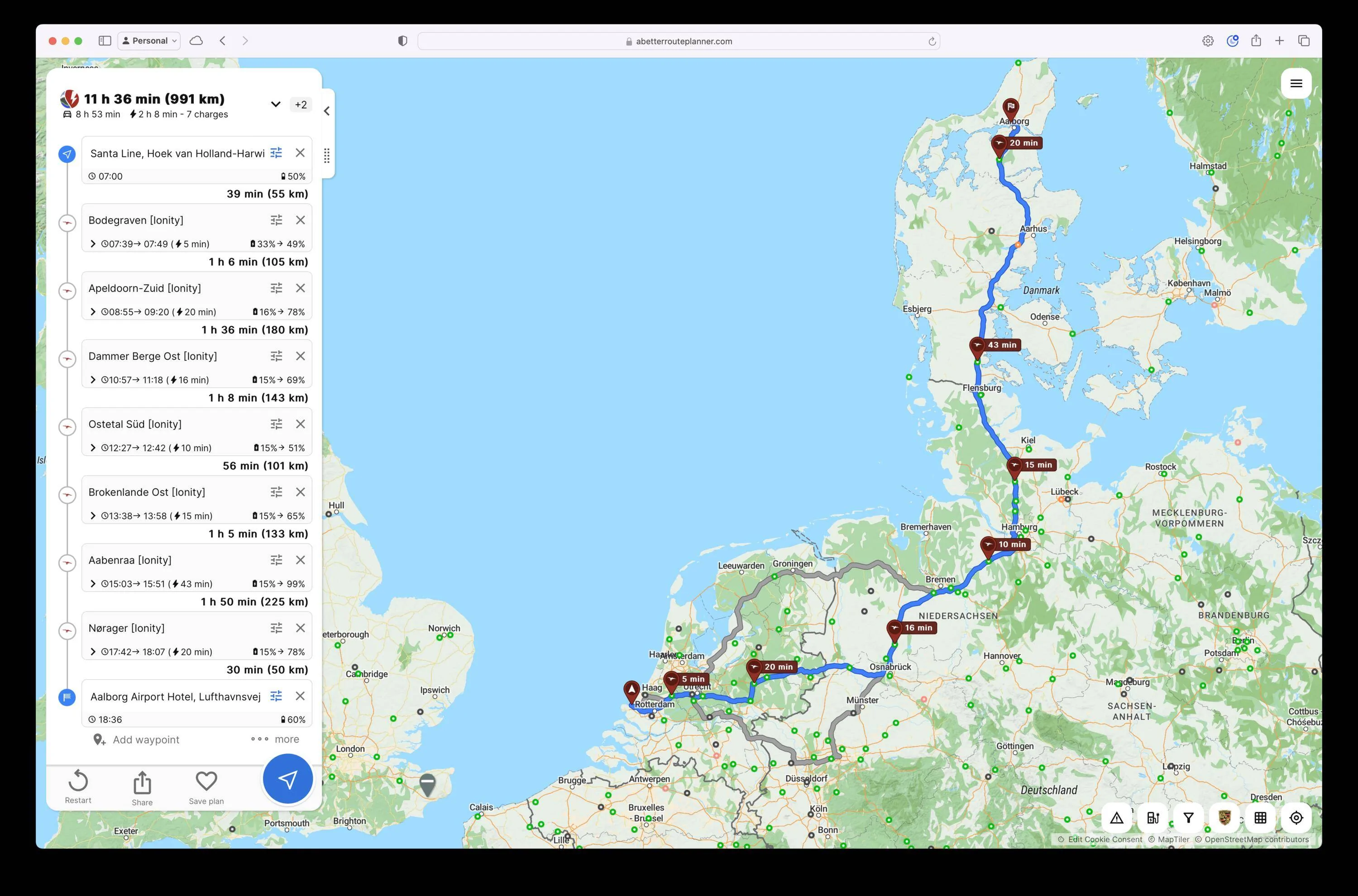

What I tend to do is pre-plan my route on ABRP and then just add up the chargers in the PCM – turning off the Porsche Charging Planner. That way when it gets a map update – the planned route stays the same. And often we've made some food plans at a specific stop and don't want it suddenly being removed from our route.

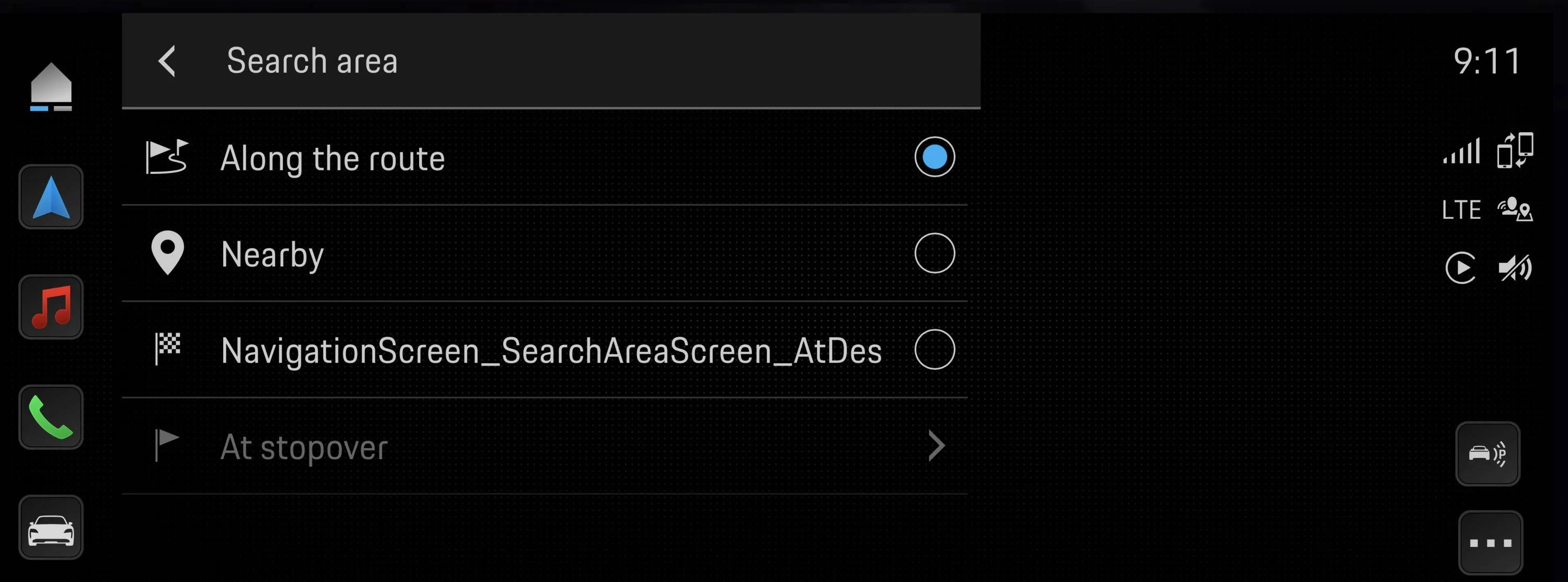

I used to sometimes find it hard to find the specific chargers in the PCM – until I realised that location finding defaults to "nearby". When I switch it to "along the route" – it finds most chargers easily.

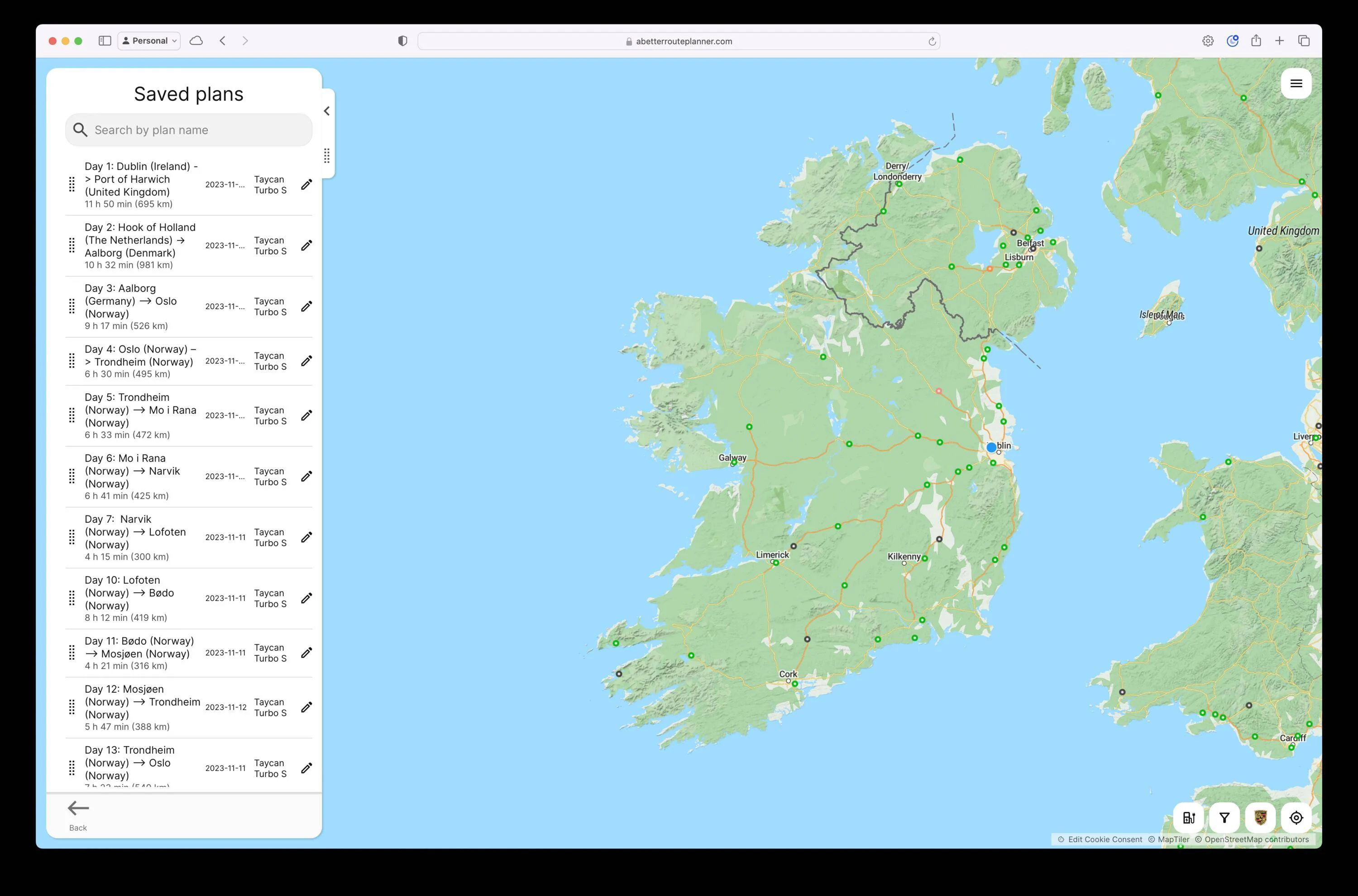

Only thing I would love to have then would be the possibility to save that route as a complete item including charging stops. Then I could do all planning in advance and just call up the different day trips on long journeys.
This is something that I do in ABRP – have already my next Norway trip all planned out! But I agree, it would be great if the PCM navigation had a similar feature – it would save starting the day getting the route into the PCM.
Porsche Taycan Reflections on a recent rip from Nice, France, to Stockholm, Sweden Screenshot 2023-11-16 at 08.06.07
With each day's route having our carefully planned (and researched on PlugShare) charging stops saved off within it.

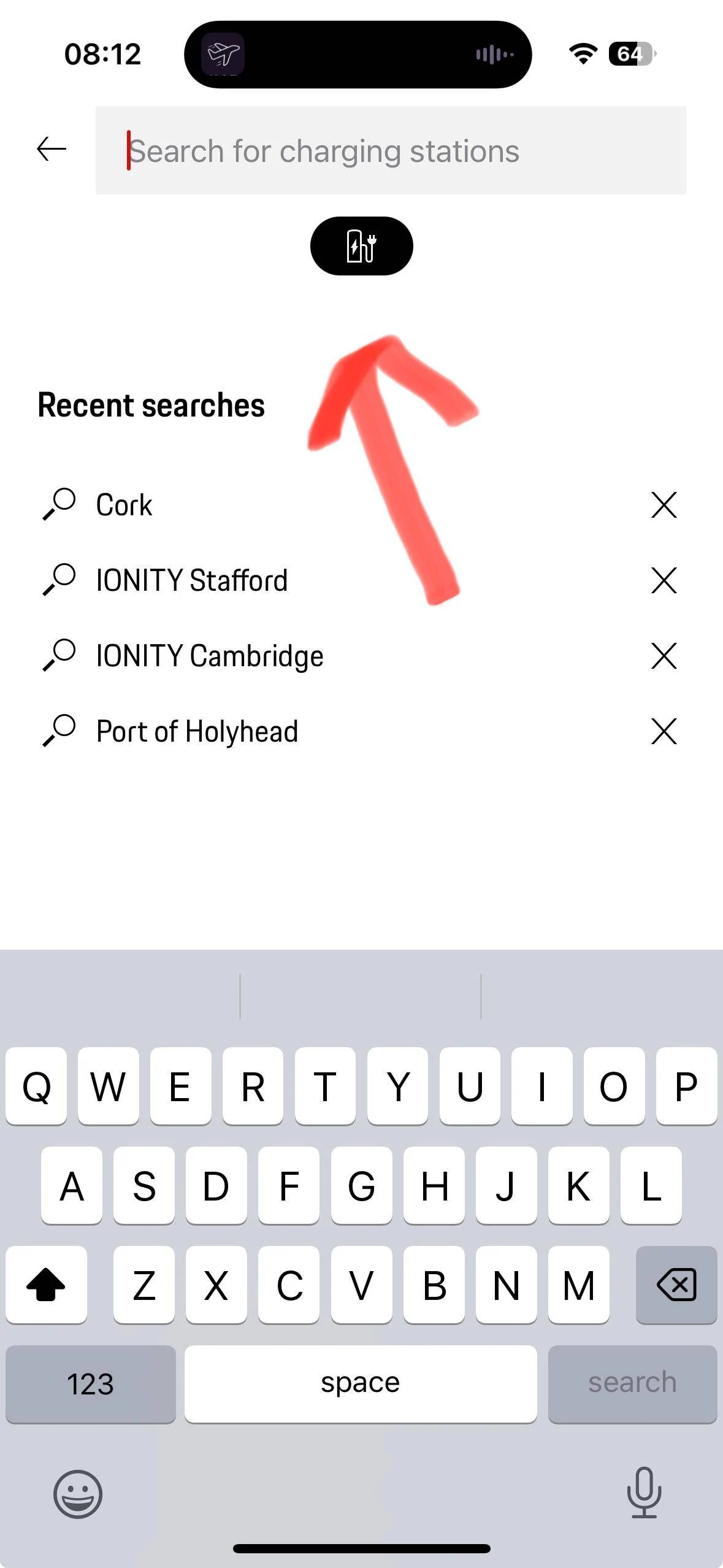

Usually I use the My Porsche app to transfer each day's route to the car before going out to it. I find that works reliably enough.
One key thing to remember is to use the "charging stations" filter when searching for and adding up charging stops along your route. This ensures that the stops are sent to the car as charging stops.
If you search for charging stops without using that filter – the My Porsche app is very likely to still find them – but they will only be sent over to the PCM as "waypoints" to stop off at. And it will then depend on the Porsche Charging Service if it will consider charging at that stop or not.
But by using the filter – you are telling the PCM its a charging stop you want to use – and it will "do the right thing".
With each day's route having our carefully planned (and researched on PlugShare) charging stop saved off within it.

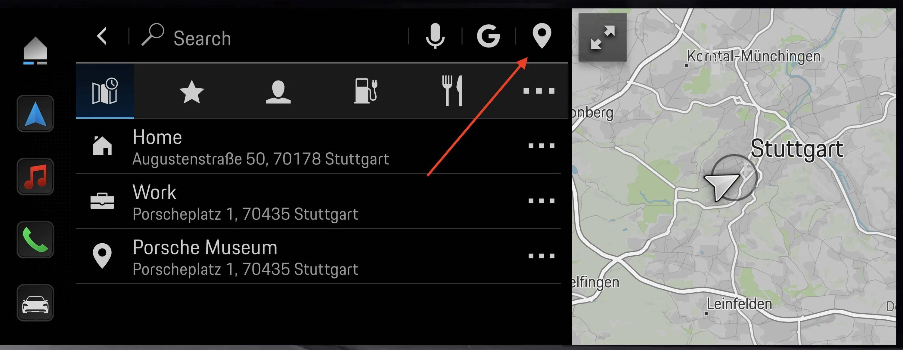

Good tip. I always sent the destination to pcm and then look for charger in this location. This saves time.

Thanks, good suggestions. I normally plan my routes in ABRP and save them in the same way. Will try to route settings with charger stopovers and send to car.
