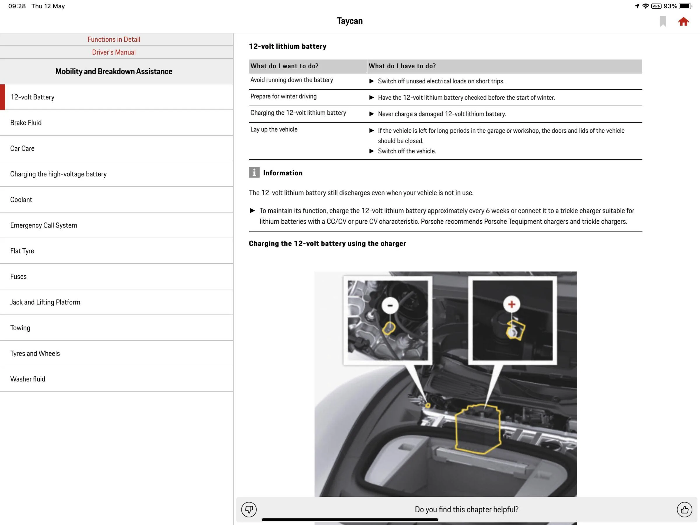

For the 12V battery I am not sure. Unfortunately, the Taycan, unless my little Nissan Leaf, has no solar cells to keep it topped up. In the past we used to disconnect a 12V battery, but I am not sure what that would do to the Taycans complicated electronics.... And whether or not it will be flat anyway when you return....
