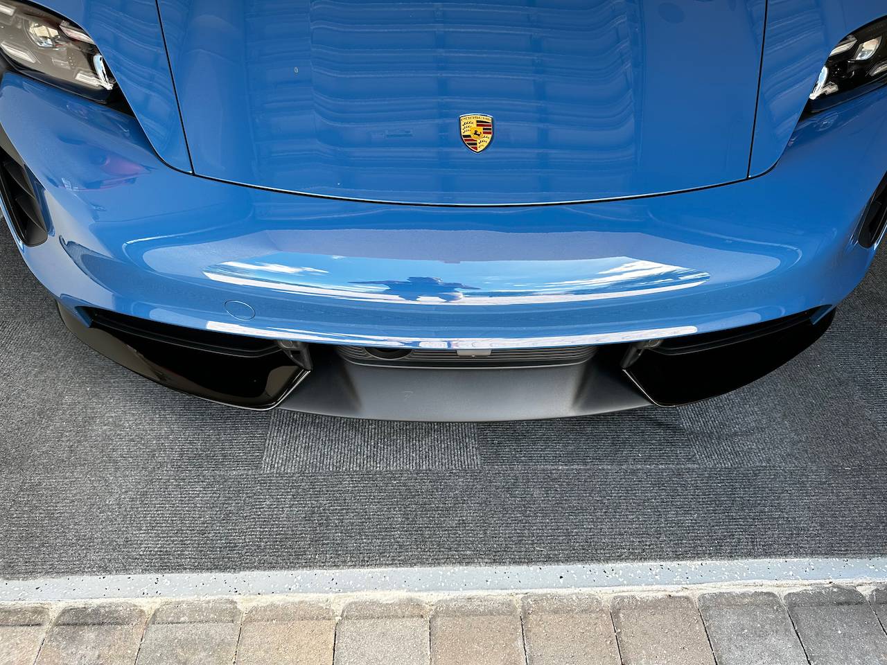

Sorry for reviving an old thread, but I'm planning to do this.
Is there any reason you did not paint the middle portion? Do you regret not painting that part?
I'm planning to paint that part gloss black but was wondering if there was any particular reason (e.g., not looking good) for not doing it.
I did not paint that because it is textured plastic and would have required a lot more work. The “blades” that I painted gloss black, that is typically painted body color on the turbo model comes as a smooth paint ready piece. I have no regrets as I think aesthetically painting the center would not appeal to me regardless of the difficulty to do so.

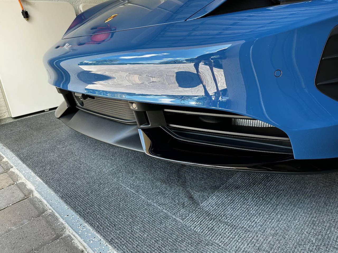

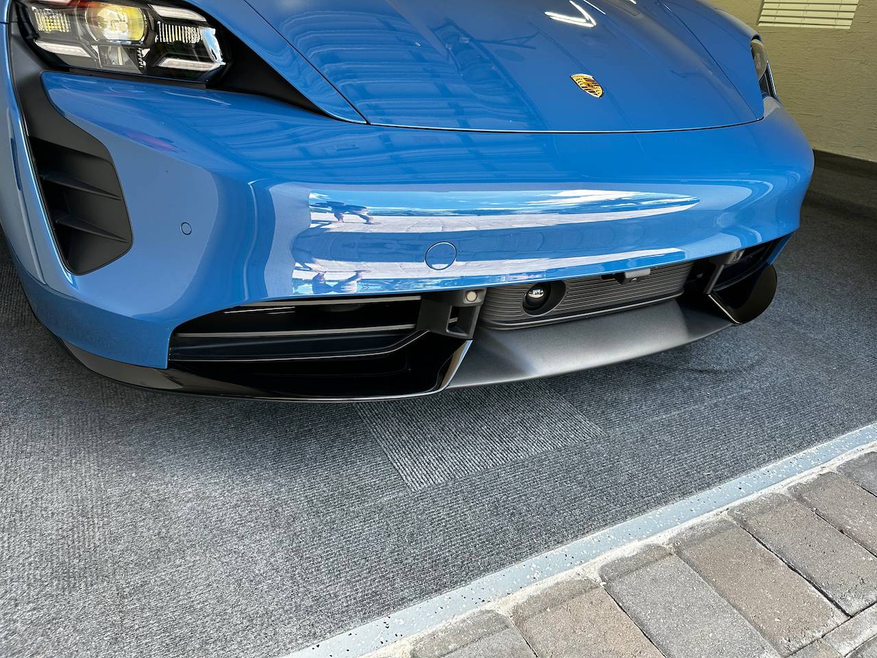

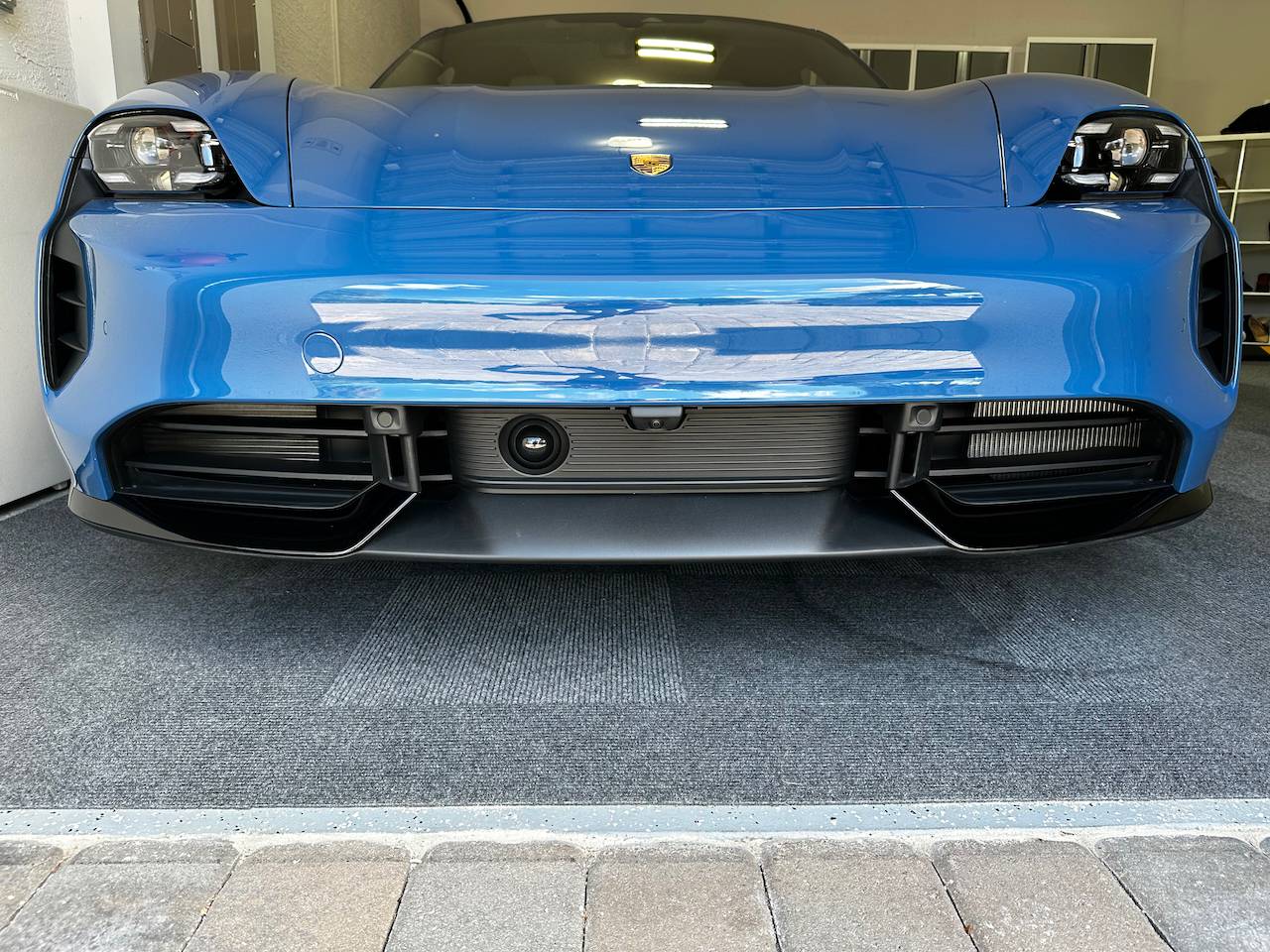

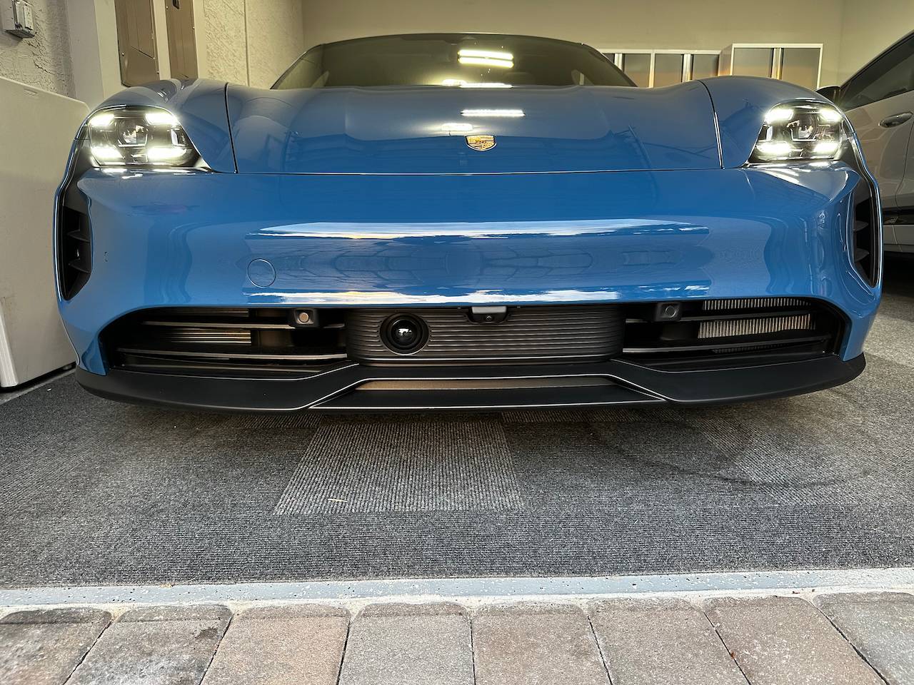

Here is the finished product, first picture is of the original front lip, and I'm sure all of you already know what that looks like, followed by pictures of the Turbo front lip conversion with the "wings" painted gloss black as my preference to match all the other gloss black on the GTS.
It is a subtle difference for sure, especially going with gloss black instead of body color, but it makes me happy!

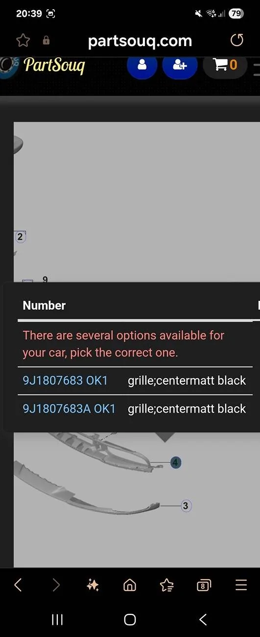

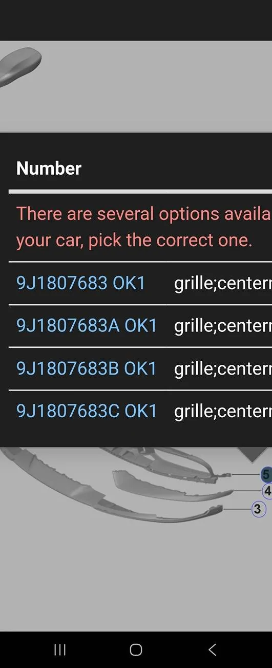

Does anyone know if the rear lower frame is the same on each model. They all appear to have the same part number:
Porsche Taycan 9J1 Matte Black Grill 9J1807683 B OK1???
Porsche Taycan Remove front lip Screenshot_20250520_203927_Samsung Internet
Porsche Taycan Remove front lip Screenshot_20250520_202955_Samsung Internet
Honestly, not sure about that specifically. Good luck on the search and project.
