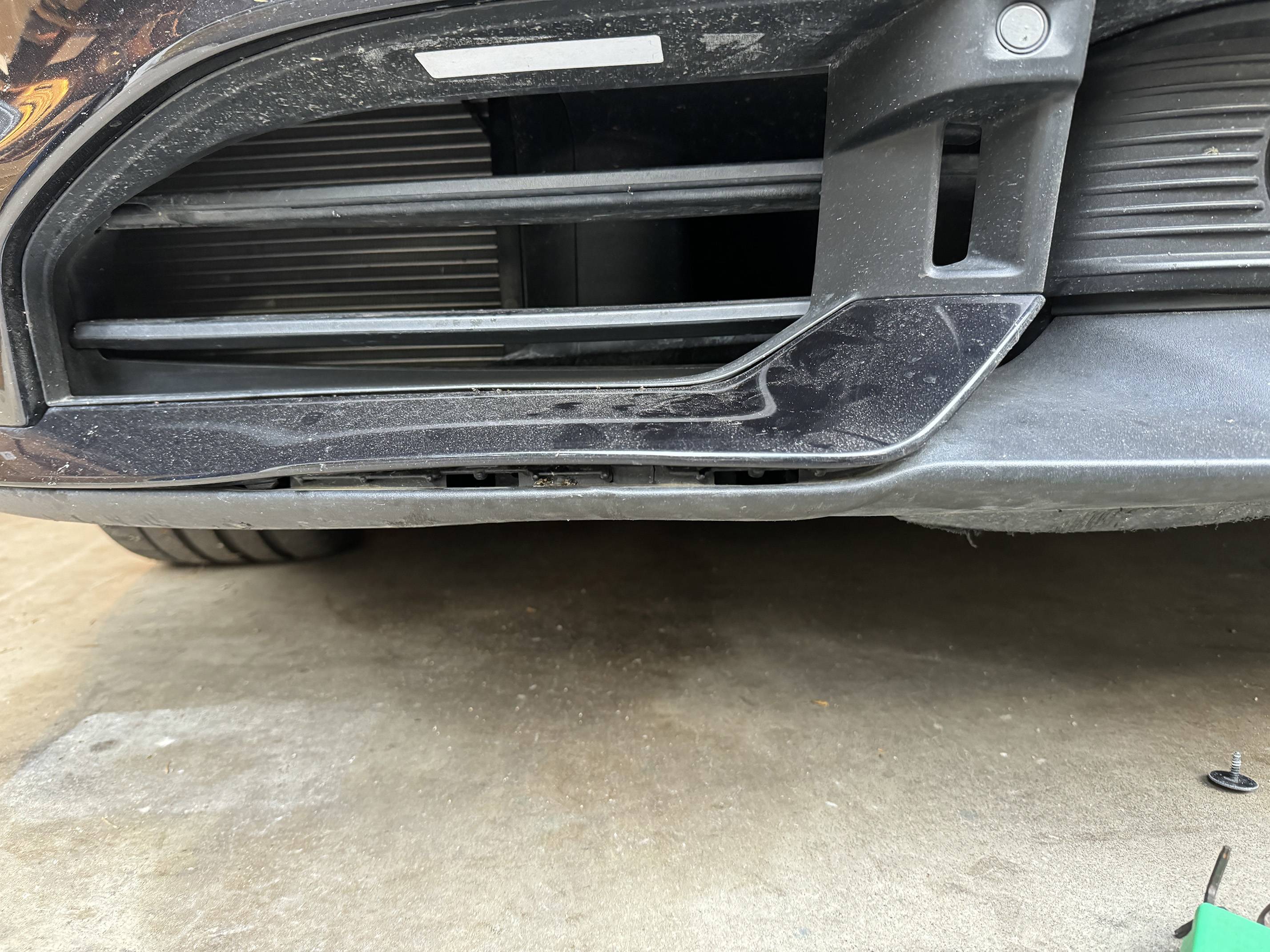

I have an odd issue with my front bumper/splitter assembly. It looks like the 'wings' got borked somehow and are dislocated from the splitter. I'm hoping to get them mated up the way they should be without pulling the bumper, though from the last few comments above I'm beginning to lose hope. I can't quite figure out what these are fastened to as they still feel quite attached despite the bottom being pretty much totally unclipped. Any tips or pointers would be appreciated!

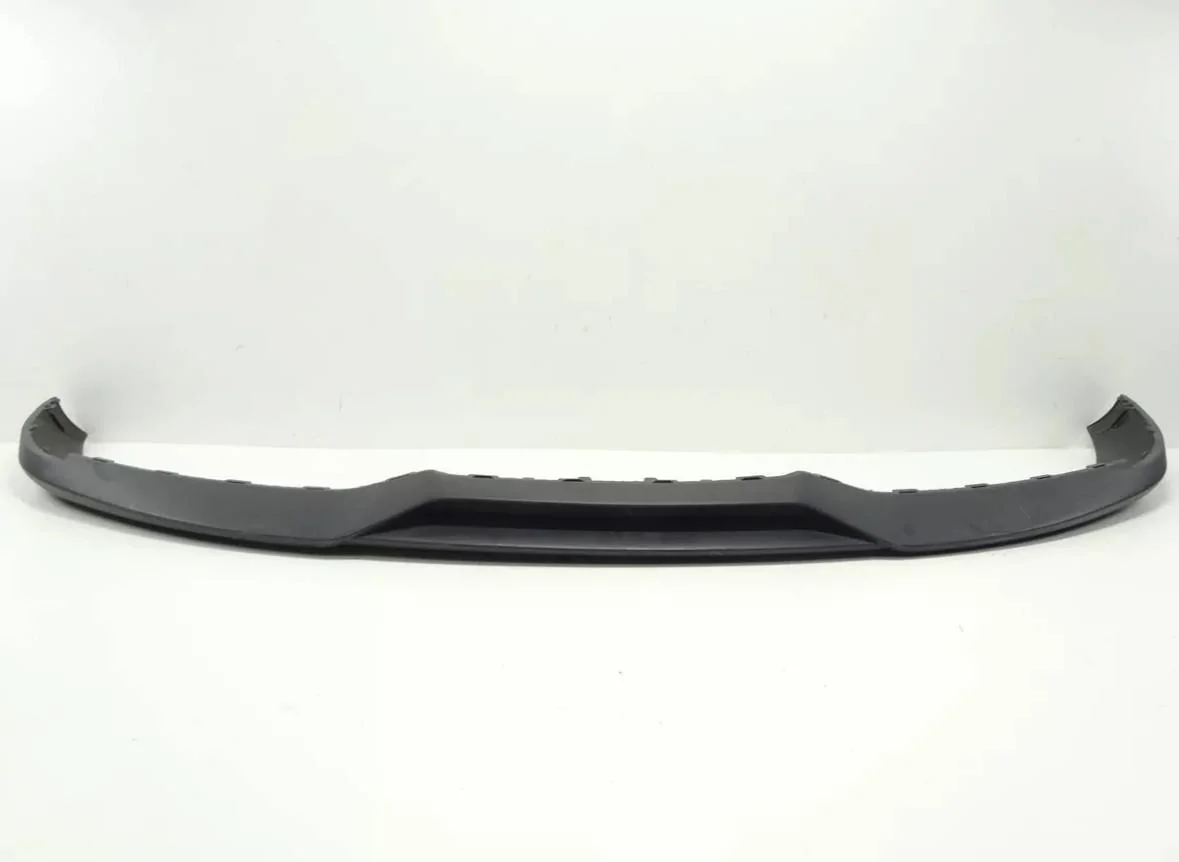

Below is a picture of the invoice with the part numbers to convert from a stock 4S/GTS front lip on a Sport design front bumper to a Turbo style front lip.

Does this mean that only taycans with the sport design front bumper can do this lower grill trim conversion or can this be done on the regular Taycan bumper as well with no issue? Thank you!

Sorry to be bringing back an old thread.
You can do this with either front bumper, the front lips fit both
Okay awesome! Looking into a 4S without the sport bumper so I will definitely look into doing this conversion. Appreciate the confirmation
Good luck! The attachment points are the same for either bumper and all the contours of the lower bumper are identical between each other. Only the air vent is different without changing the area below.
Looking forward to doing this upgrade. The turbo trim pieces looks tons better.
These are all clips.
You can pry with a wide tool on the underside, work with a leverage.
First unclip the side as well but it's not an easy job, you have to use some force (and there's the risk of breaking things).
With the side free you can get more force/movement on the front.
