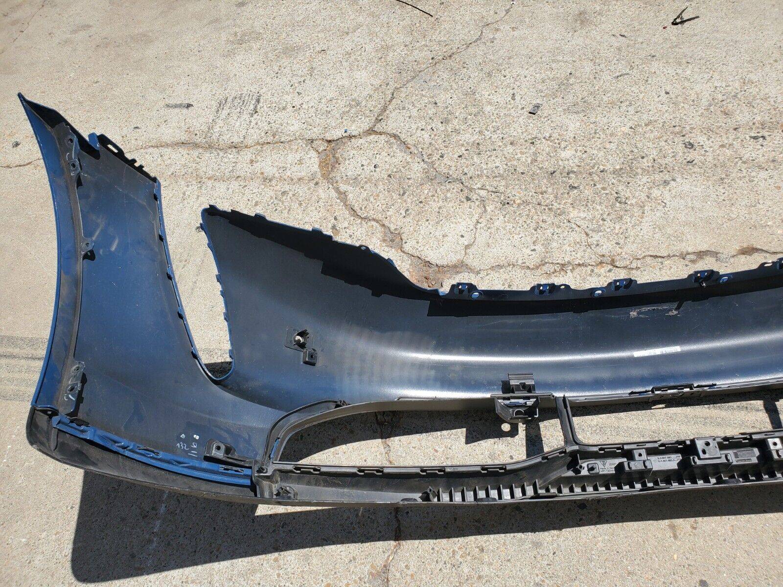

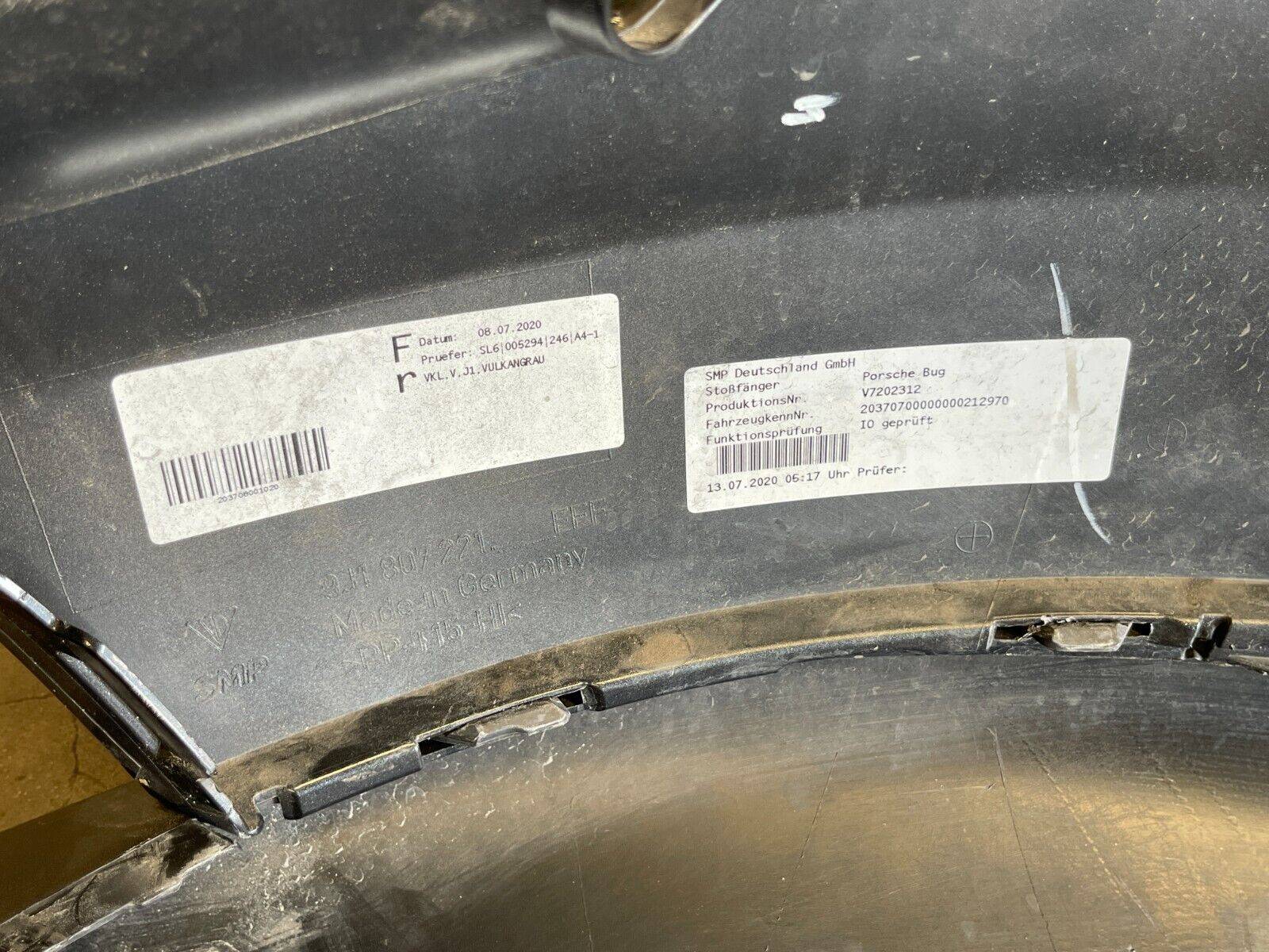

For stuff like this, I usually find searching used parts on ebay gives some good photos of what to expect in terms of fasteners, clips and locations. You already have the replacement parts, but for anyone else looking to tackle something they haven't done before. Here's a few I’ve come across:
Porsche Taycan Remove front lip front bumper

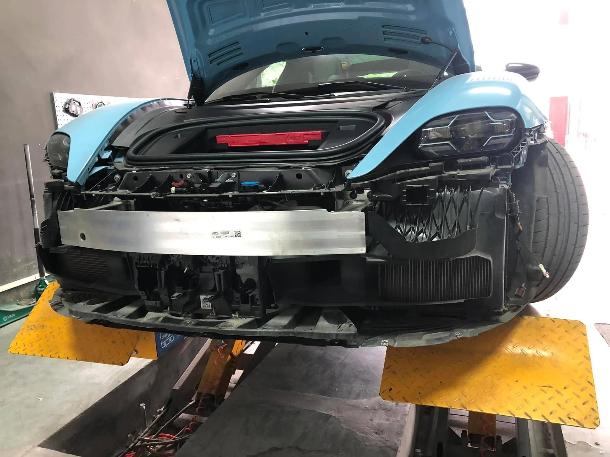

Where did that last photo come from? Interested to know as it shows a car with headlights, and wheels on with no bumper.

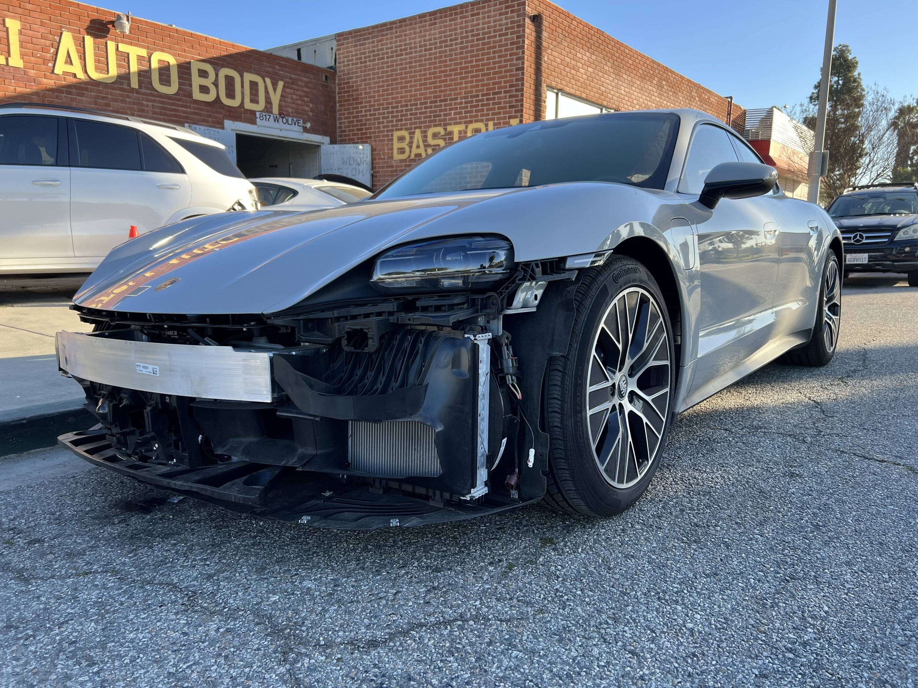

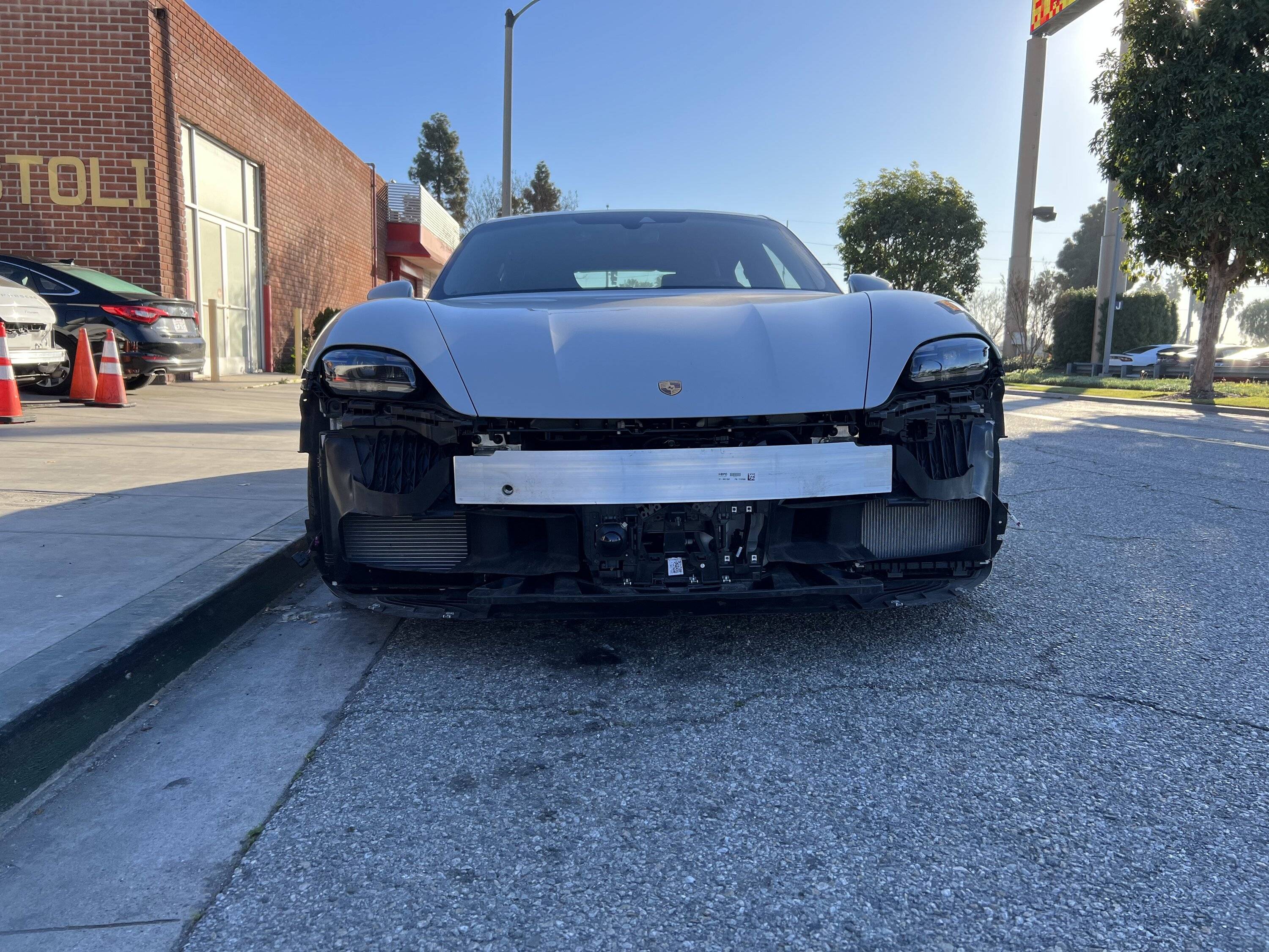

No idea if it will help, but here is my car with the front bumper taken off (for body repairs, not mods).
there’s a couple of YouTube videos showing guys removing the front bumper and taking the headlights off but I’ve never had to do this with any other car and I’ve done a few.
If the headlights don’t need to be removed neither do the arch liners or wheels potentially. On previous cars that I’ve owned you can usually turn the wheel and release a few screws from the edge of the liner and peel it back. From what I’ve seen you need to loosen a screw under the side repeater so it depends if you can get into this without removing the arch liner.
Videos showing the headlights coming out do so in order to free some clips below them from behind but on other cars I’ve worked on these clips can just be tugged free. It also looks like you could get a trim tool in from the front to help release them.
