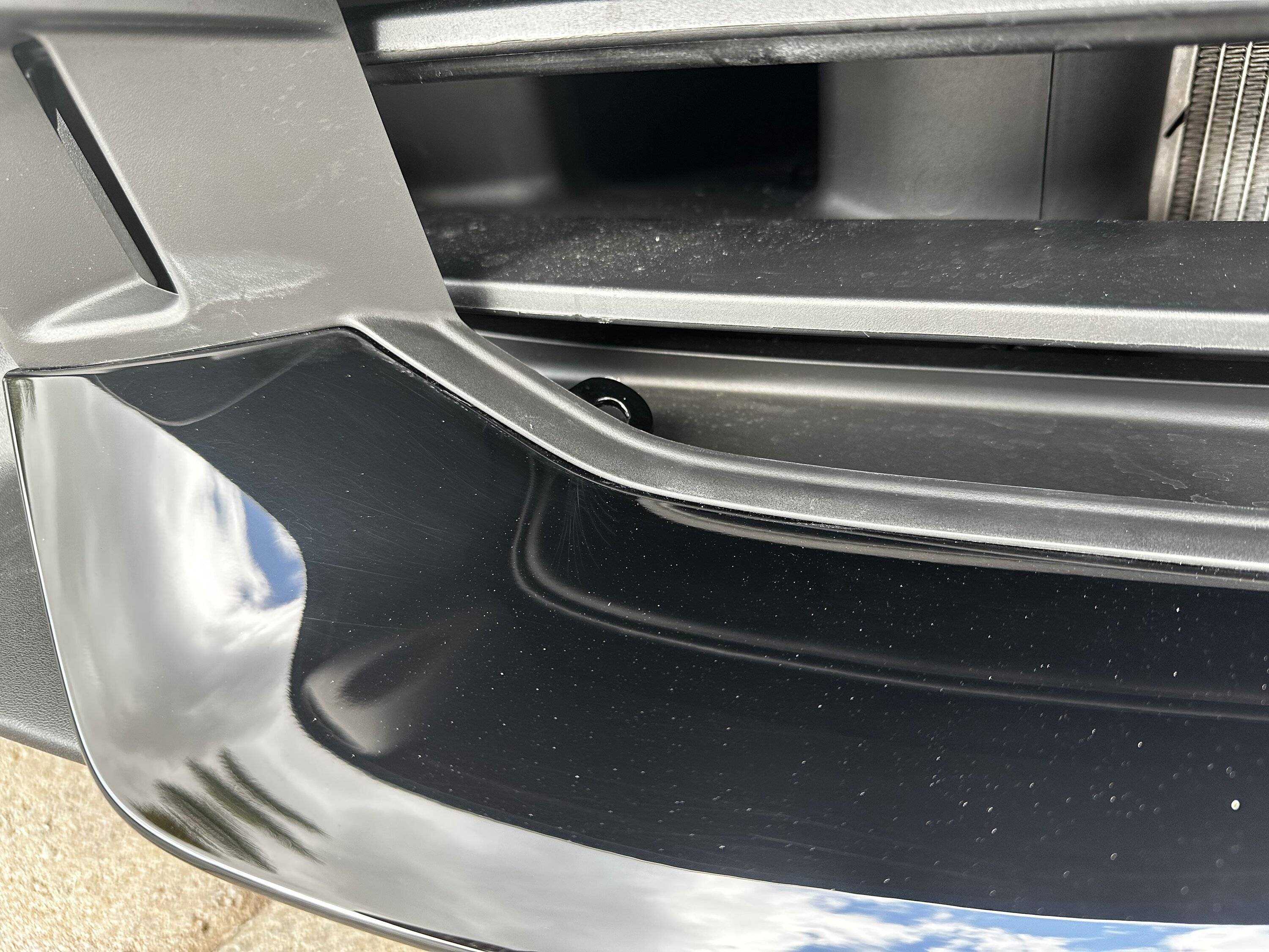

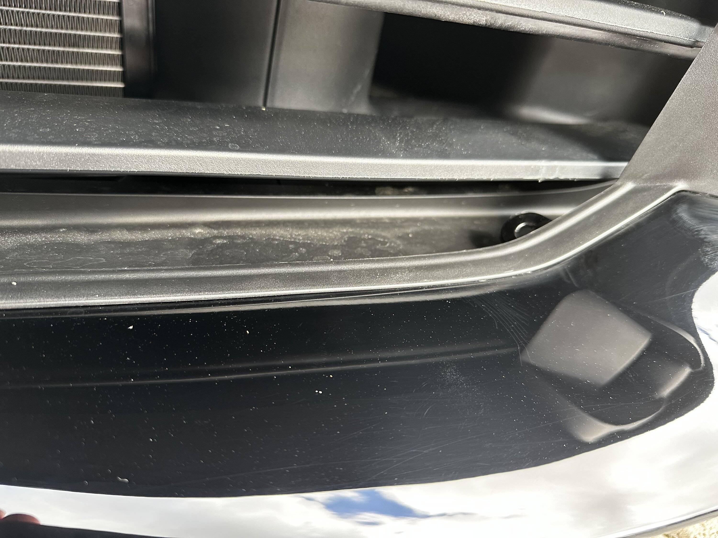

From what I have been able to deduce, the two tabs on the paintable inserts may have been provided as temporary tabs to allow for hanging the items to paint and are meant to be cut off prior to installation. My installer had the same issue with them being visible after install and could not deduce how else they could have been fitted at which point we figured that they were to be cut off.
Once again, congrats on the self install, not sure I would have had the stomach for it had I attempted on my own.
I have 15mm spacers for all 4 wheels ready to go on, hopefully the rears won't be a problem at 15mm.

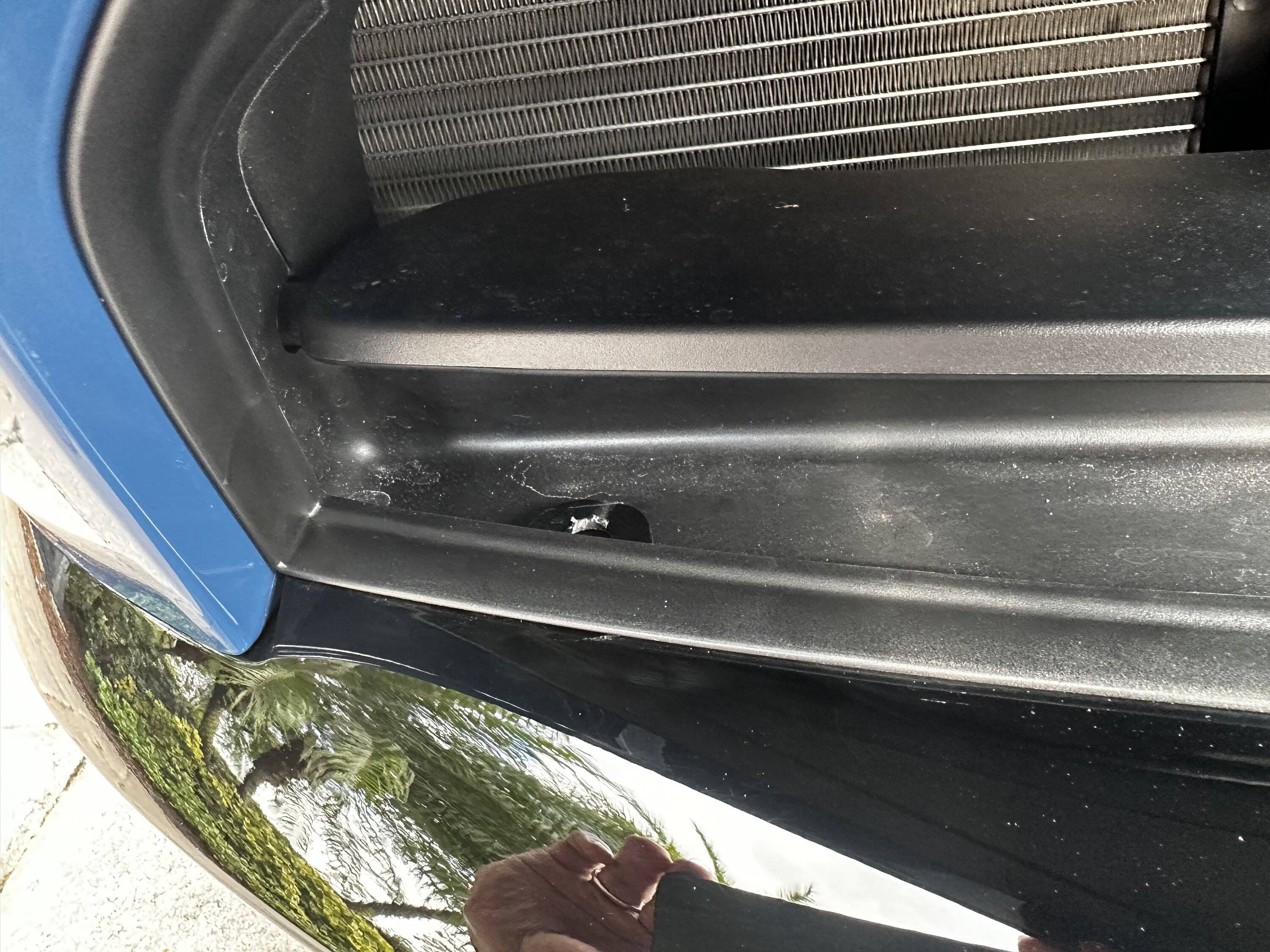

Pictured are the tabs I was referring to.
Yep same tabs. Not convinced it’s for painting seeing as mine were used and taken from another car.

Interesting, it was just a theory of mine
My own theory is that those tabs are supposed to fit under the frame for the motorised flaps that bolt on to the back of the grill but it’s too much hassle to explore it! (I’m not not 100% convinced I’m right!)

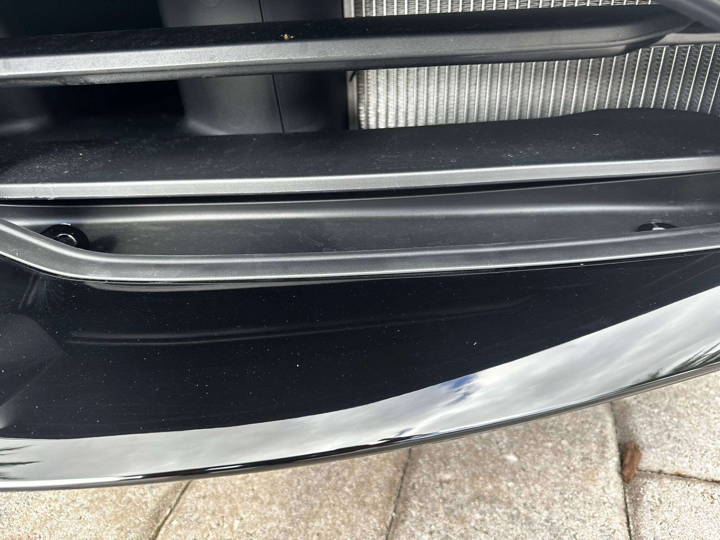

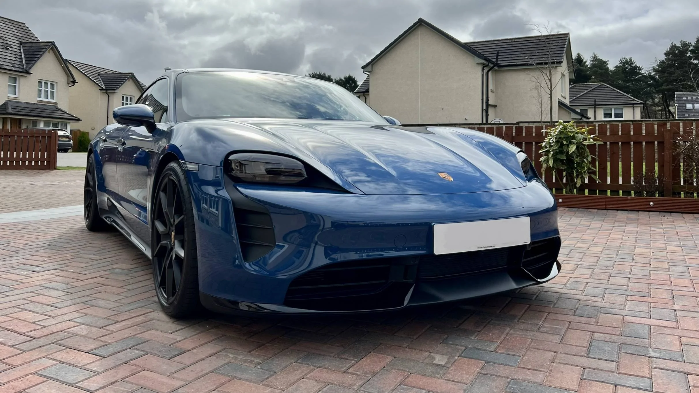

Here is the finished product, first picture is of the original front lip, and I'm sure all of you already know what that looks like, followed by pictures of the Turbo front lip conversion with the "wings" painted gloss black as my preference to match all the other gloss black on the GTS.
It is a subtle difference for sure, especially going with gloss black instead of body color, but it makes me happy!
Thanks for the pix, very smart! I have to admit I hadn’t realised there was a difference between them before.

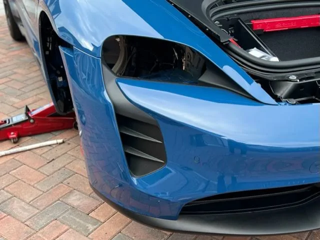

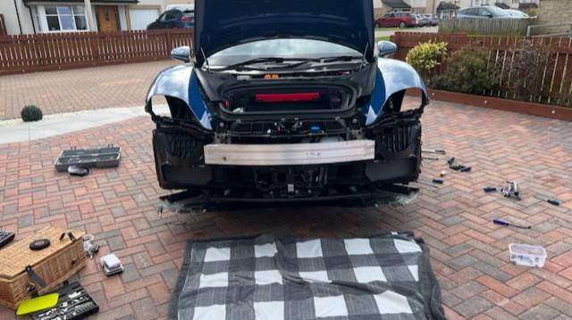

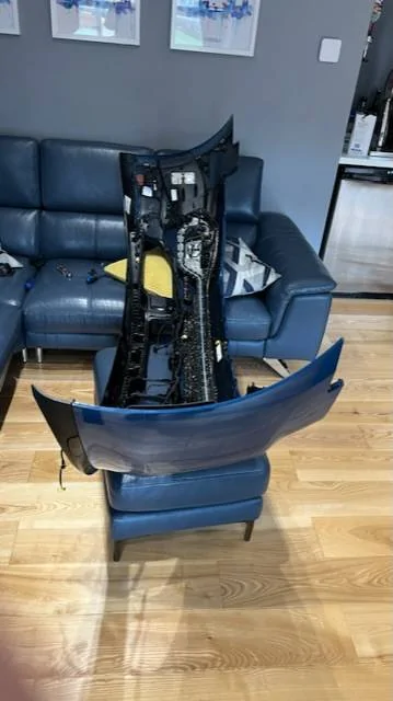

Just back from dinner and tidying up my tools (had to just chuck everything in the shed when I got finished earlier) and having another look at the front end. It’s a subtle change for sure but I have to say it really finishes the front end off. Photos don’t do it justice. I’m really pleased!
