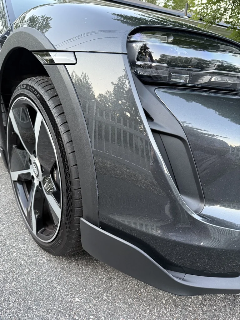

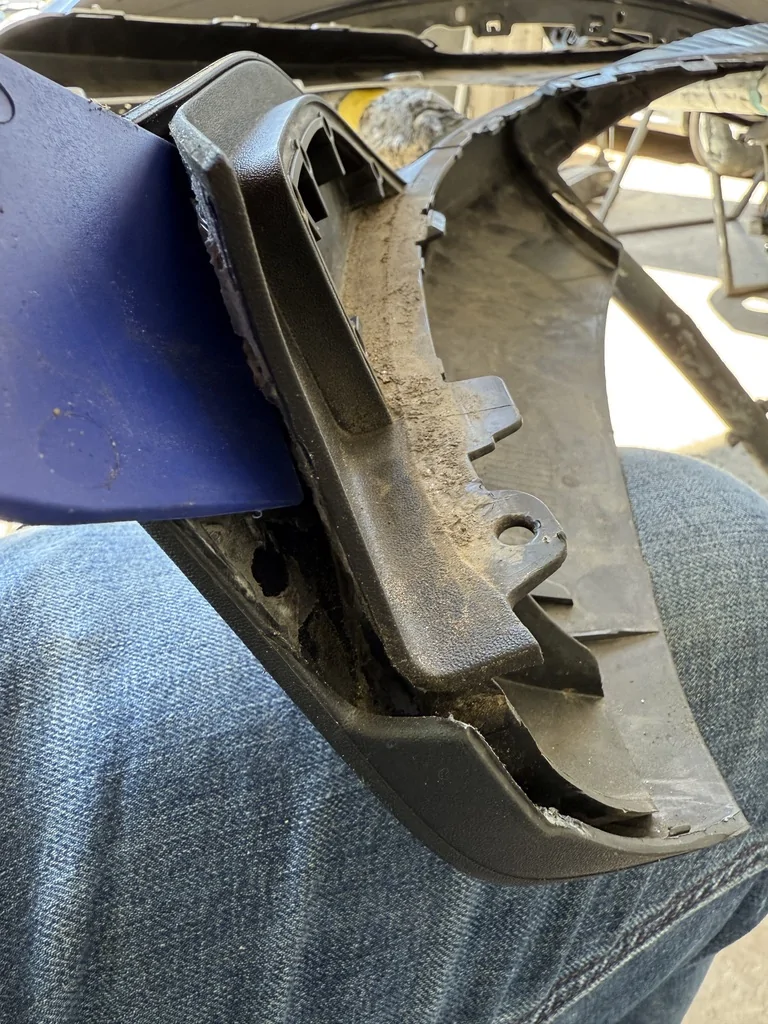

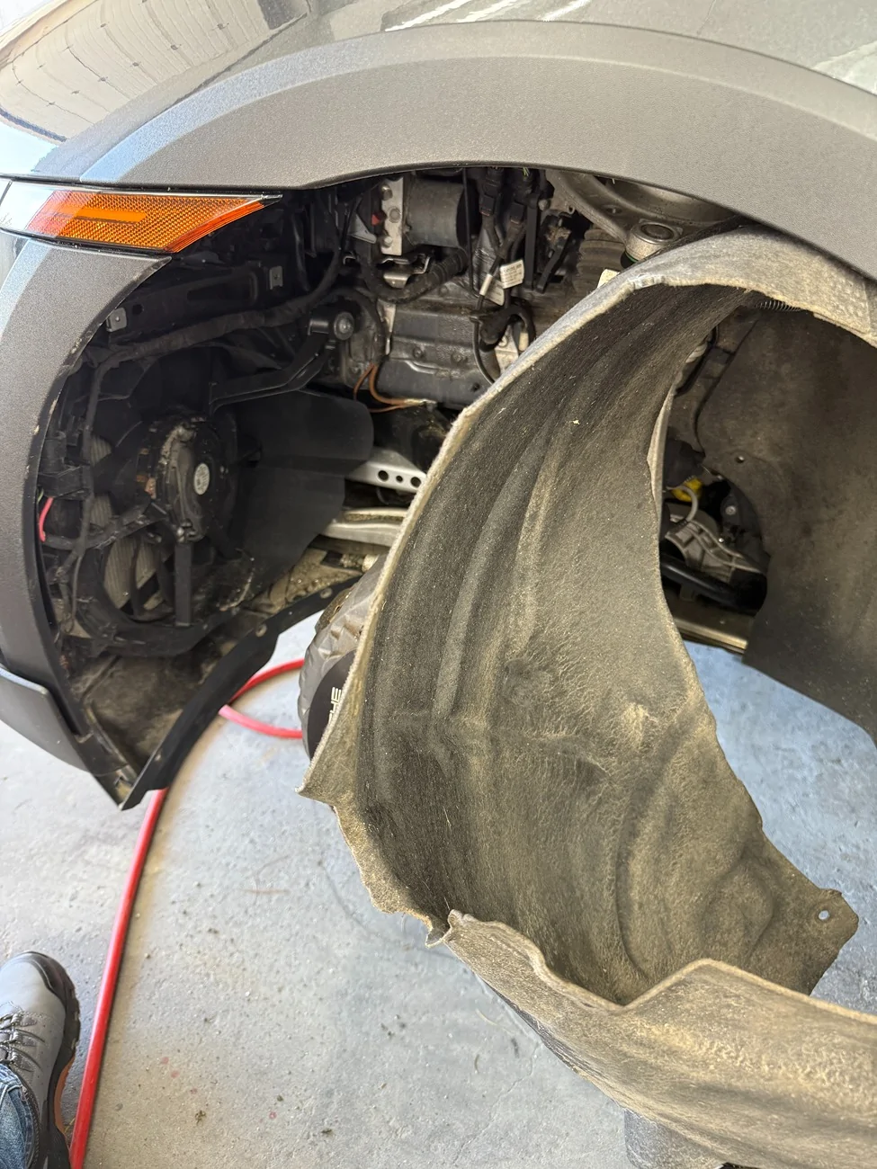

Posting a full DIY here because I could not find any good documentation... My first question was, do I actually have to remove the front bumper... conclusion? Yes you do. I watched a few youtube videos on how to remove the bumper, but honestly they sucked. I didn't make a video, but I did my best to track what screws were "Gotcha's" and there was really only one that almost screwed me. First, here's the damage my OCD wanted to fix... it isn't much but I am having the entire car wrapped this week and this was the opportunity to make the fix, the dealer wanted 6 hours and $650+ in parts, I later found out why the part total didn't match my expectation per the Porsche Diagram (item 3 in the image)
Porsche Taycan Replacing Front Lower Spoiler Cross Turismo Offroad Design Package Diagram
My Damage, passenger side lower left, it was really visible even from afar.
Porsche Taycan Replacing Front Lower Spoiler Cross Turismo Offroad Design Package 6059D088-32EE-4FEA-BC08-7F1445B442E1

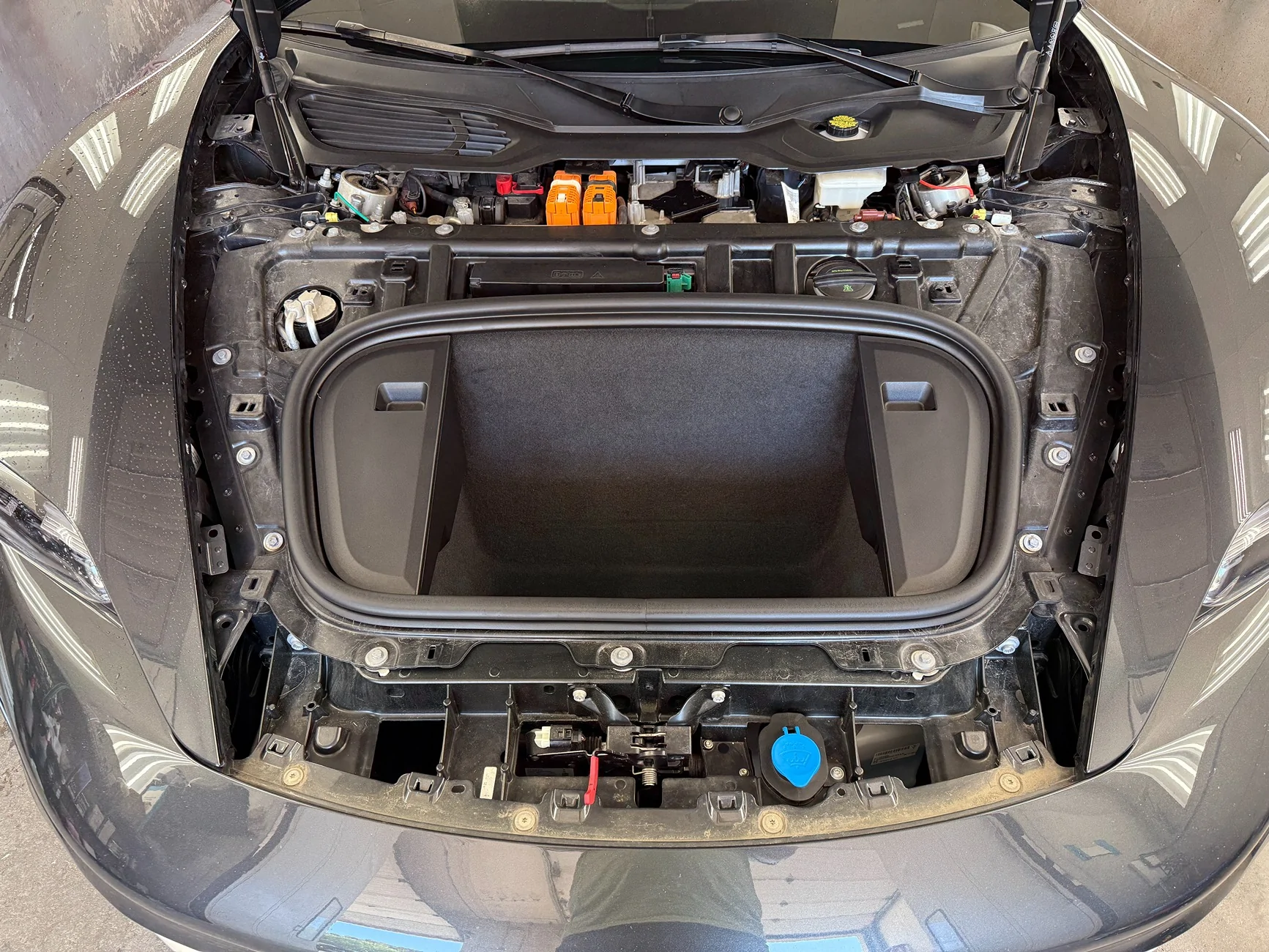

To start remove all the plastic under the hood:
Porsche Taycan Replacing Front Lower Spoiler Cross Turismo Offroad Design Package E9503F04-A6EC-439C-8871-D33A33761115
Only 4 torx screws to be removed here, mark their placement if you don't want to eyeball alignment when you put it back together.

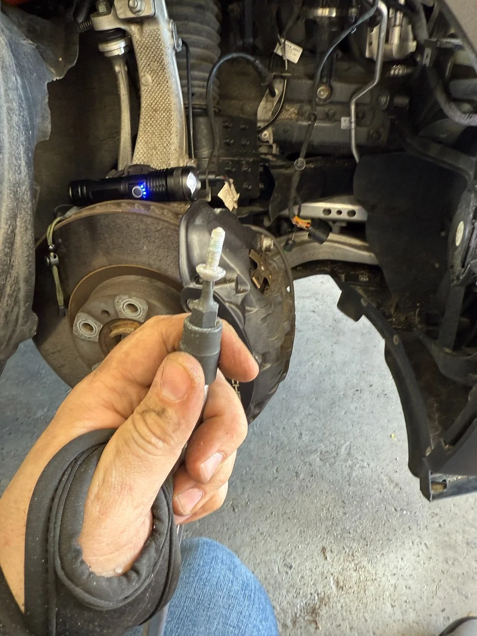

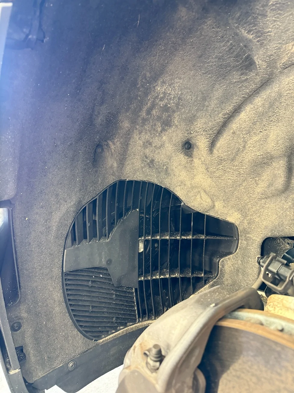

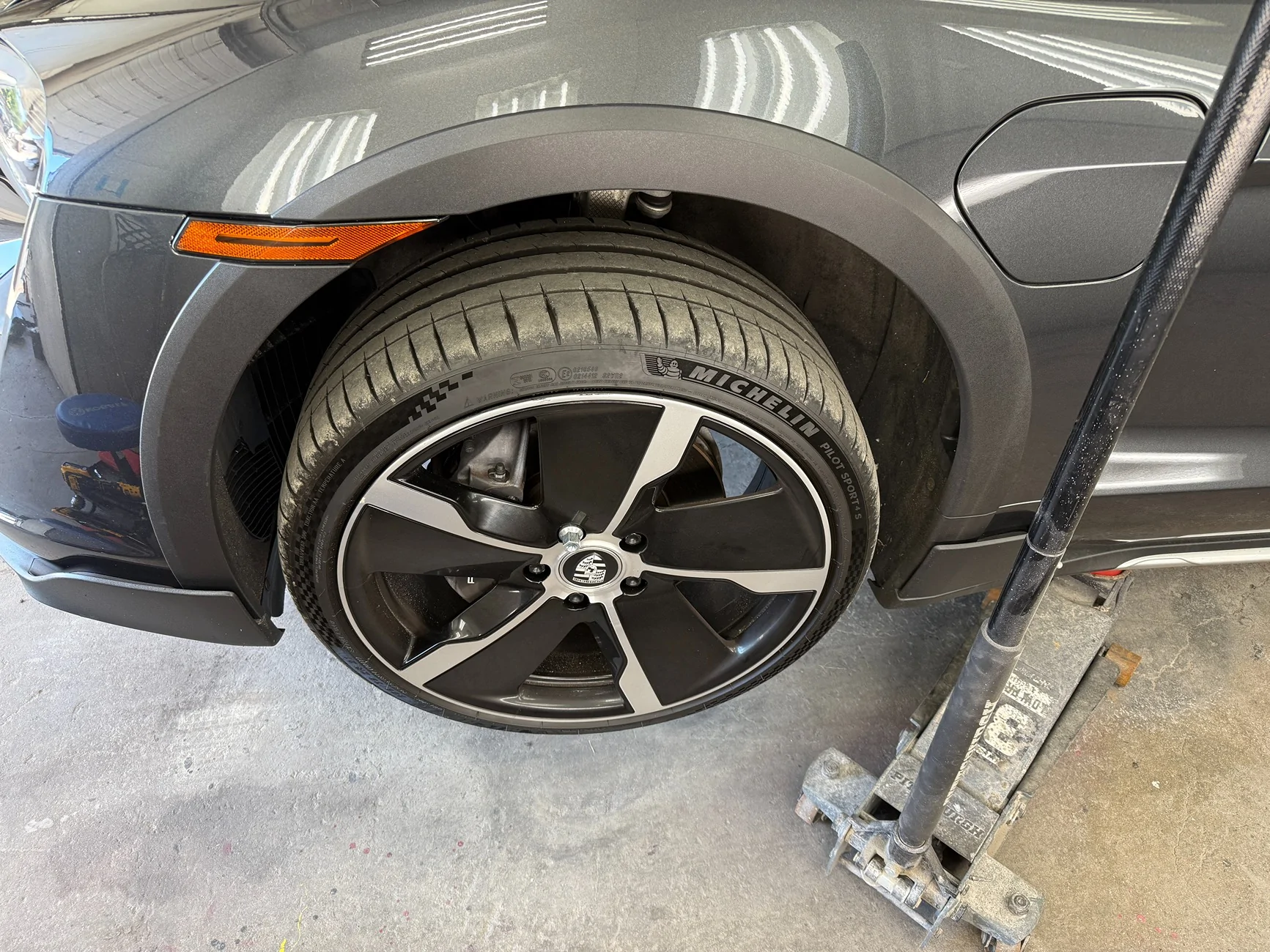

Next jack it up because the wheels and fender liner are coming off, pay attention to the Cross Turismo specific trim piece bolt on the top insider, don't over tighten when putting things back together you will break it (trust me).
Porsche Taycan Replacing Front Lower Spoiler Cross Turismo Offroad Design Package 67F25D4F-F8C7-4709-8C0C-47759CCDDFF1
Porsche Taycan Replacing Front Lower Spoiler Cross Turismo Offroad Design Package E35694D8-0DA4-4EDB-AB90-9CC526BEA2C6
Porsche Taycan Replacing Front Lower Spoiler Cross Turismo Offroad Design Package 2C2049F7-E3F9-47A9-81DF-843FEC0F0E94
Porsche Taycan Replacing Front Lower Spoiler Cross Turismo Offroad Design Package 5683AF49-A64F-4C36-9E3B-AE7D2F455000

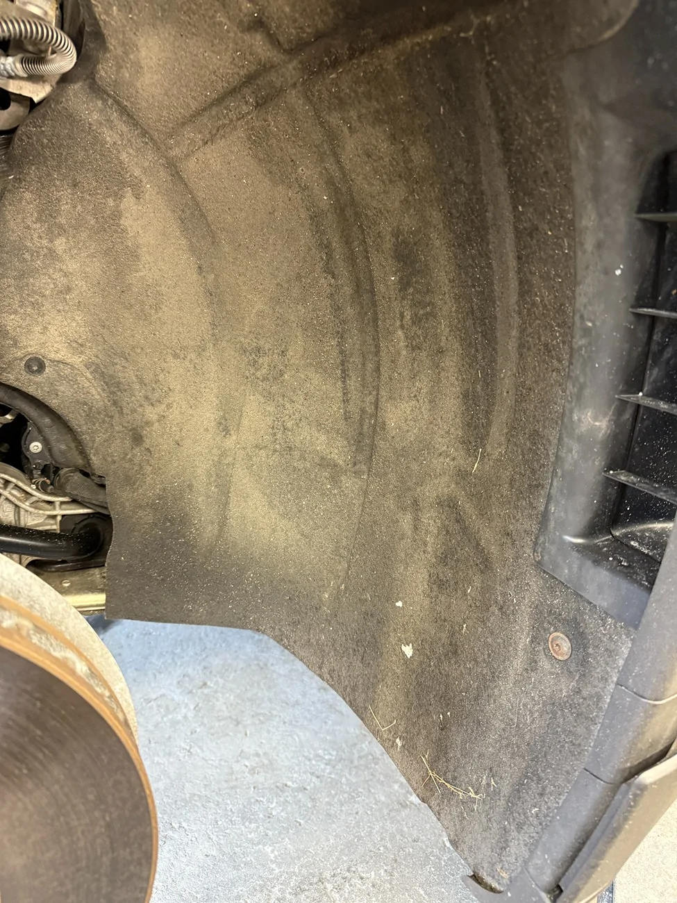

You can remove the entire liner, I just removed all but the back screws and pushed it behind the rotor, easier to align going back in.

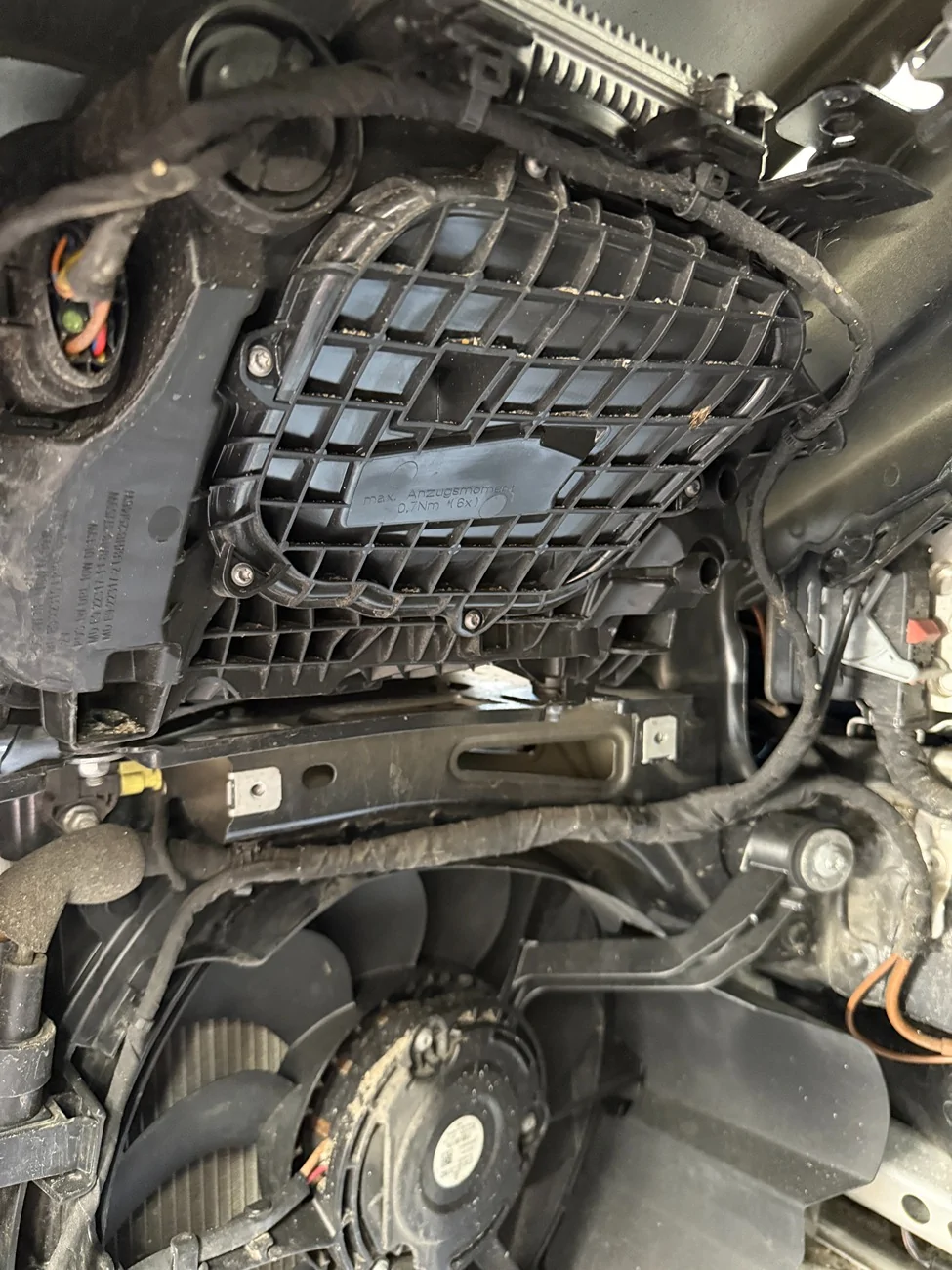

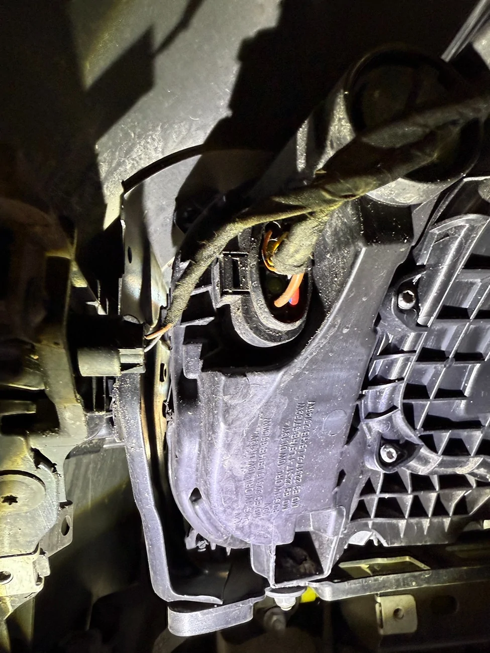

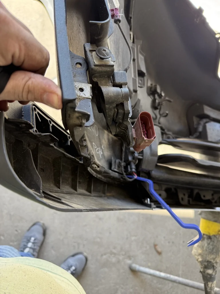

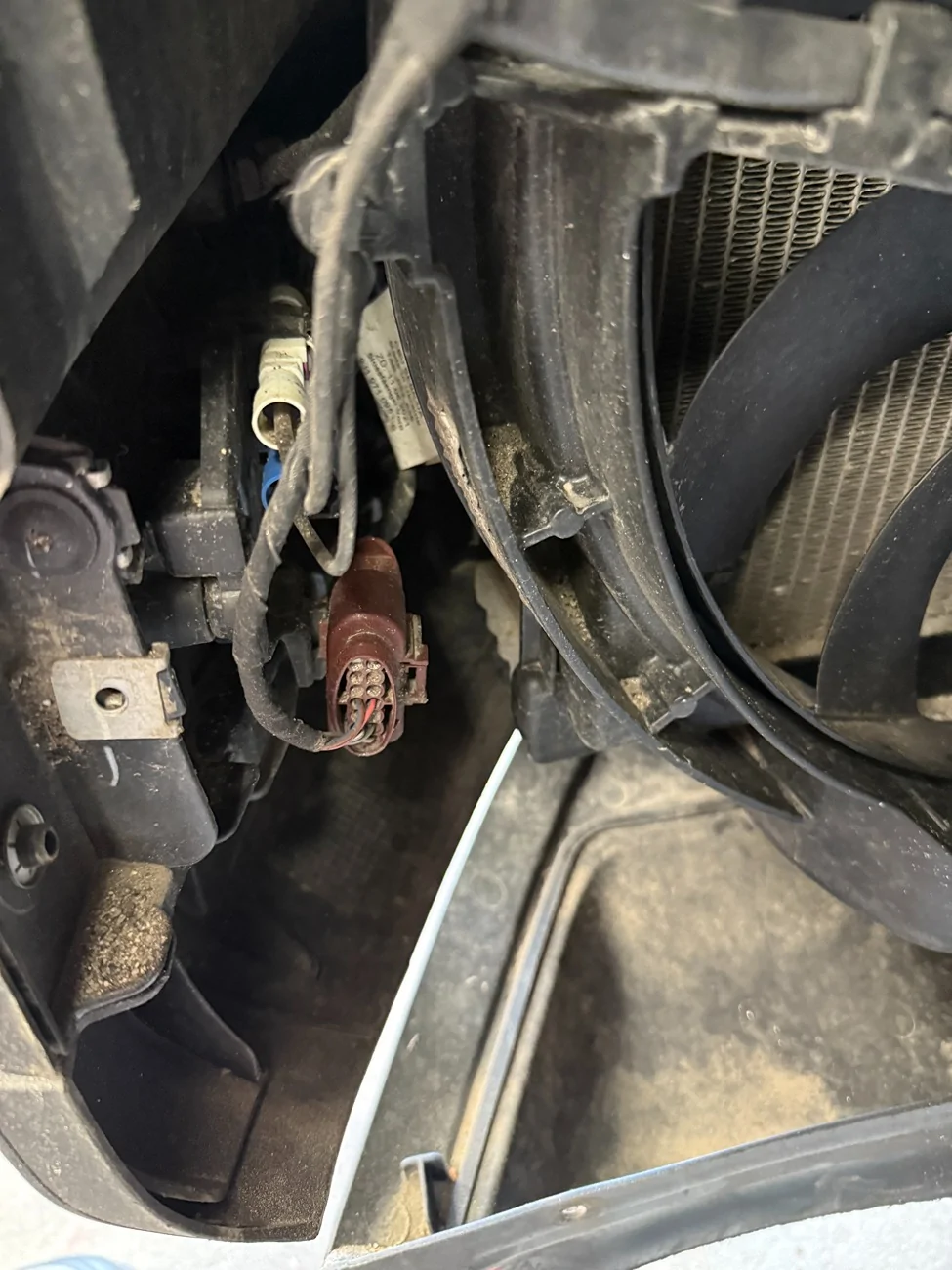

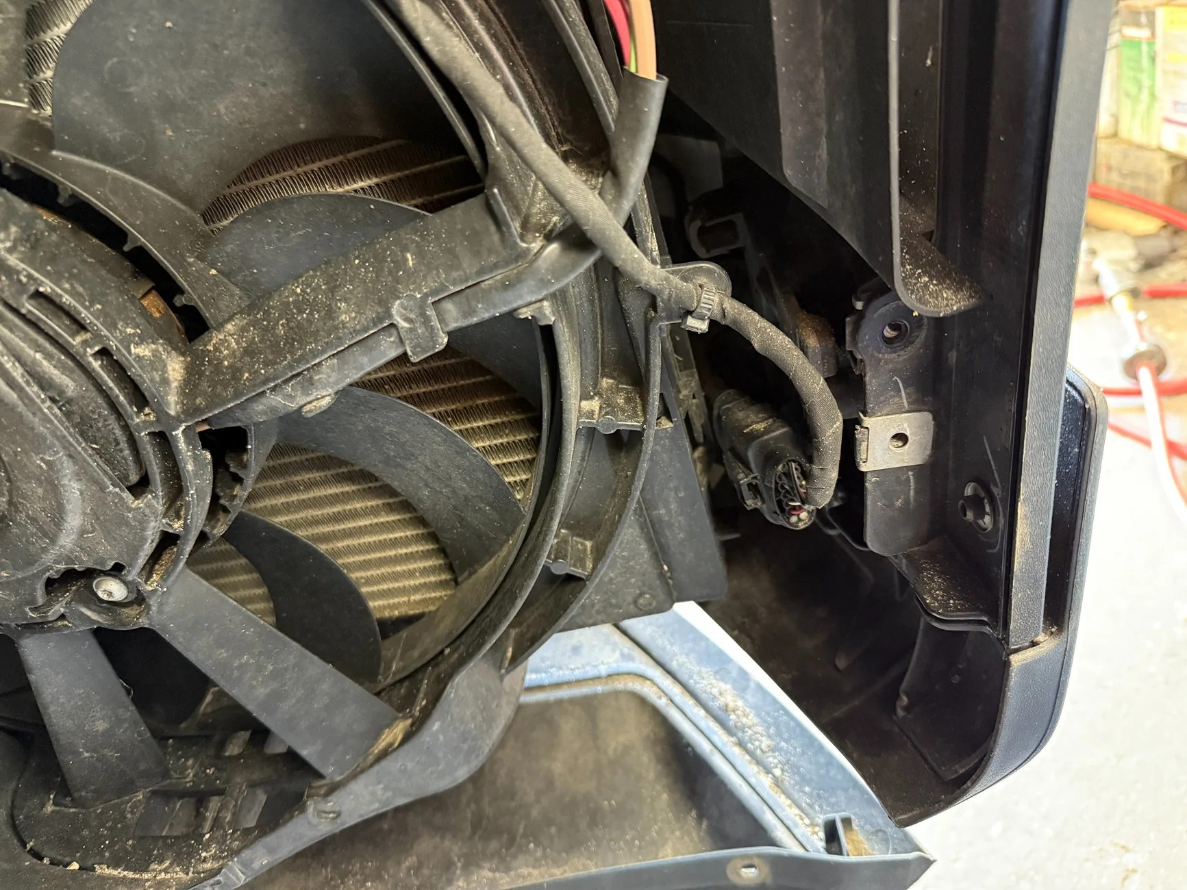

Next I undo all the cables and clips for the front camera, lidar, and park sensors. Disconnect the headlight and side markers. If you haven't already upgraded to clear OEM side markers, may as well do that now. Undo the wire clips dressing the headlight cable as well. You will need a 10MM to take the headlight out, only two nuts, confused the crap out of me because it doesn't seem very secure, AND there's a third tab at the top that aligns with a retaining nut and you would swear a bolt should go there, maybe for the other headlight style.
Porsche Taycan Replacing Front Lower Spoiler Cross Turismo Offroad Design Package E195187D-14F8-4951-9A59-0B478F84AD93
Porsche Taycan Replacing Front Lower Spoiler Cross Turismo Offroad Design Package 4A9C7BB3-4206-4C66-A8E4-0AEBB8AA4A29
Porsche Taycan Replacing Front Lower Spoiler Cross Turismo Offroad Design Package 83D4D6A2-B074-42BF-B730-1E780C56C6AD
After losening the 10mm nuts (don't remove them fully) the headlight just slides out, there are good Youtube videos for this.

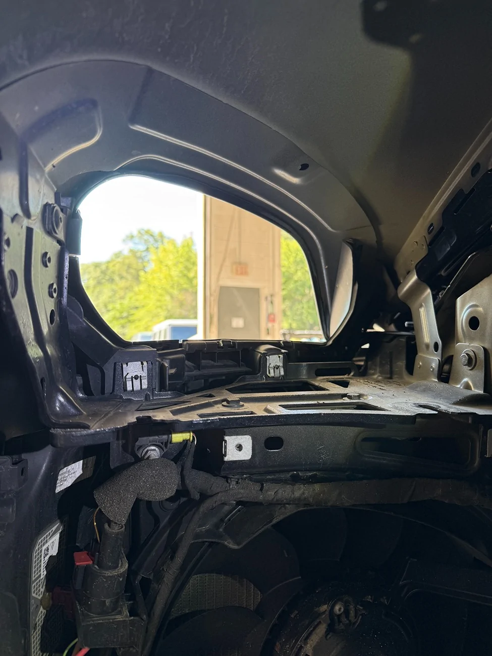

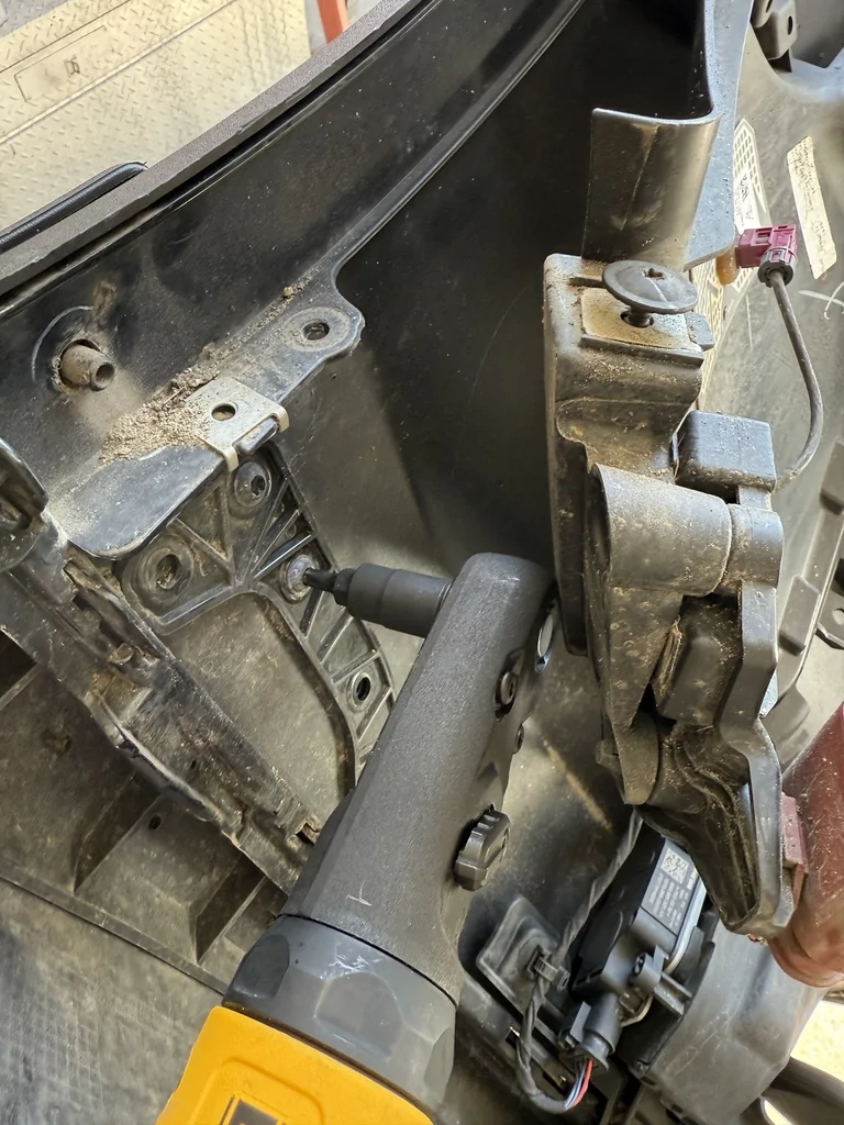

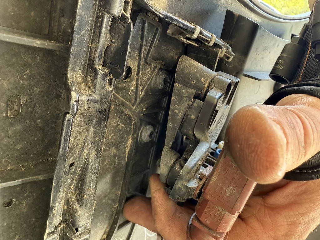

Now we get to the hardest to find and must be removed bolt that is the key to removing the bumper. It's up under the car between the headlight and side marker. These are the best I could do to get photos.
Porsche Taycan Replacing Front Lower Spoiler Cross Turismo Offroad Design Package 7B2CCF80-58D6-4E04-A61E-0DB37A2A3A4C
Porsche Taycan Replacing Front Lower Spoiler Cross Turismo Offroad Design Package C97ED0CD-7087-463C-95AC-21CAAF87258A
Porsche Taycan Replacing Front Lower Spoiler Cross Turismo Offroad Design Package 908E6707-DDB9-47C3-BE52-35CA96DB4CDF

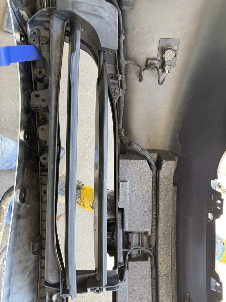

Photo of the connector for the front hand sensor there --
Porsche Taycan Replacing Front Lower Spoiler Cross Turismo Offroad Design Package 632D95D8-66A1-4122-86A3-2F36A3C9AE84

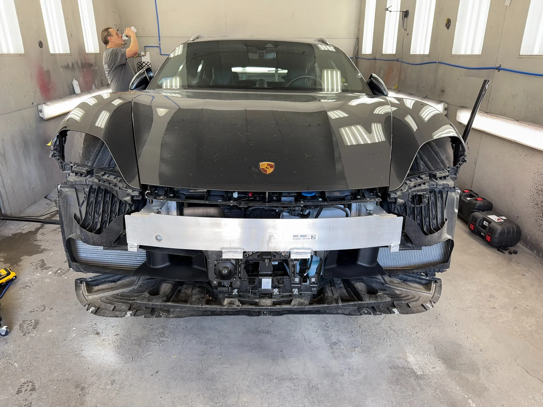

Now there's 4 tabs, 2 under each headlight hole holding the entire bumper on you will want a second person otherwise your bumper will come crashing to the ground, you release these tabs from the front and push down on the back while pulling forward from the corner where the sidemarker lights were.
Porsche Taycan Replacing Front Lower Spoiler Cross Turismo Offroad Design Package 10671653-8549-45C4-8D50-AF1528045C59
Porsche Taycan Replacing Front Lower Spoiler Cross Turismo Offroad Design Package 3D14FFEB-5900-48A5-BB3E-D6B002201098

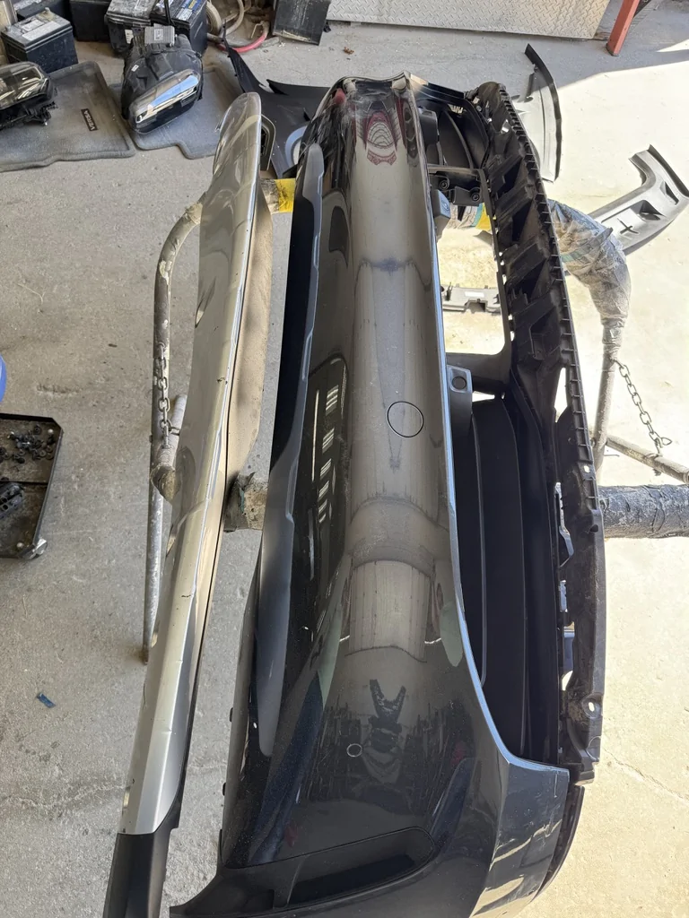

Now you are ready for the main act, replacing the spoiler...
Edit: Continued...
Now for the main act, and the justification that you cannot remove the CT OFDP spoiler without removing the bumper. Plus the big mistake I made that you shouldn't make with this knowledge.
Porsche Taycan Replacing Front Lower Spoiler Cross Turismo Offroad Design Package 2559C481-8BD9-403A-8AD9-7D8C11F032C2_1_105_c

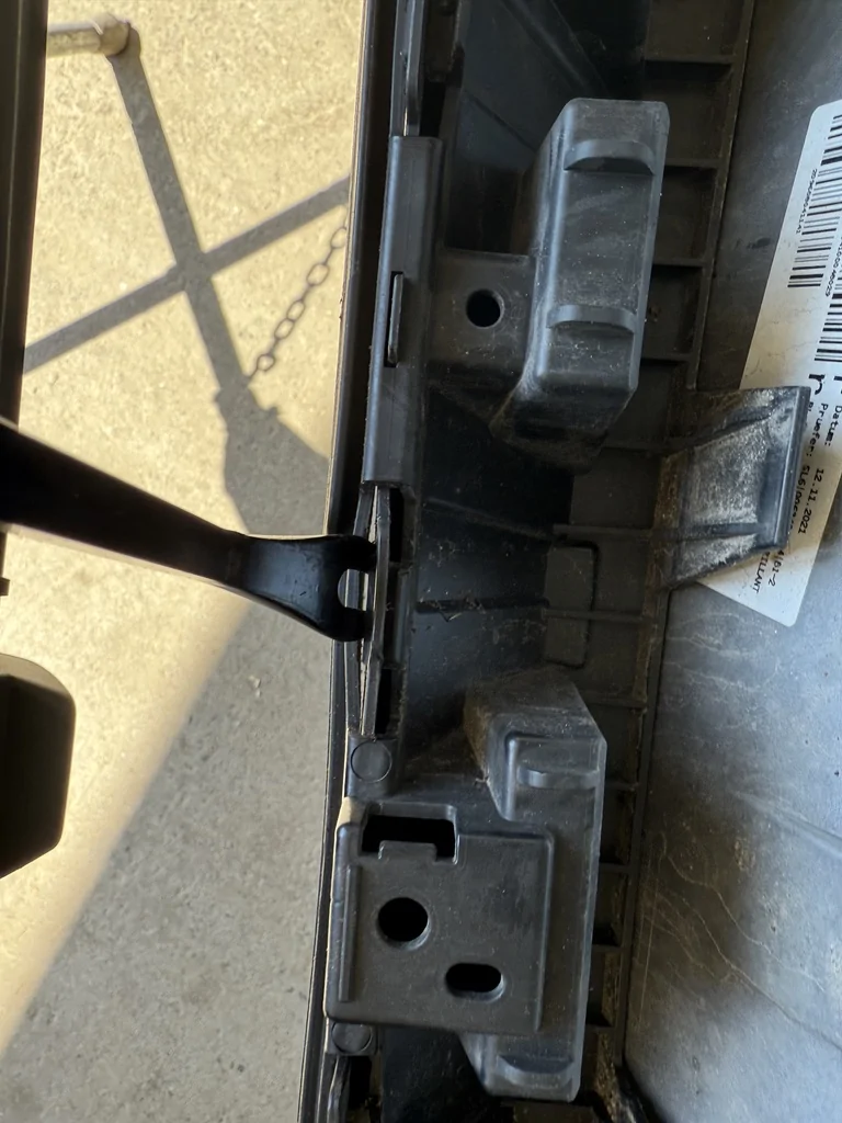

Start by removing the Jesus retaining clip from the plastic wheel arch guards. I used a pick from my panel removal took kit and slowly wiggled it off... if you break this aligning your wheel arch plastic should you ever need to change it will be very hard.
Porsche Taycan Replacing Front Lower Spoiler Cross Turismo Offroad Design Package 65236FB9-DE49-4D05-B970-9255F11C0285_1_105_c

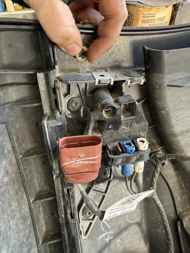

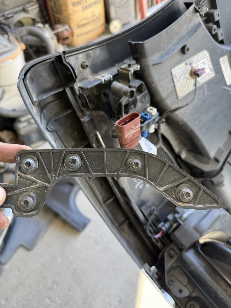

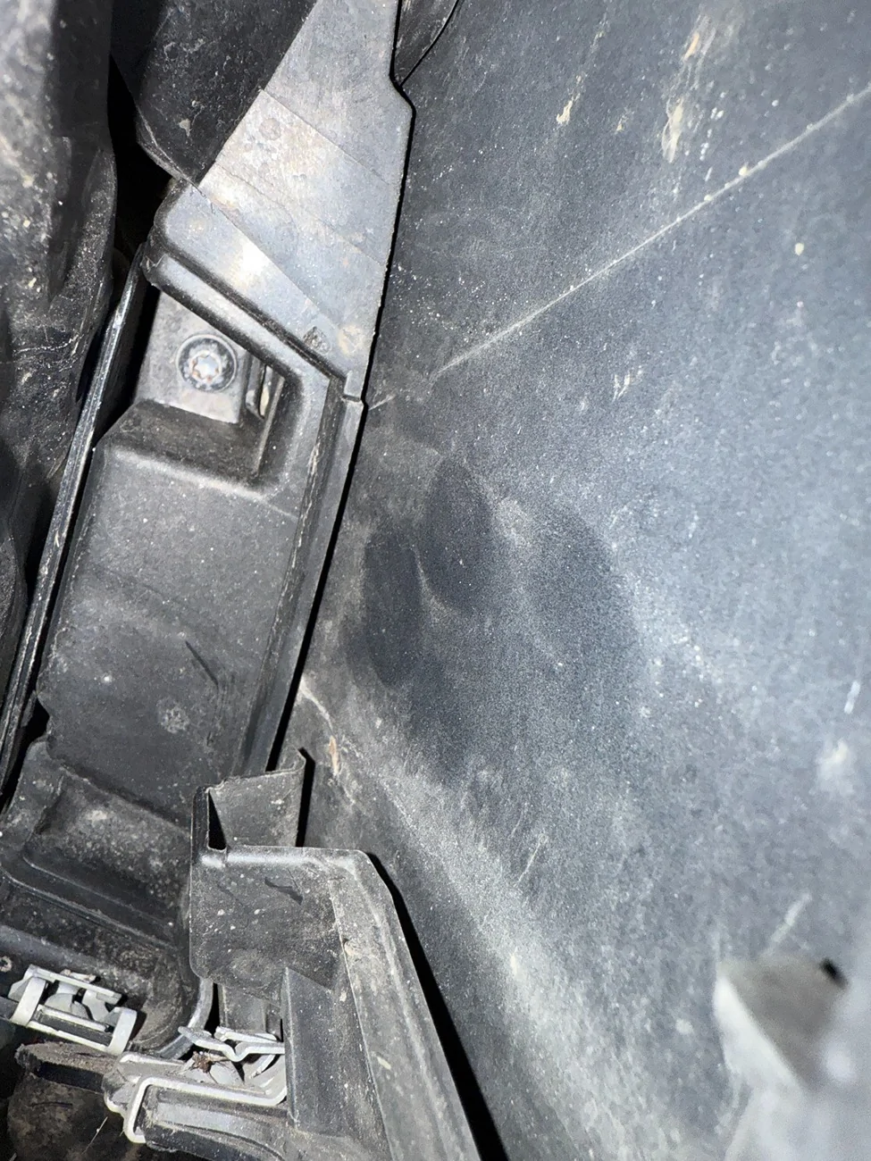

Next I removed all the bolts I could see under the fiber/bumper sensor connector bracket. and started carefully prying the clips off. All of these clips require opening the bottom then top and prying at the same time. Go slow, you don't want to break these, after you figure out the first few it goes fast.
Oh but wait, some jerkhead engineer put more screws under the connector bracket, so remove it to get to those...

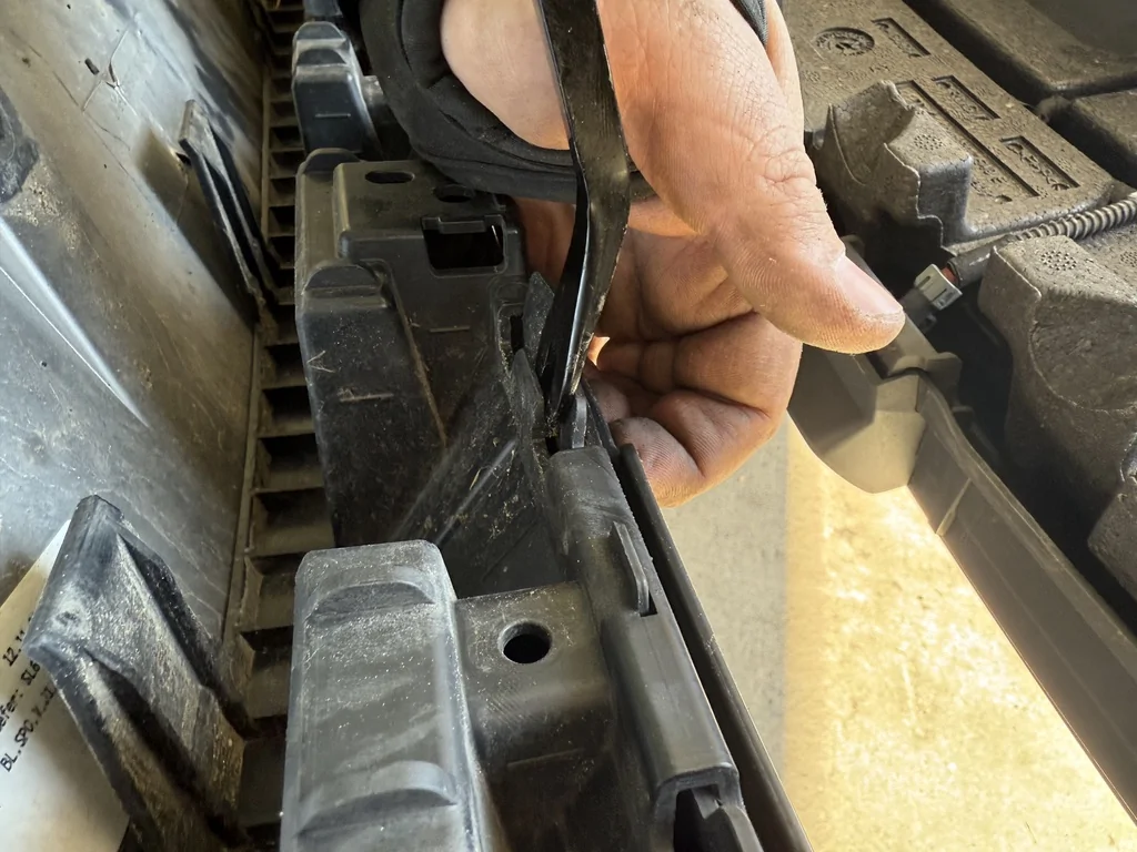

Back to left to right working clips out for the bumper cover.
Porsche Taycan Replacing Front Lower Spoiler Cross Turismo Offroad Design Package A75CC865-63D9-400E-B846-9544C3D1D9CE_1_105_c
When you get to the automatic shutters, you will need to remove a few bolts and bend it up gently to keep accessing clips...
Porsche Taycan Replacing Front Lower Spoiler Cross Turismo Offroad Design Package 685F0E4E-CD5A-48BE-80A3-DC252DC8F59B_1_105_c
Porsche Taycan Replacing Front Lower Spoiler Cross Turismo Offroad Design Package 21BB5678-DE14-424F-9799-8B53E111FD8A_1_105_c
Porsche Taycan Replacing Front Lower Spoiler Cross Turismo Offroad Design Package BA14547A-739B-4950-9491-96398CCFD31E_1_105_c
Porsche Taycan Replacing Front Lower Spoiler Cross Turismo Offroad Design Package 750ED087-6C04-4233-8372-68E4BE363E36_1_105_c
Porsche Taycan Replacing Front Lower Spoiler Cross Turismo Offroad Design Package 9E00E88C-099D-4604-96B4-CB0CFFA7F85F_1_105_c
Porsche Taycan Replacing Front Lower Spoiler Cross Turismo Offroad Design Package 4027DF43-BA11-47CB-B375-4E0E2EB03BD9_1_105_c
Porsche Taycan Replacing Front Lower Spoiler Cross Turismo Offroad Design Package 82F9BDD2-6A3E-4CBF-9A71-E0703F62CF68_1_105_c
Porsche Taycan Replacing Front Lower Spoiler Cross Turismo Offroad Design Package 953C6BE8-0684-48BC-A6B3-DB0217A8D73A_1_105_c

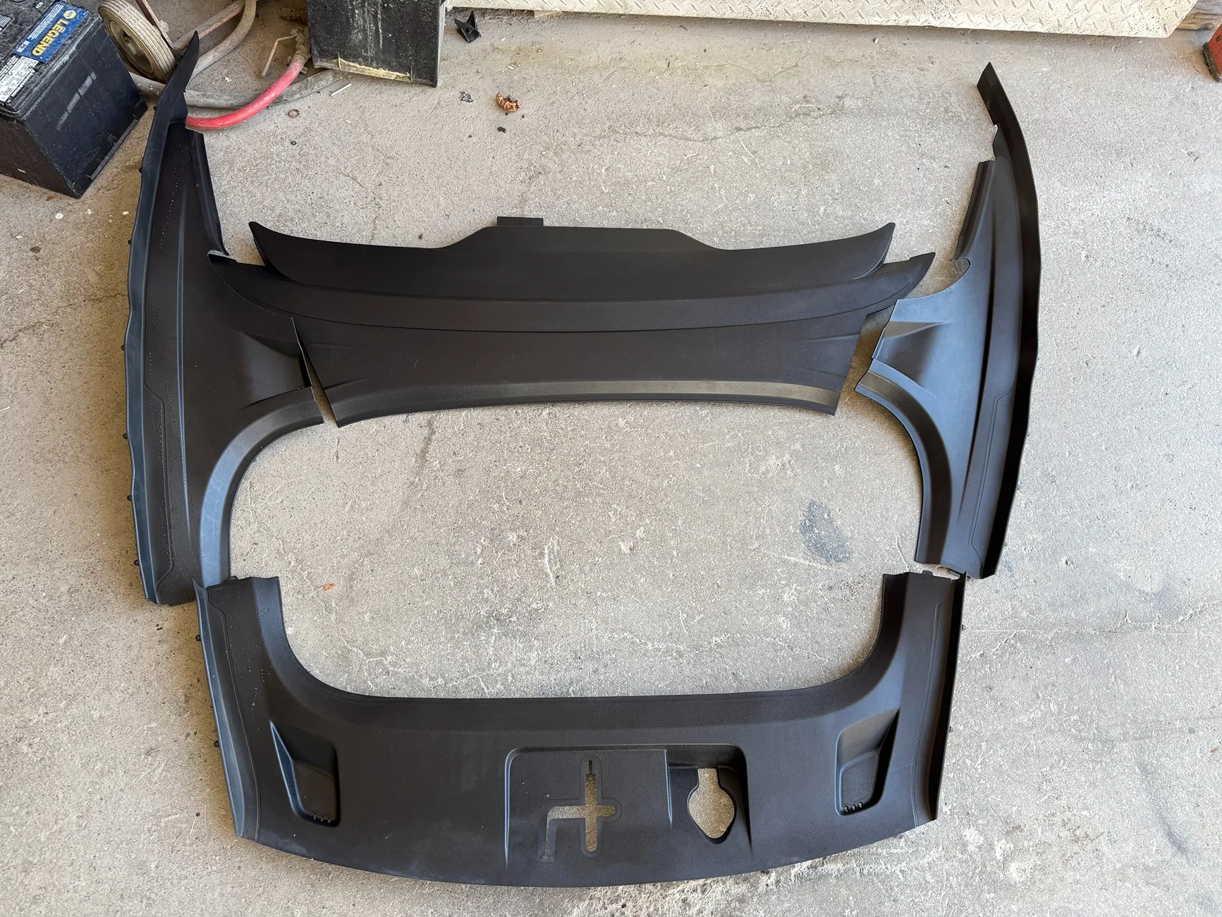

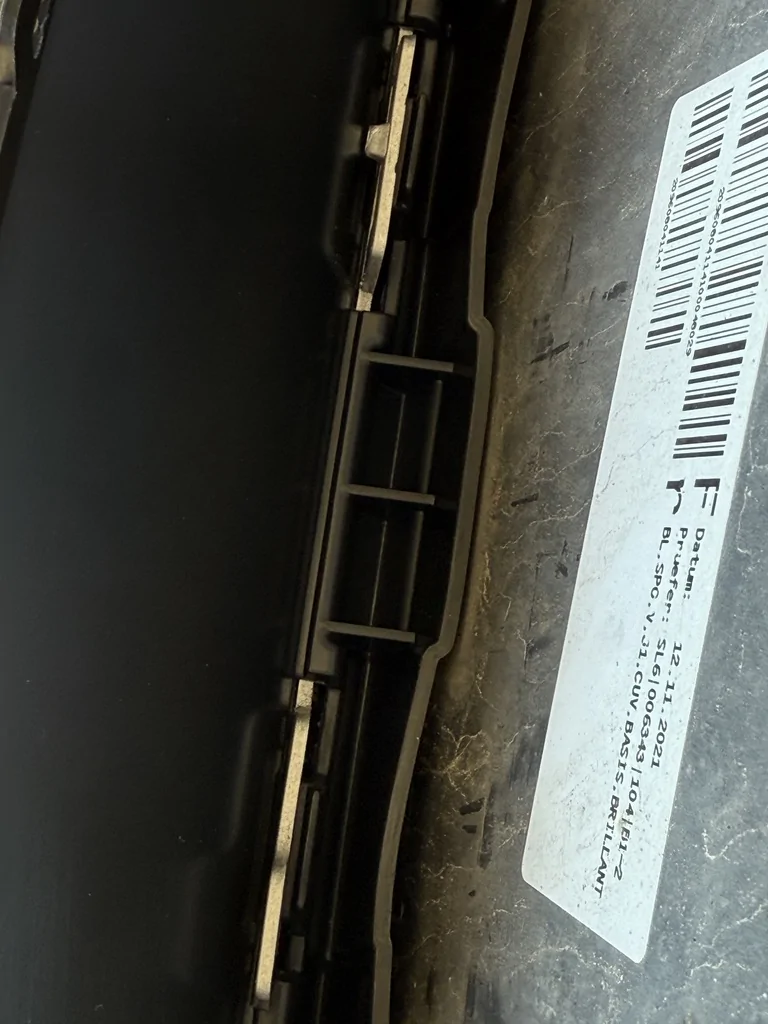

I probably missed some clip photos, but you get the jist... You will now finally have things separated. Phew.
Porsche Taycan Replacing Front Lower Spoiler Cross Turismo Offroad Design Package 9A85038E-5316-43DB-9788-91D49A8677DF_1_105_c

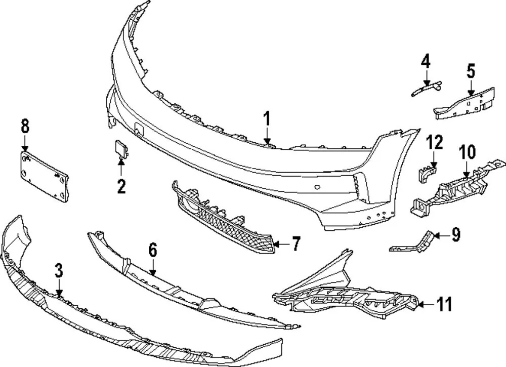

Now let's jump back to the diagram, this is the replacement part I bought from Porsche based on their recommendation per my VIN number. Item Number 3 in the diagram.
Porsche Taycan Replacing Front Lower Spoiler Cross Turismo Offroad Design Package B638663C-2805-462A-A409-B9FA2CF197E7_1_105_c

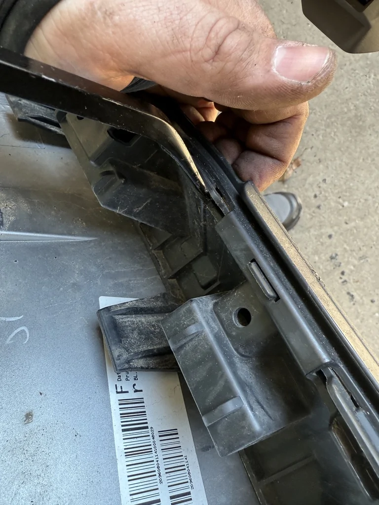

BUT Item #5 has both a Left and Right, and you want to order that as well... DO NOT MAKE THE MISTAKE I DID OF NOT HAVING THE ATTACHMENT BRACKETS FOR L/R ITEM #5 YOU HAVE BEEN WARNED....
Porsche Taycan Replacing Front Lower Spoiler Cross Turismo Offroad Design Package 1756050284972-12

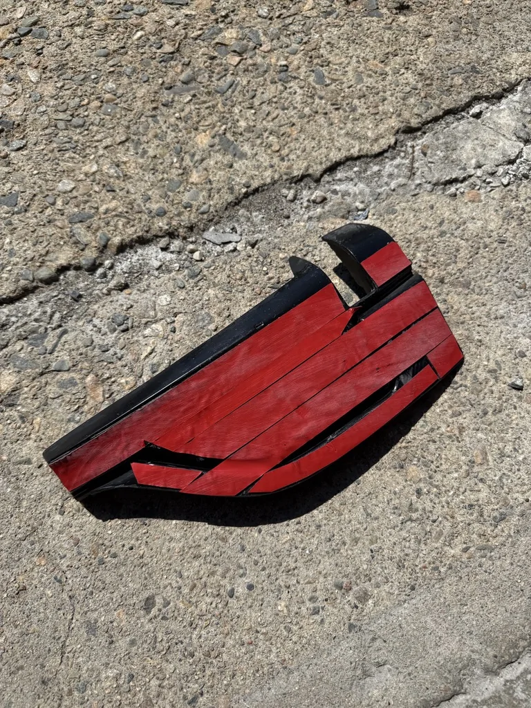

BUT... if you didn't listen... and you are missing #5 L/R here's how to reuse the ones on the car... the following images may cause you physical discomfort...

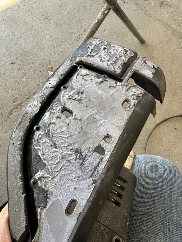

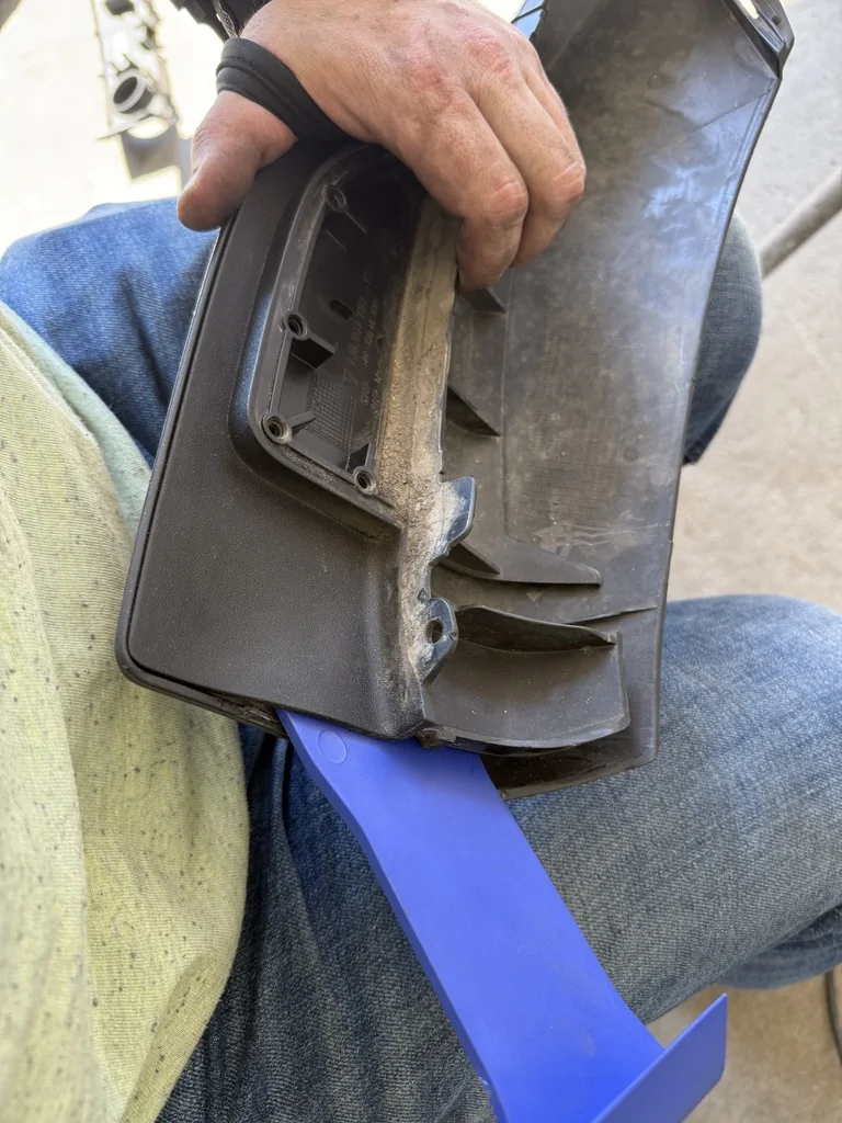

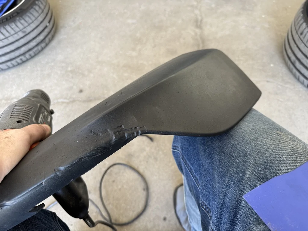

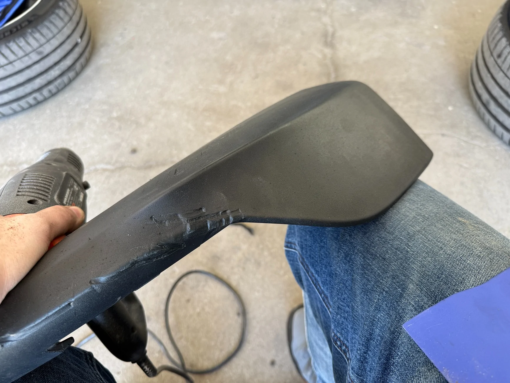

Heat gun helps a lot, this is some nasty VHB stuff... Now you are left with this mess...
Porsche Taycan Replacing Front Lower Spoiler Cross Turismo Offroad Design Package 95A0AC59-16CD-47FD-9E65-F488594BD081_1_105_c
It all has to come off, don't call OSHA or BSA on me.
Porsche Taycan Replacing Front Lower Spoiler Cross Turismo Offroad Design Package 0A1077B9-92B6-454A-8B79-A4A7DF8FC0B5_1_105_c
Now we soaked it in thinner and the sun to get it all off, then we put adhesion promotor and automotive grade OEM spec VHB.

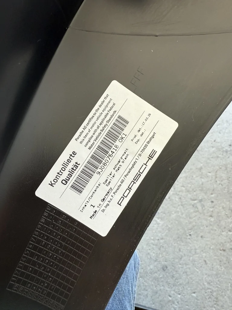

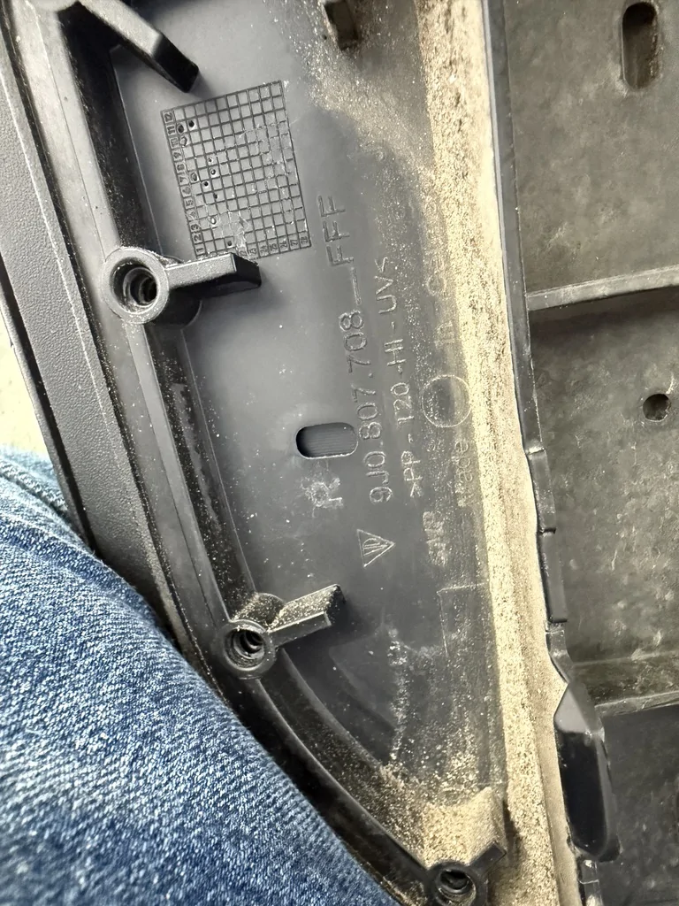

As a follow-up to my last question, it does look like I missed the 2 side retaining brackets that @sb89 referenced in his post and had to reuse.
Here are the part numbers for those in case anyone is doing this:
9J0-807-708-OK1 - Right side
9J0-807-707-OK1 - Left Side
9J0-807-541-B-OK1 - Spoiler

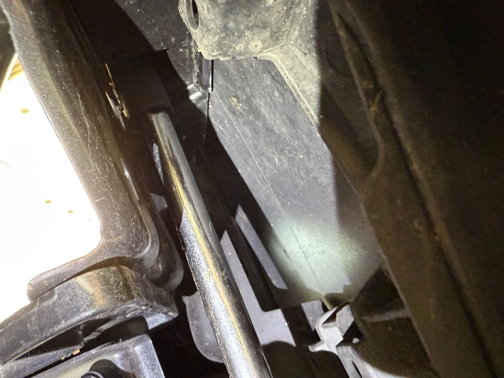

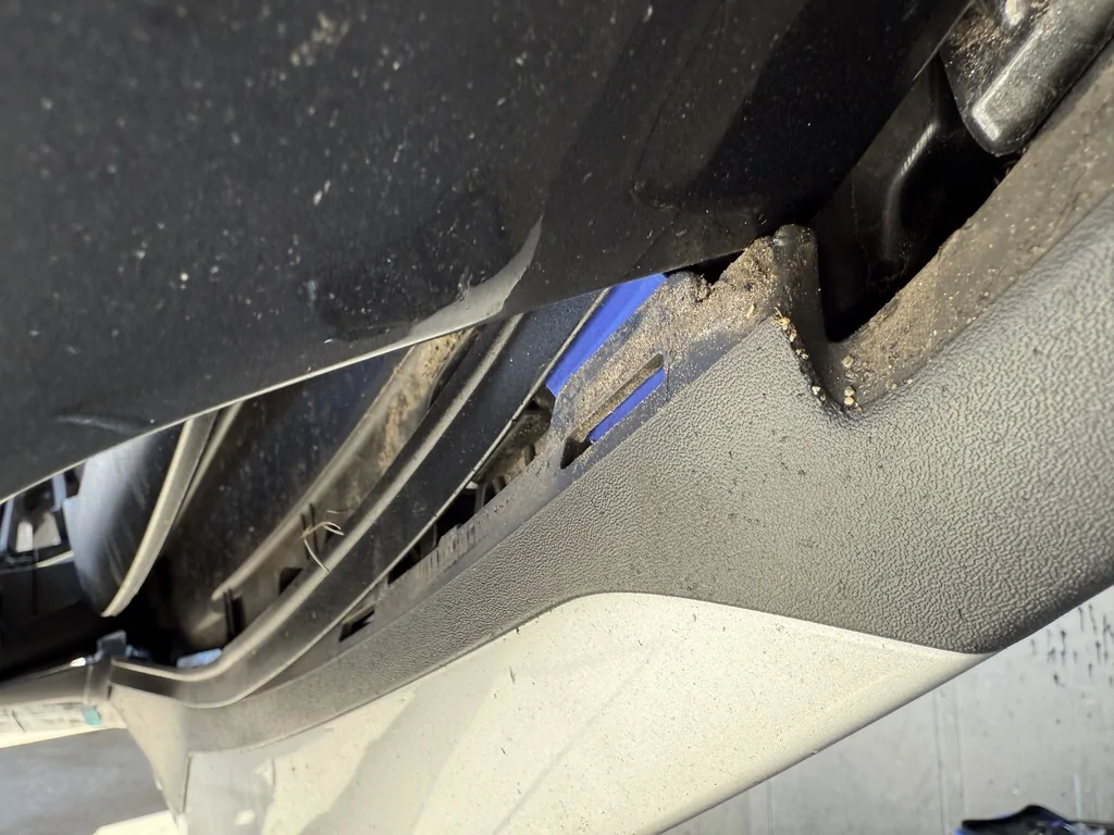

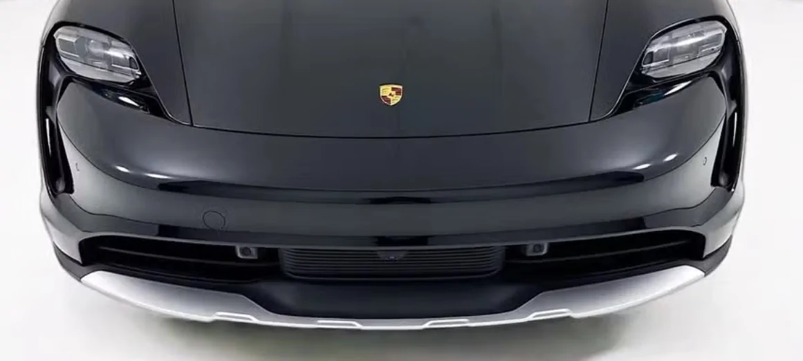

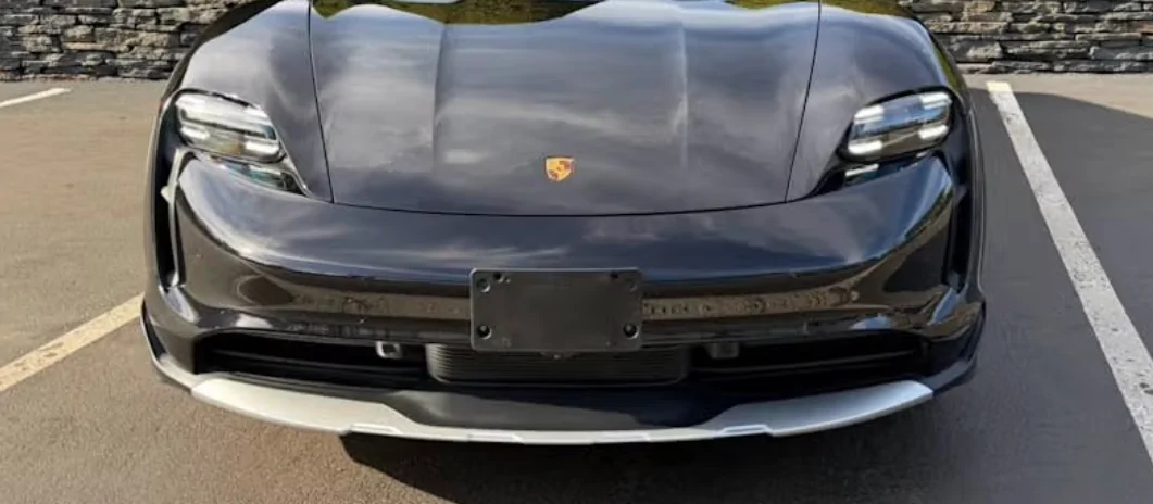

The last question I have is about the colored accent (Mine is silver, but some are Vesuvious Grey and some are Black). Is this part interchangable between off-road package and non-offroad package? It looks identicle to me and the parts catalogue is confuing. Seems two parts, but the main difference I can figure out is Adaptive Cruise or no Adaptive.
Also, how easy is it to remove just that piece? Does it require removal of the bumper? Pics below for reference (Silver Piece is in question):
