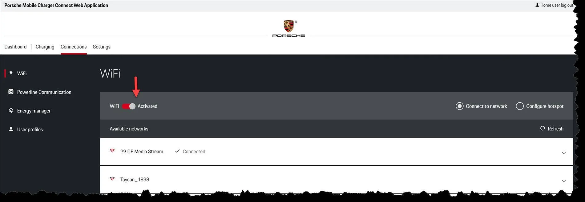

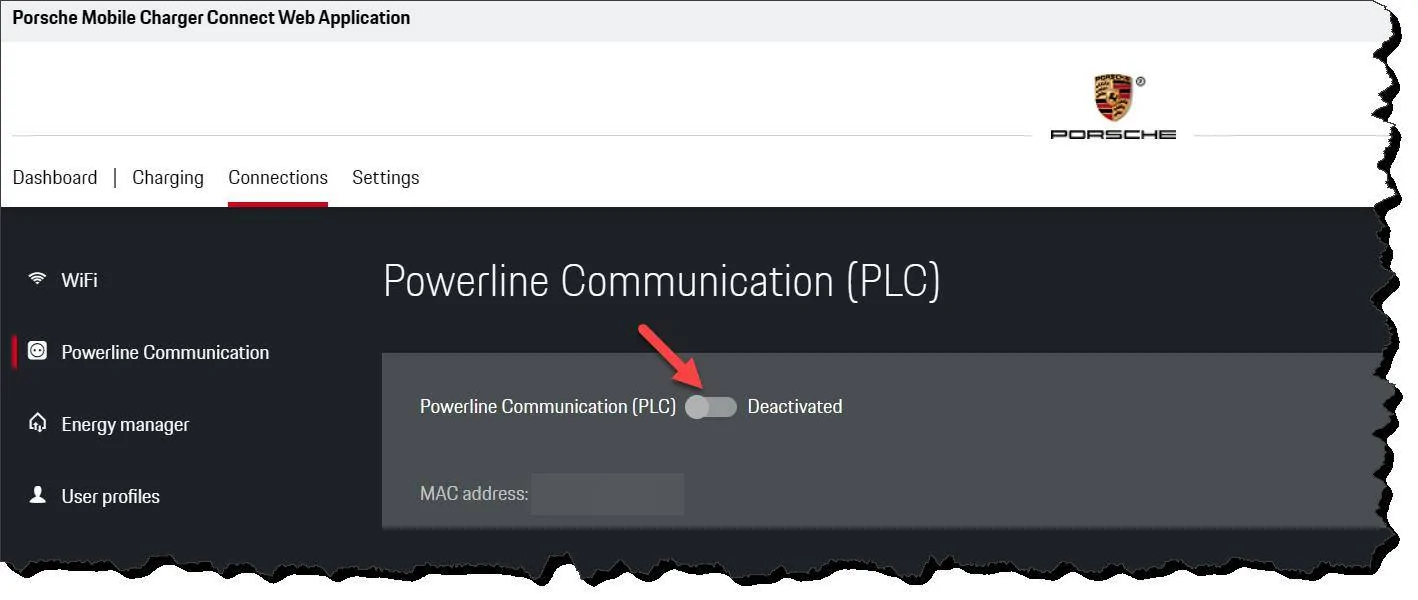

I don't use PLC - can be problematic and historically can lead to unintended 12v battery drain - DISABLE PLC. Note that the PLC aspect of concern is the PLC connection from the PMCC to the car (not PLC to your router / PMCC).
Use WiFi (or PMCC hotspot) but in reality you rarely need to connect to the PMCC once it has been setup (and besides all setup can be performed via the touch panel). PMCC will need to be registered with your Porsche ID and logically therefore will need a clear path to the internet for this step and subsequent data uploads (and updates).

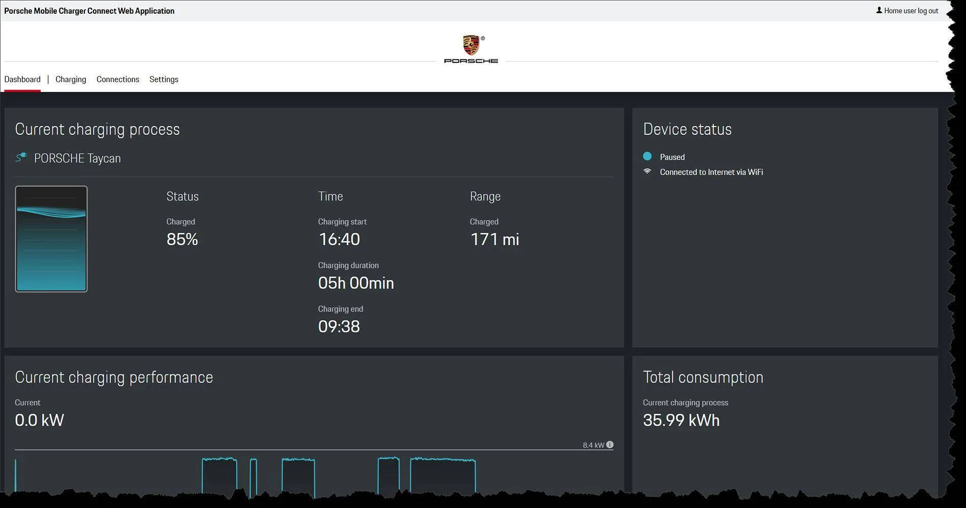

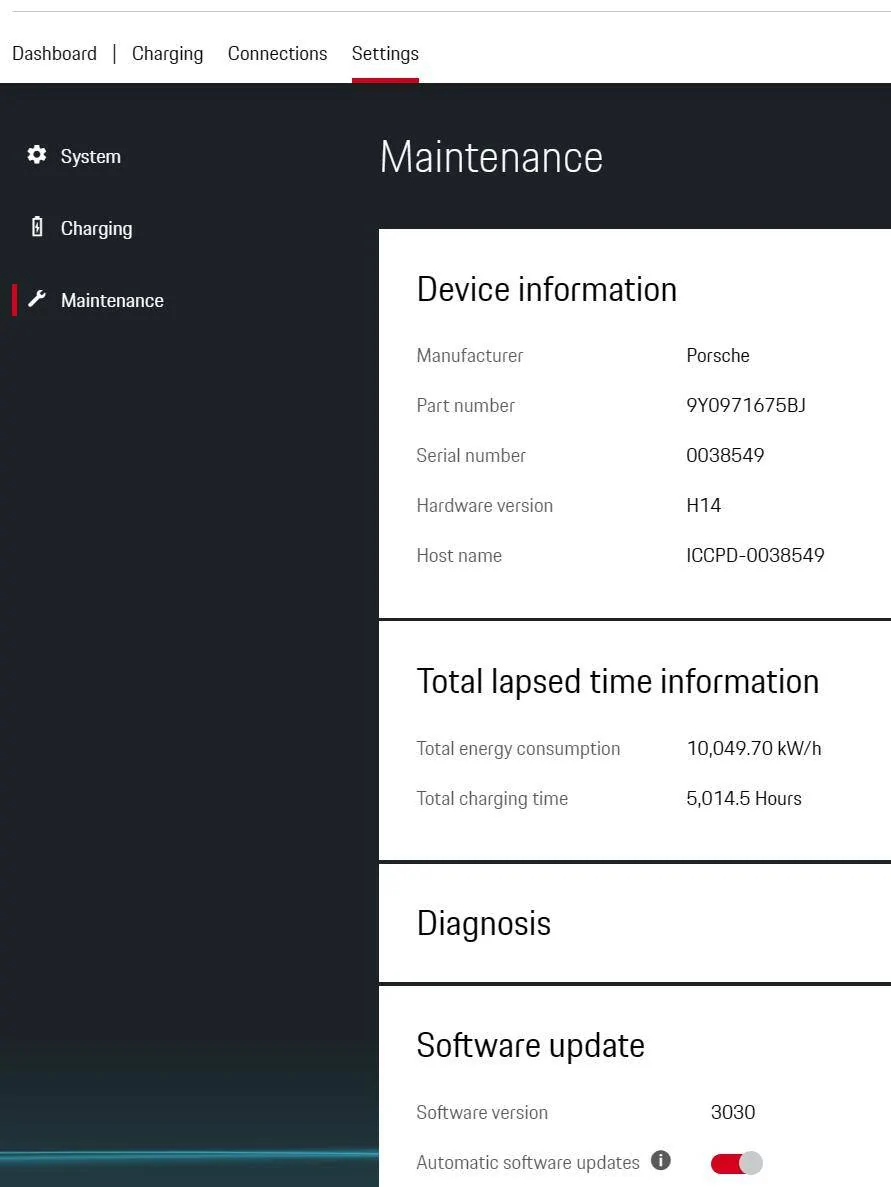

These are my settings:

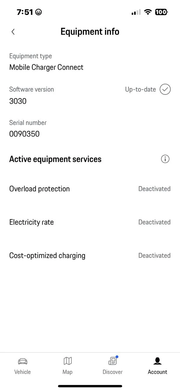

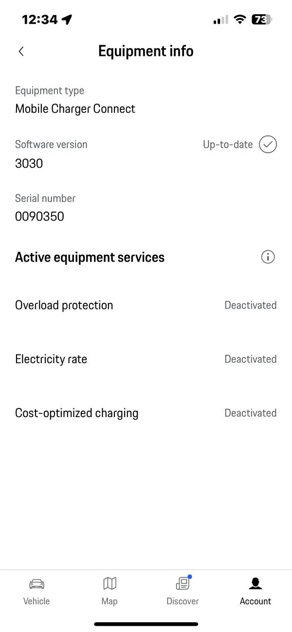

we are looking good here and its down too your expert help -last piece of puzzle and apologies if I have asked this question before but in layman's terms can you explain how to switch on my -Active equipment services ? all showing deactivated !
apologise for giving you these headaches but if it helps you are curing mine !
vbr
Ron
No problem and is what the forum is for.
Not clear on your question perhaps a photo would help.

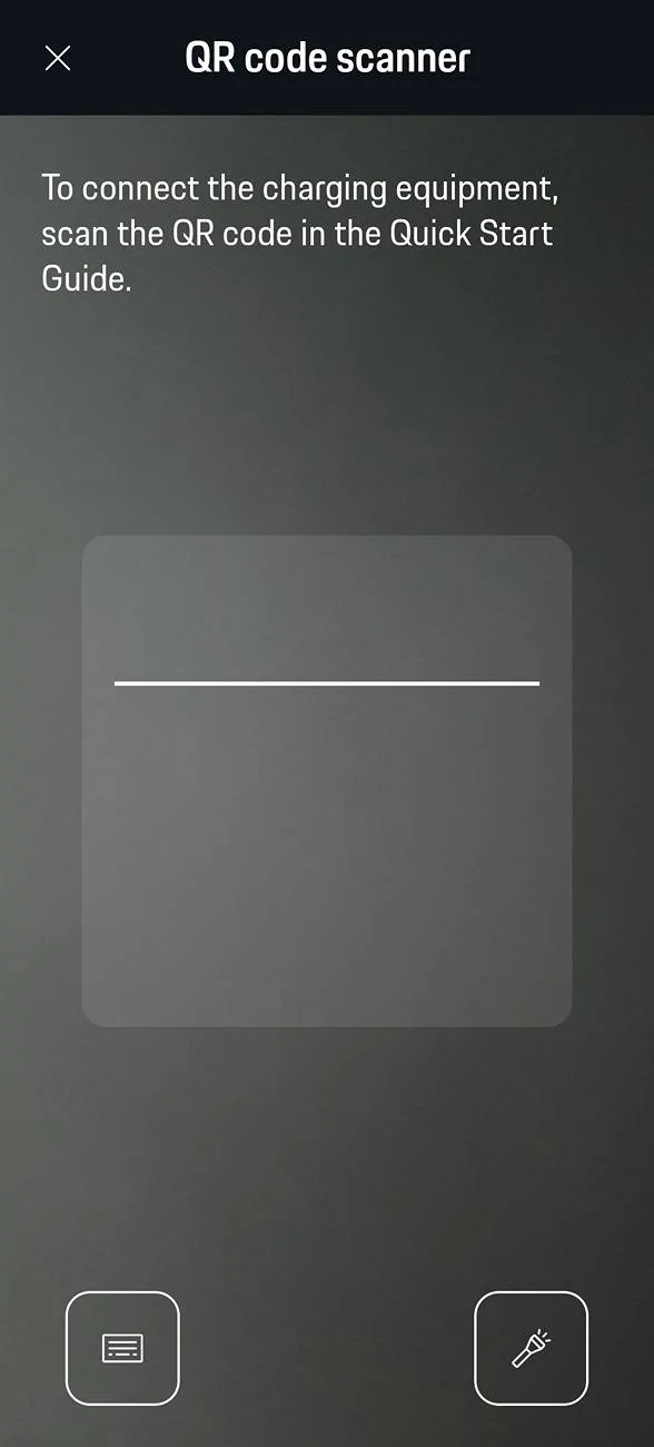

It may relate to the Porsche Charging Service which requires a valid subscription. If you have one then try registering your PMCC which should happen automatically when you enter your Porsche ID and have an internet connection during setup.
This can also be performed via My Porsche App: hit "+" to add

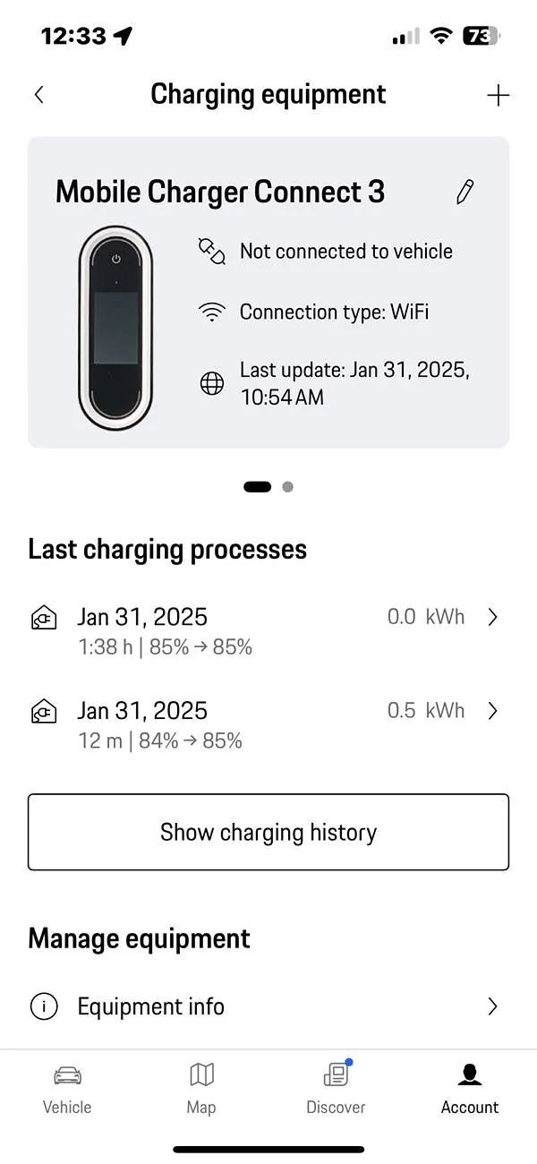

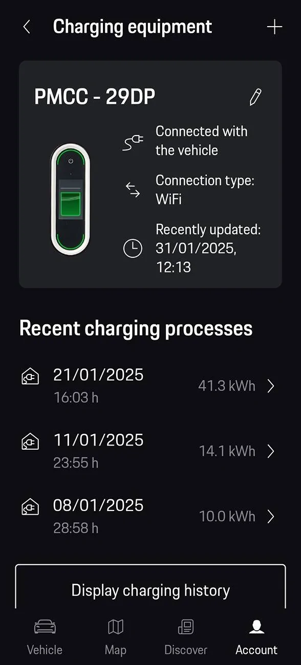

I Note your screenshot showing PMCC details - mine isn't ?

Coolio.

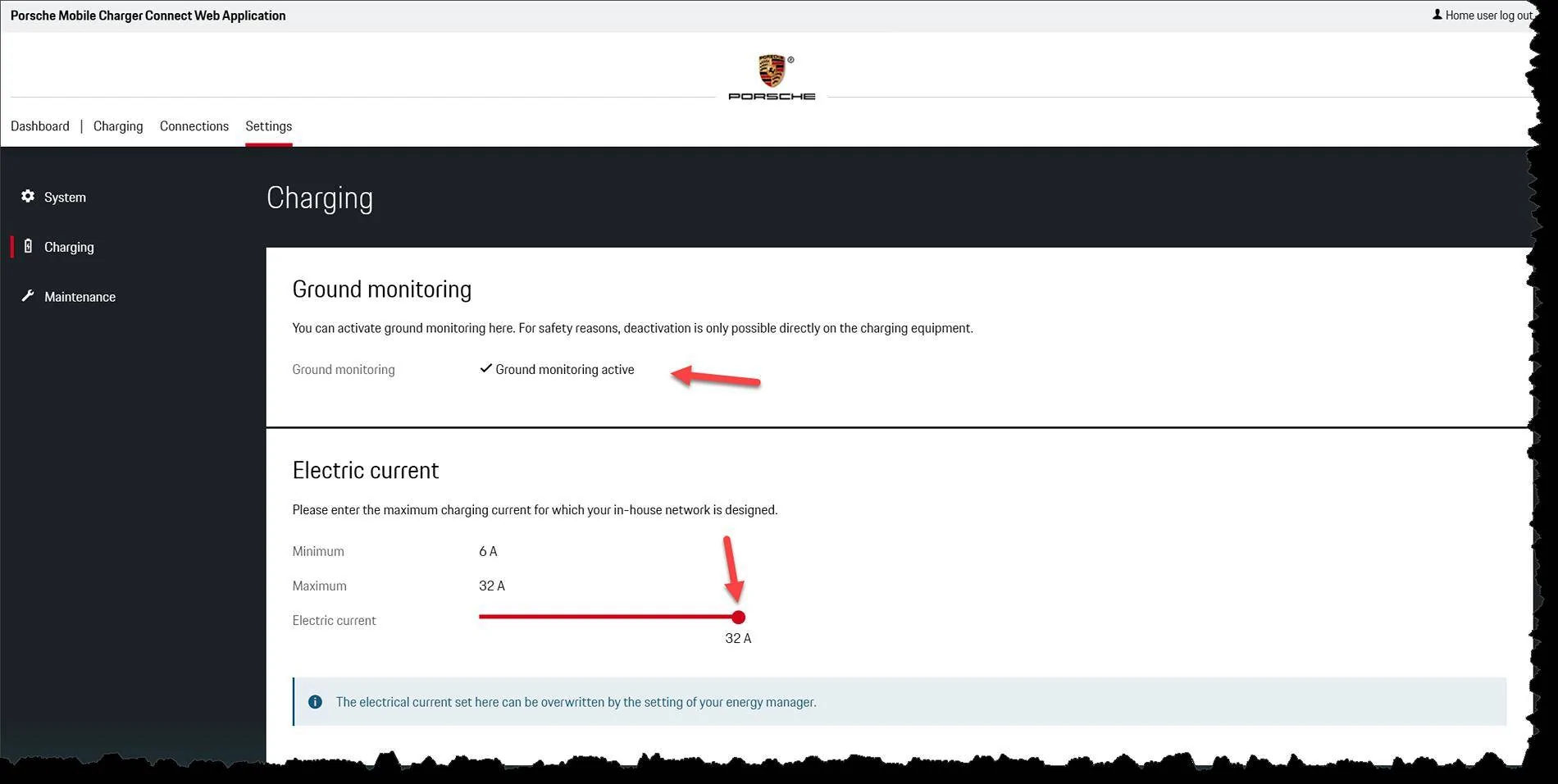

So unless you have a HEM (Home Energy Manager) then the only relevant service is overload protection.
Use the web interface or PMCC touch panel to enable as per my earlier screenshot.
You can also rename your PMCC and give it a more friendly one.
