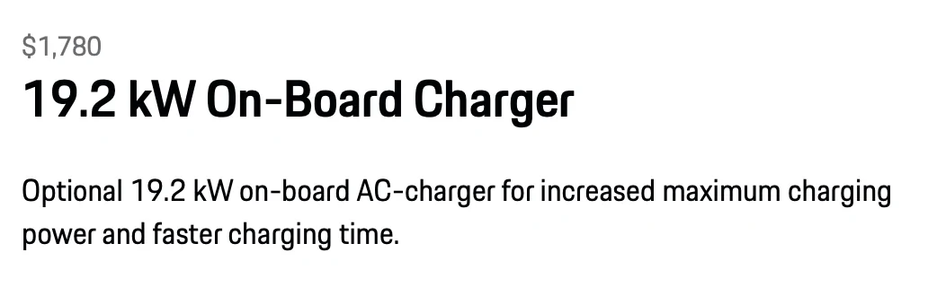

just checked North American configurator - no listed 19.2 kW option for Taycan or Macan…
it _IS_ listed as an option for the Cayenne EV…in North America
Porsche Taycan Retrofit 22KW charger Screenshot 2026-03-03 at 3.28.04 AM
