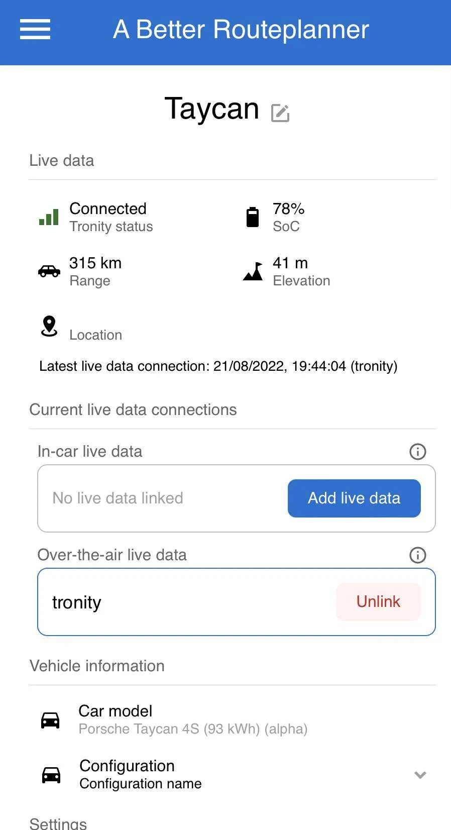

In my experience ABRP is very conservative. On a 1000 km trip it wanted me to charge 5 times and pcm 3 times. Standard setting in ABRP is 27 kw/100 km at 110 km/h. Even with my skibox I am around 24 Kw/100 km.
I use ABRP to plan the route and check where the chargers are. For me it is more accurate to plan with pcm in the car.
I get around this by subscribing to Tronity and feeding actual consumption figures into ABRP. I do believe this only works for European Taycan's.
Porsche Taycan Settings for Road Trips (other than default Range Mode)? Screenshot 2022-08-21 at 19.44.40
